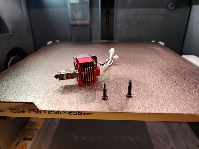

Haldis came out with a clone of an unreleased hoted lol. Great features fully assembled with a 60w heater. Just add a fan and ready to go. I’ll be running it hard and a y issues I’ll put them up.

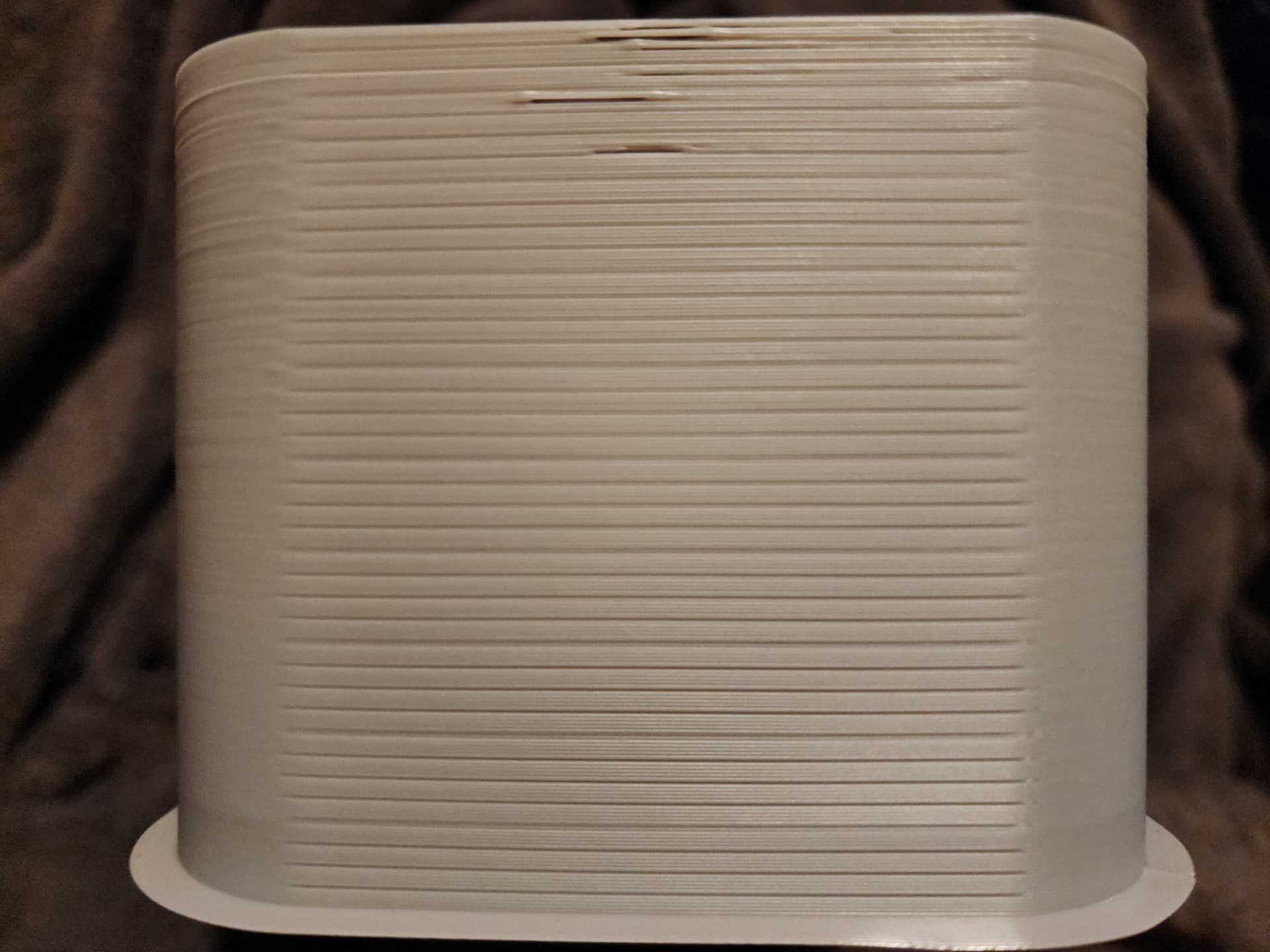

Confirmed flow rate with a .4mm cht using Elegoo PLA. Standard max volumetric flow rate test.
45.89mm³/s

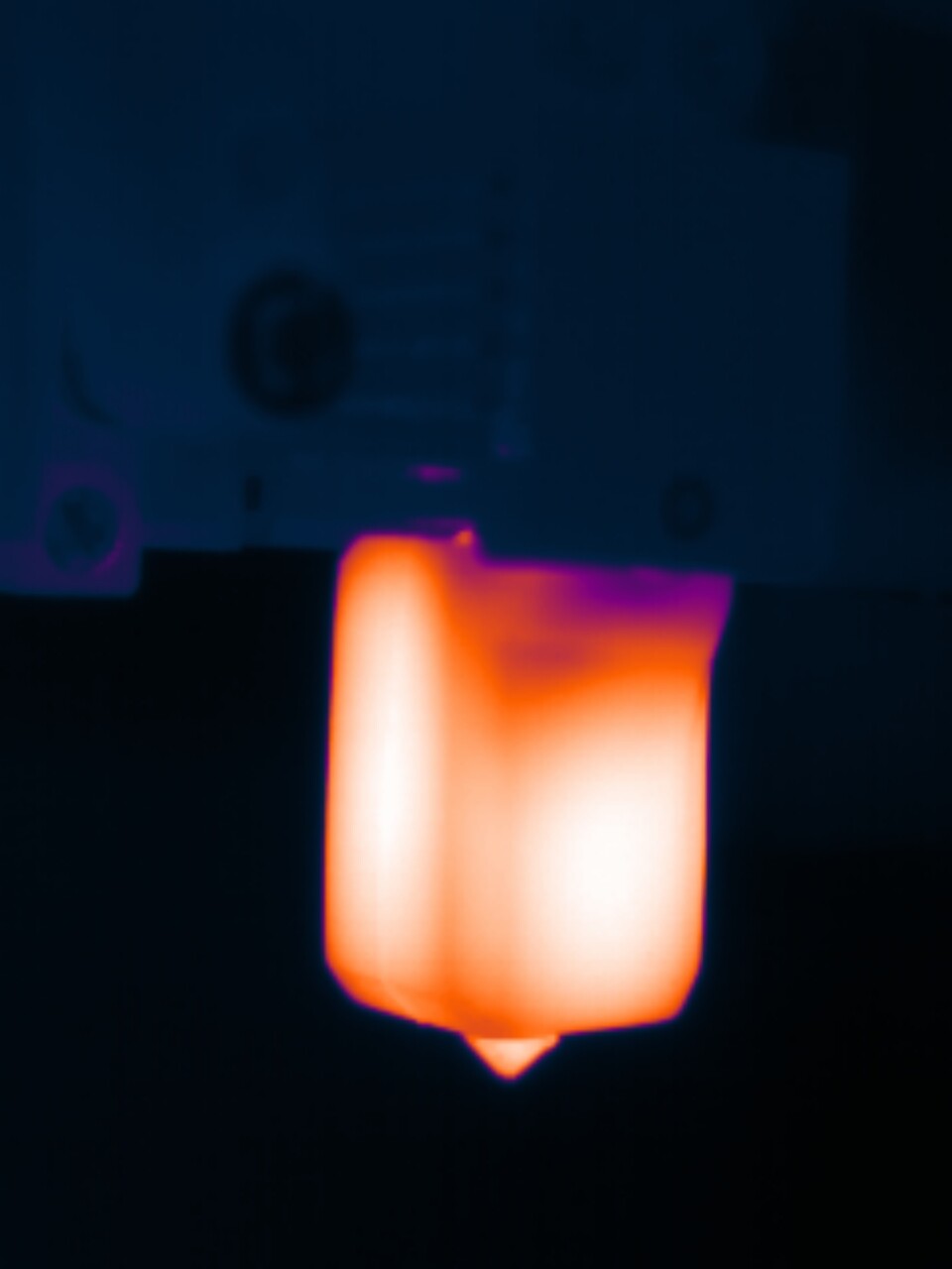

People struggling with heatcreap. Thermals on this are great I’ll get some thermal images and some measurements this weekend. But it’s a solid upgrade over everything else.
Imo the heater is not the selling point here. The better hotend is. Nozzle changes are truly one hand not and you don’t have to worry about bending the thin screws like on the V2 or twisting the heater and heat break like on the V1. It’s well made and the thermals are much better. A year later we finally have a proper hotend. But it uses the non standard nozzle what sucks and modding this for a V6 can be done but it’s harder then on the V1. Now I have been told we got some tungsten carbide nozzles coming out as well as a polycrystallin that uses this modified V6.

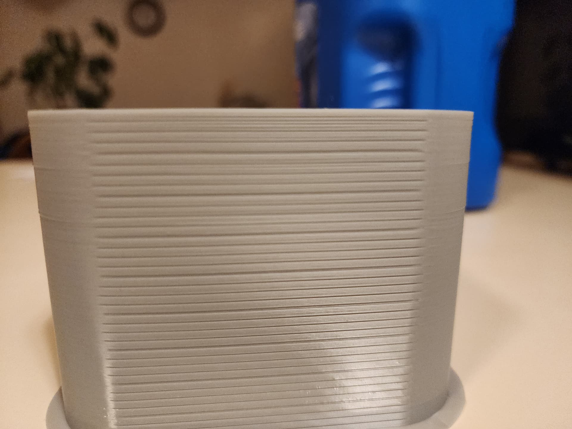

So I ran some test. And with a .4 cht is this hotend fast?
Yes. Yes it is. Running some cheap elego pla I have hot 41mm³/s. I’ll run a few more see what it tops out at but with a cht it looks like this is the king on the K and p series.
Don’t mind the shifts that’s from me not tightening the belts.
Update. Looks like the max is around 45.89mm³/s.
