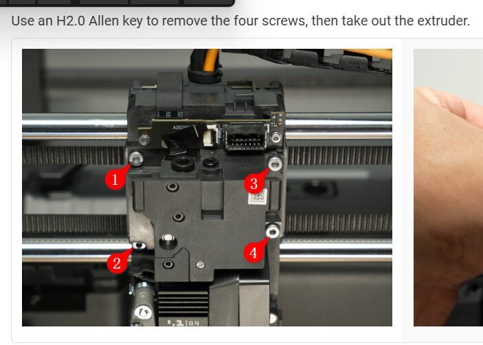

I cannot seem to get the extruder assembly out. I’ve removed the 2 screws, but the thing is stuck in place. I don’t want to force it out. Anyone have any tips?

I’ve read the wiki. I can recognize the extruder, it just won’t come out. I can see filament stuck running between it and the nozzle. I’m going to try removing the hot end and pull out the filament
I believe I’ve figured it out. The troubleshooting “howto” doesn’t mention the 4 screws actually holding the extuder in place.
Apparently not
