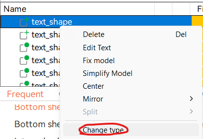

I have a part that needs colored numbers flush to its geometry, and when I paint the numbers they apear to be all the correct color, but when I slice the numbers I get random bands of yellow across the numbers. the numbers were all just slightly extruded in the stl

Change the type of the text from a part to a modifier. Solves most of my text problems.
