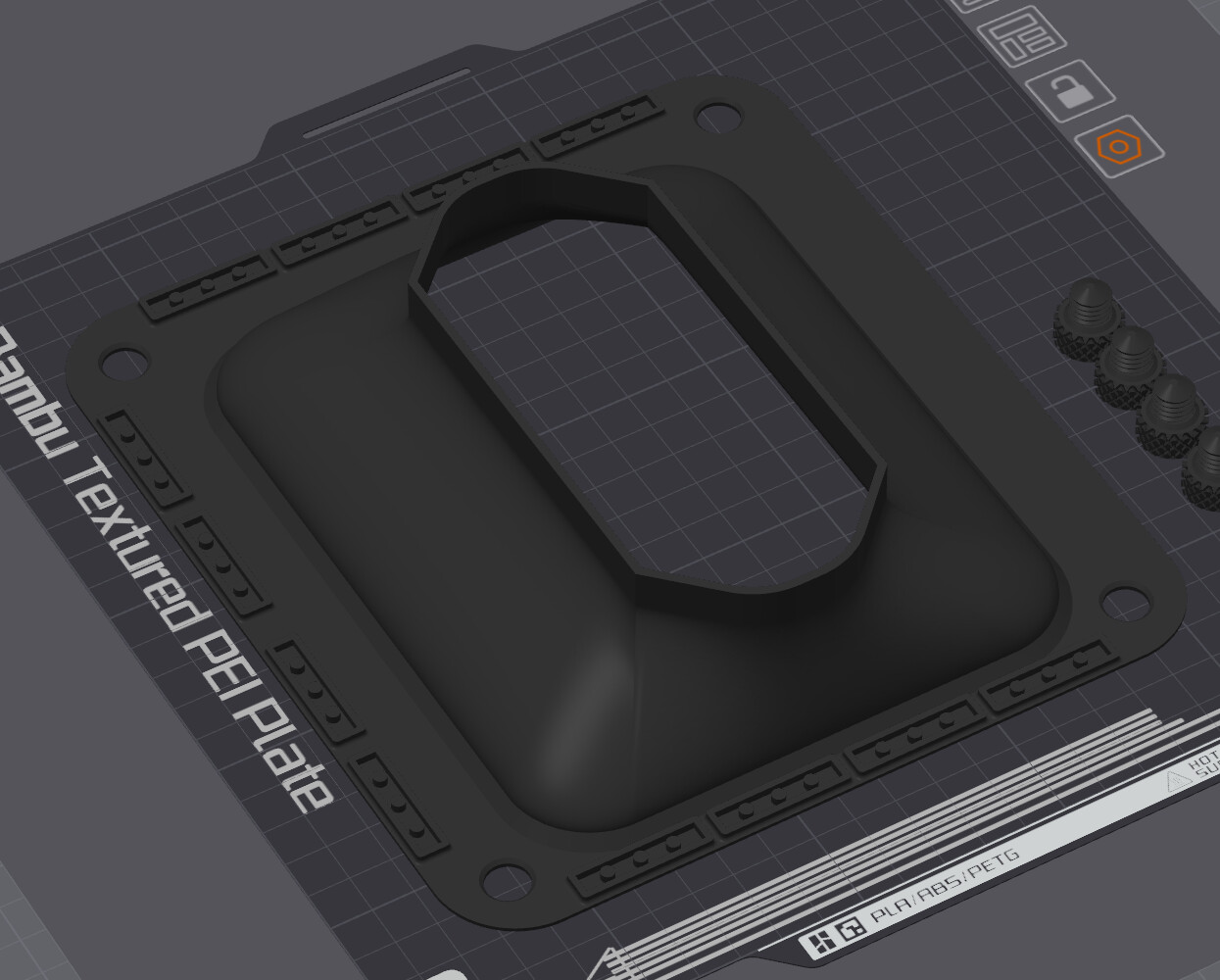

Hi, I am having problems with the new Bambu Labs PETG HF. I get weird holes on some places of a big thread I’m trying to print - please check the pictures. I still have some regular Bambu Labs PETG Basic left, which doesn’t cause this problem.
Does anyone have a recommendation on how to fix this for PETG HF?

I think we’re experiencing the exact same issue. This is my post
Does your holes appear right after printing an overhang wall? from your model it seems so.

I just checked the order in which the lines are printed and it turned out that the area that had holes in the surface were printed directly after the thread. It really seems like i’ve encountered the same effect like you did.
Now I checked the printing speed. Doing the overhang, the print head slows down to 10 mm/s and then accelerates very quickly to 200 mm/s. Flow during overhang is down to 0,78 mm3/s and then increases very quickly to about 18 mm3/s (hard to read that color scale). It seems like in reality the flow can’t increase quickly enough to handle such fast acceleration. This also explains why drastic flow increase (what I did) or drastic speed decrease (what you did) help.
The following pic shows the flow rate. The perspective is from below, looking through the build plate.
It seems like I have an awful lot of tweaking to do. 1.) increase flow rate to make holes after overhangs go away. 2.) decrease top layer flow rate to keep a nice surface. 3.) adjust x-y-hole and x-y-contour compensation to keep dimensional accuracy. This will still leave me with lots of issues because of the flow rate being to high in general.
This is really bad. It shouldn’t be that way.
I don’t have those problems with PETG Basic and I find it terrible that Bambu Labs got rid of PETG Basic only to replace it with holey-mc-hole-hole PETG HF. Time to source my PETG from a different brand i guess.
Try this, change the smooth coefficient to lowest setting (1). This seems to print better for me, as it smooths out the speed change. And it does not slow down the print time very much.

Wow, great stuff guys. I’ve just gone through the same with an organic type part with many overhang walls in PETG-HF. Looking at it in ‘speed’ mode evidenced that the jockeying between overhang levels was changing the speed abruptly and leaving a very poor surface. Since the overhangs spanned the gamut from 10% to 100%+ overhang wall the only solution I found was to set them all to the lowest value, increased print time by about 10%.
The part (manifold):
