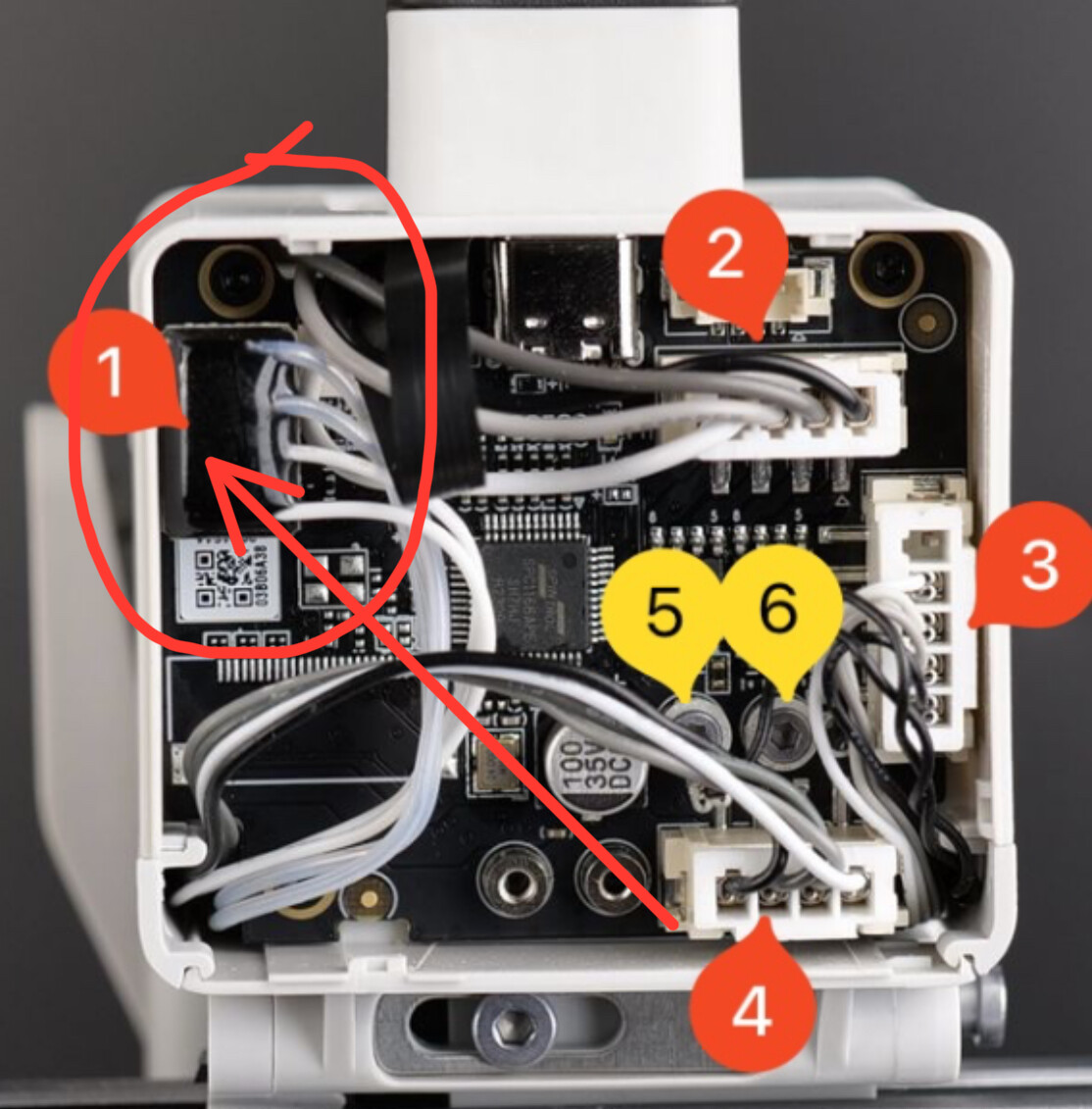

My issue was not that simple. I am getting toolhead homing freezes and it never prints. I looked and one of the plug on the toolhead read was loose
I seated it in correctly then in worked! Only to fail again after 1 print. It shows my nozzle at 255 degrees even on a cold fresh start.

Same! I put in a ticket into bambu labs with only a default response for days , then after no response, I searched up the problem online and yee haa, we just saved ourselves from distinction within the 3d community once again without our dictator of a company :slight_smile: jokes people … So I looked underneath the hood and found the usb-c and overall cable port was detached and justing hanging like a bag of bananas. I plugged back in the unit and boom! The system was responding like you never seen. If you’re system crashes like #zaxisfailed on #a1 and #support doesn’t respond, we have got to rely on each other even after for paying top dollar :slight_smile: Enjoy!

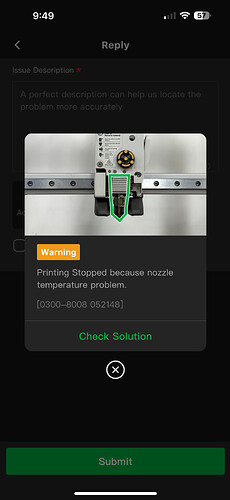

God above this printer is giving me trouble. I’ve spent the last three hours seating and reseating the usb c cable, checking the plate is alligned, checking theres no screws out of place, trying the earlier mentioned holding the z axis button down and trying that method and nothing has fixed it.

Error: Printing Stopped because homing Z axis failed.
(0300-4000-172225)
