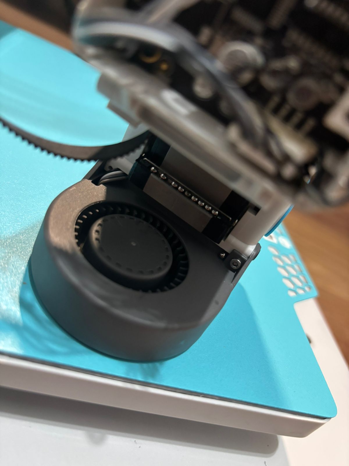

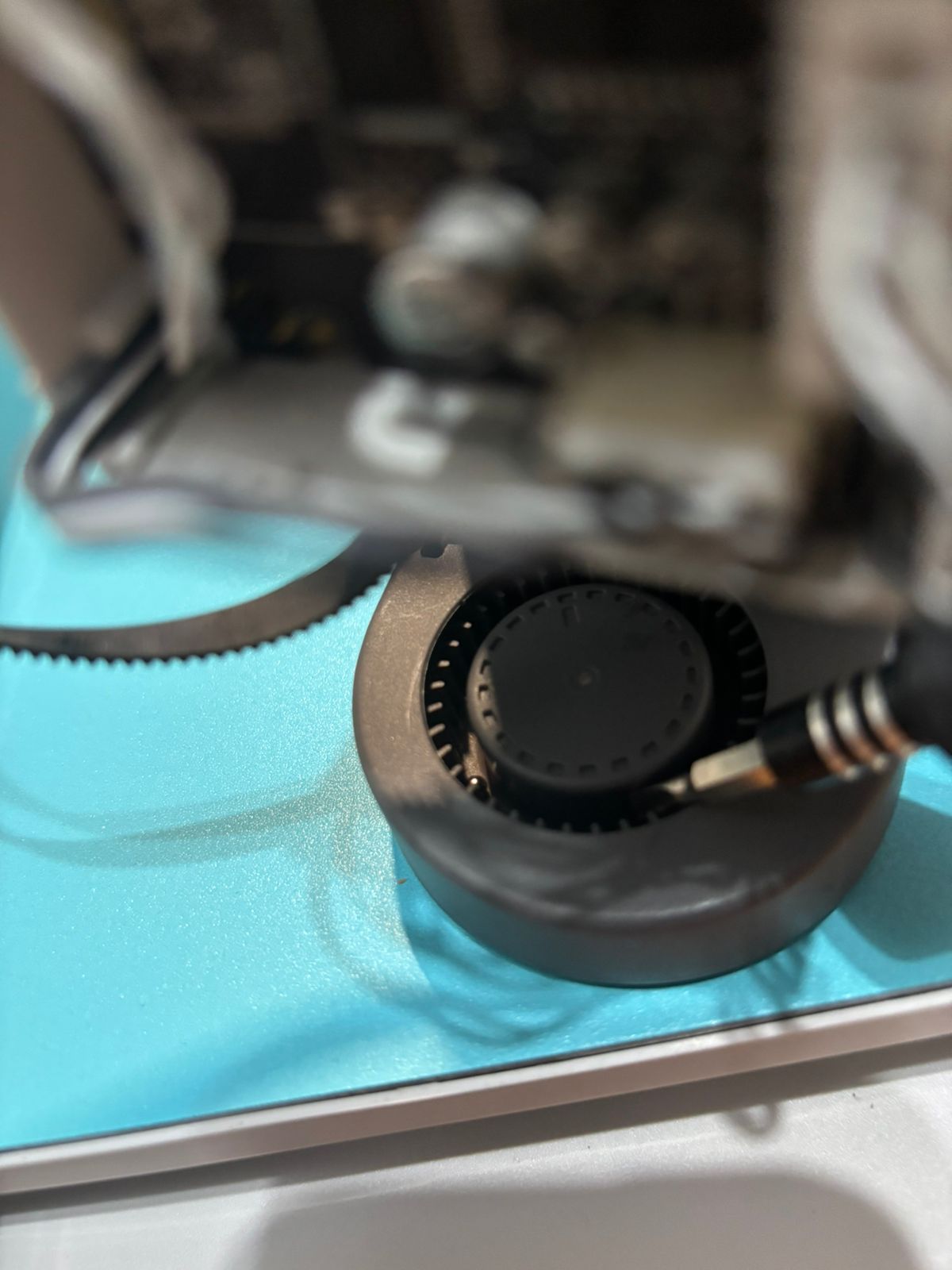

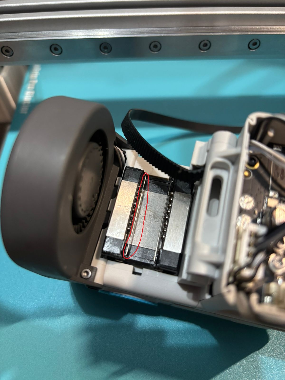

Supplier sent me the TH board, USB-C Cable and the extrusion kit. I replaced everything, and nothing worked. I was about to give up and sell the printer.
My printer was making an abnormal noise that started a few months ago (before this Z-axis problem). I didn’t think it was an issue because I thought it could be some loose screws from the fan part.
After not solving my issue, I wondered if this noise had something to do with my Z axis failing to calibrate.
So I unmounted the part fan (the grey one), and I discovered not one but FOUR bearings standing there. I didn’t know where the ■■■■ they came from, but after removing them from the fan, my problem was magically solved.
Then I started to investigate where these bearings came from, and I found out that the connection between the toolhead and the X axis is full of them. For some reason, they were dropping from the toolhead into the part fan.
I think these loose bearings were making my whole machine vibrate violently on the calibration step, because I started to notice some loose screws that I hadn’t touched before.
So, after telling Bambu my story, they identified that my X-Axis is the faulty component, causing my bearings to drop into the fan part.
My machine came back to life, but someday from now those bearings will come back into the part fan.
I really hope this will help someone in the future. I haven’t seen anyone with a problem like mine before.
