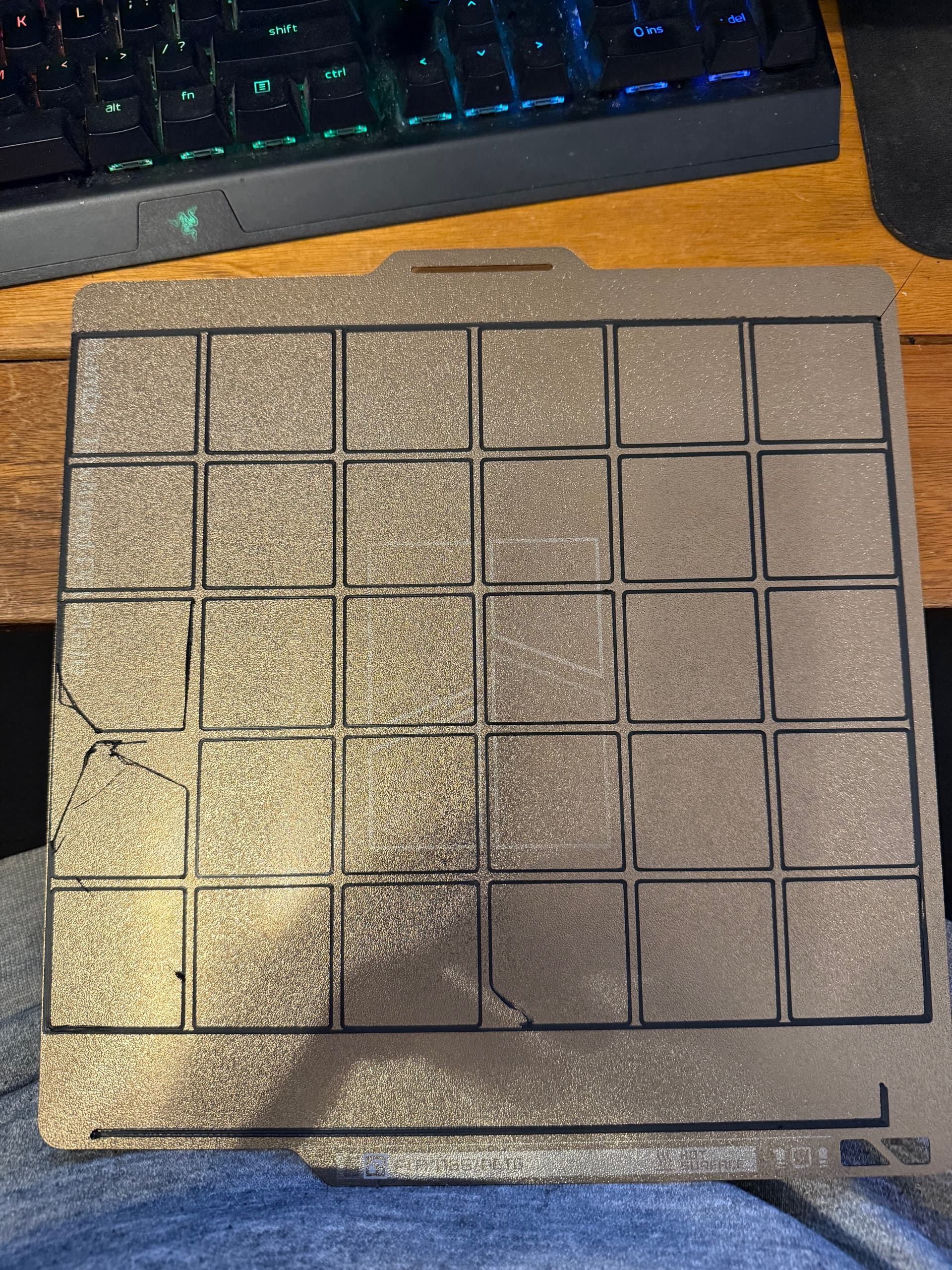

HotEnd not centered on buildplate
Similar problem to Item not on center buildplate
Only I use Bambu Studio. It came this way from the factory. The buildplate is aligned properly. Encountered this problem when printing AMS riser drawers, and now when printing gridfinity base. Are there any settings in Bambu Studio I can tweak to center? Any other suggestions?
Two things come to mind. If you haven’t done so try a full calibration or open a support ticket.
Check to see if your nozzle is bent. This is the most common cause of prints offsetting on the build plate.
Thank you both for your responses. The machine has been fully calibrated multiple times. Checked the nozzle… not bent (brand new machine). However,
I changed slicer to Orca Slicer and it centers over the buildplate perfectly. For some reason, Bambu Studio isn’t calibrated properly with their own hardware! I suspect a software issue?
