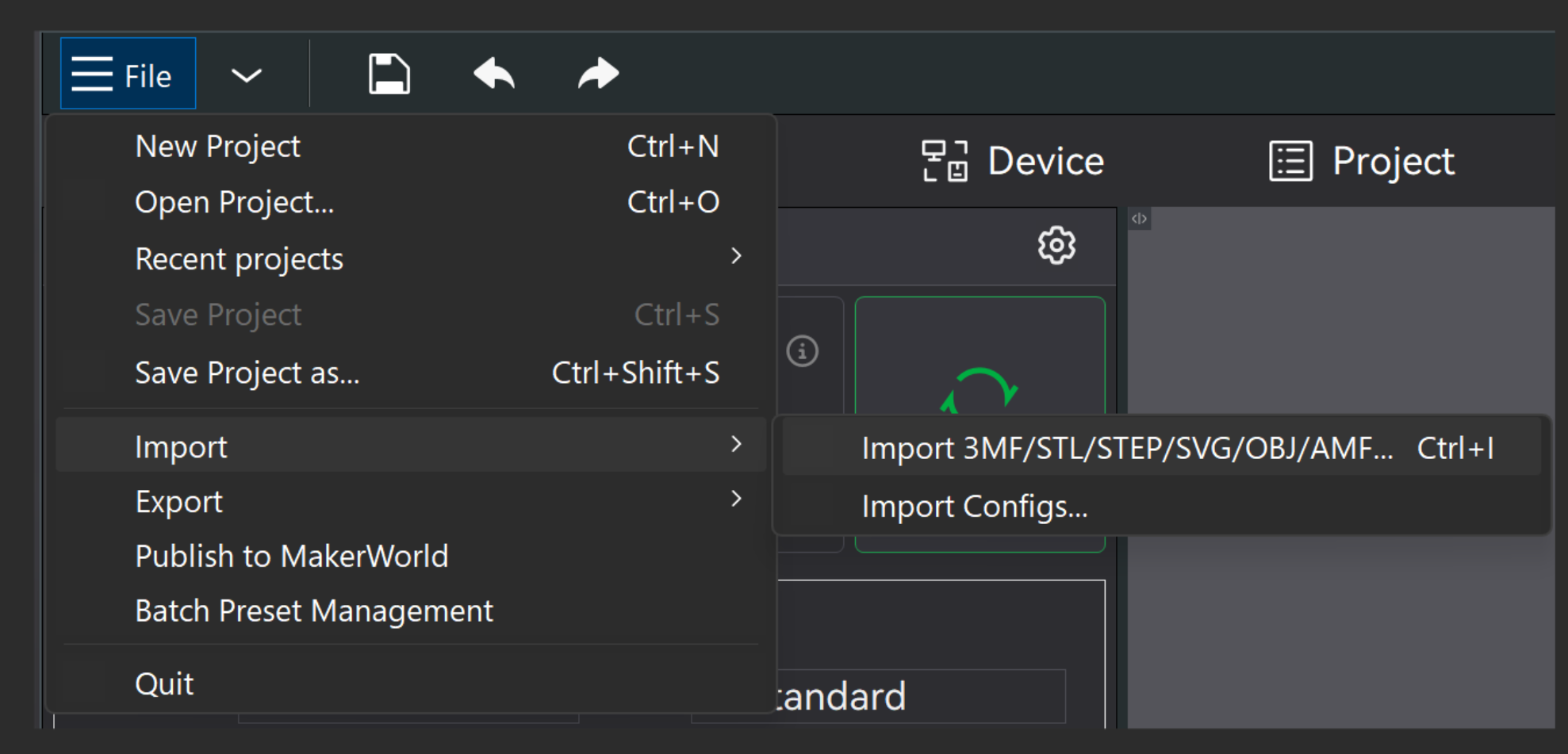

Instead of clicking “Open in Bambu Studio,” open the file this way: Import
Then you will be asked whether you want to apply the settings or just import the 3D object.

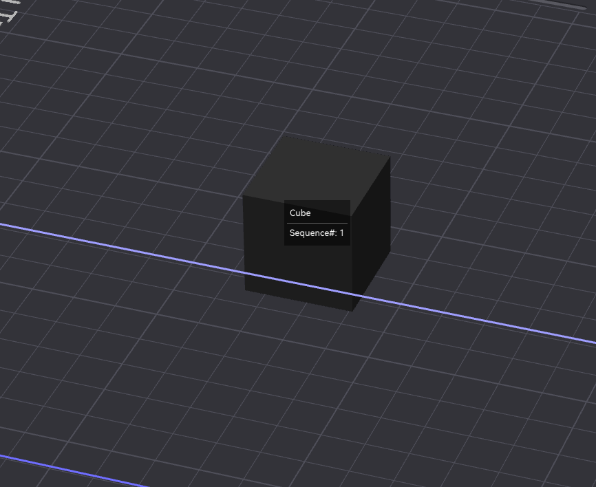

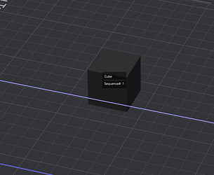

Before importing a 3mf file, add a primitive like a cube

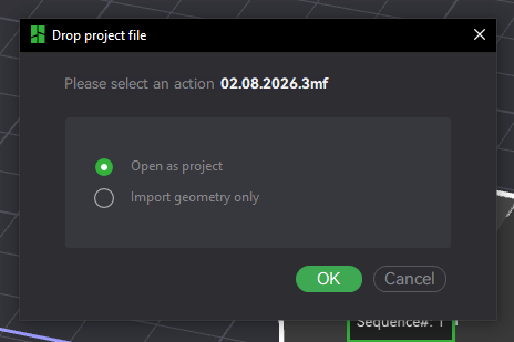

then drag in the 3mf and you’ll be asked if you want to open it as a project (overwrite your settings)
or import the geometry only (your settings stay and you only import the actual model)
