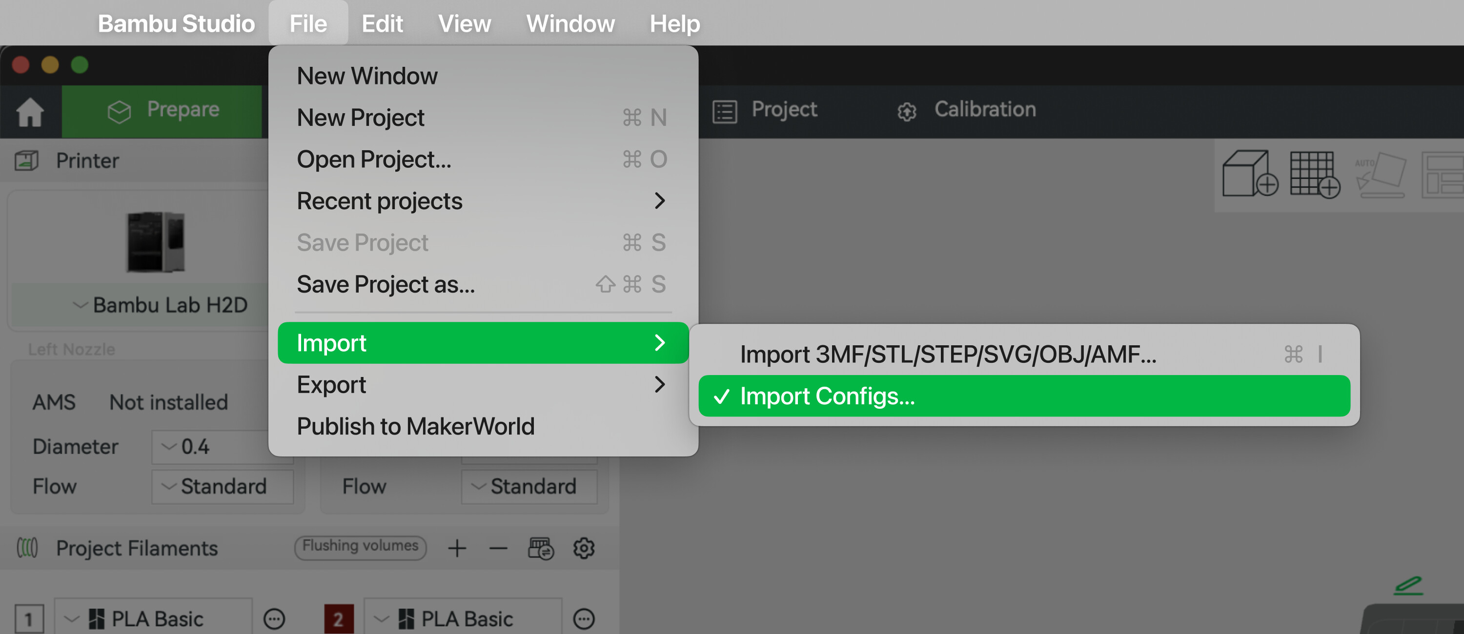

Bambu Lab now offers official support for E3D Hotends. Users can download and import the official presets right away (Please upgrade Studio to the latest version available on the official website). For our future plan this year, these officially tuned presets will be directly available in Bambu Studio and Bambu Handy—just like the presets for Bambu Lab’s stock nozzles.
For P1S, please download the configs here.
For P1P, please download the configs here.
For X1 Series, please download the configs here.
PATH: Bambu Studio - File - Import - Import Configs

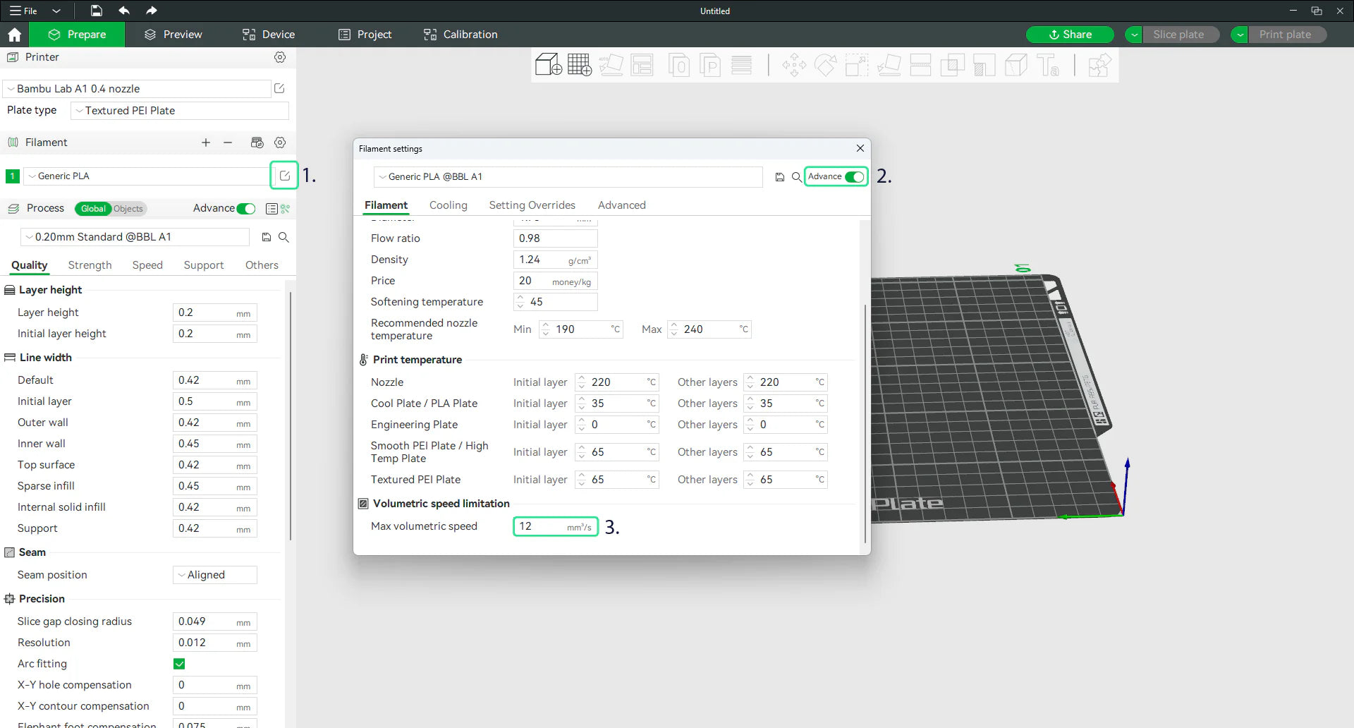

The simplest change to make is simply to increase the volumetric flow rate limit of the filament profiles and let Bambu Studio handle the rest. Bambu Studio will calculate the speed of the perimeter and infill moves in order to never print above this set limit so by increasing it to an E3D suggested max limit you will see a decrease in overall print time without any extra printer setting changes.
  1. Select the closest generic filament profile, then select edit.
  2. Enable advanced mode.
  3. Overwrite the max volumetric speed value based on our recommended max values.

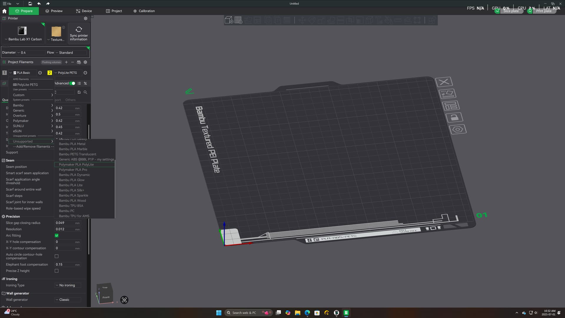

hi, i downloaded the profiles but i cant seem to be able to pick them. First time i did it they showed in unsupported profiles so i thoiught i had to re open the app. after reopening it, i re imported the configs but i cant see them anywhere available for selection.
You may have already tried this, but just so you know, I believe the import file is saved as a new printer. Have you checked there? Click on your printer, and it will pop up as a nozzle name and then your printer model.

You have to take the Xobsidian printer profile that comes with it and you will be able to pick filament profiles. Still I don’t see any difference in speed when comparing nozzles set at slicer level. Benchy prints in 35 min on both side
So basically did the slicing test with PLA matte on a Benchy. Regular nozzle setting prints in 33min, the Xobsidian setting print in 35min. This is crazy ********, how is this even possible with high max flow (21 to 29)? Should I guess the printer profile speed limits were not updated to not limit the max vol being really used?
This is the answer to the settings being greyed out :slight_smile:
