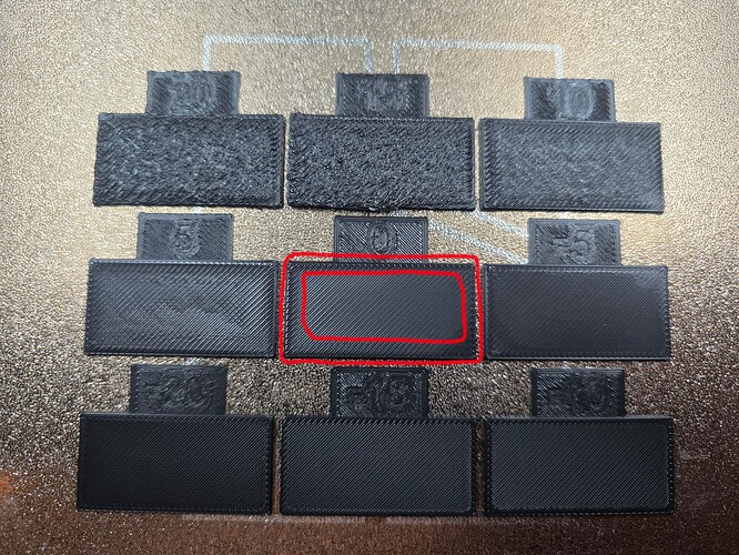

right now i am redoing a flow calibration test, and by the sound i hear and what i see, two of them are going to be horrible
if the position is correct on the image i say 20 and 15 are not that good

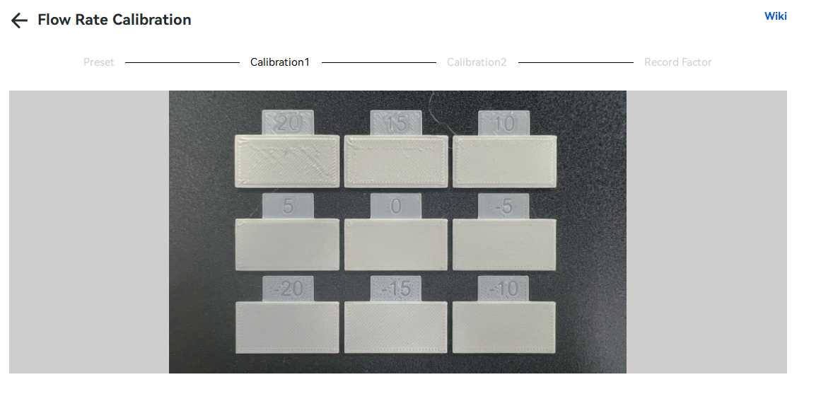

question they say to find the test that is the smoothest, i count also the side of the print correct ? because i can feel some bump for example on 0, but not on -15 or -20, what am i supposed to get ? because feel is one thing but i would appreciate an example in studio

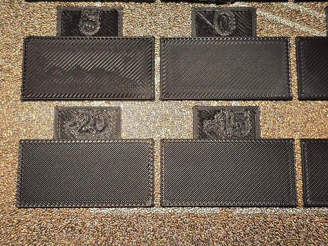

so here is what i got, we all agree that top line is bad, no need to feel, then you move to the other 2, now 0 seem smooth but the extremity are bad you can feel the bump on the wall of the print
also light help to see that 5 has some issue and same with -5, because 0 is 0, so its transition, then i move to bottom row
nd bottom well - 20 and -15 are smooth on the side, and even if line are visible compare to 0 its smooth too
you can see the edge of -15 are smooth compare to 0 even if its out of focus
you can see on this pic that -20 and -15 are close, to the touch they are the same

Bambu’s wiki says to ignore the perimeter on these calibration prints. From your image of the white print it looks like 5, 0, or -5 are going to be your best. I drag my fingernail across the prints feeling for the least “bumps” in various directions. You want the print with the least peaks (over-extrusion) and valleys (under-extrusion) I find this better than using the skin of my fingertip.
Give this model a try to compare various first layer flow values.

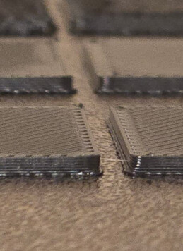

I did that, and this is what my first layer from the bottom look like
I am trying to understand what are those black line i am getting too, and where you see crevass those seem to be blob i got that i could ear being touch by the nozzle like it was scrapping stuff.
