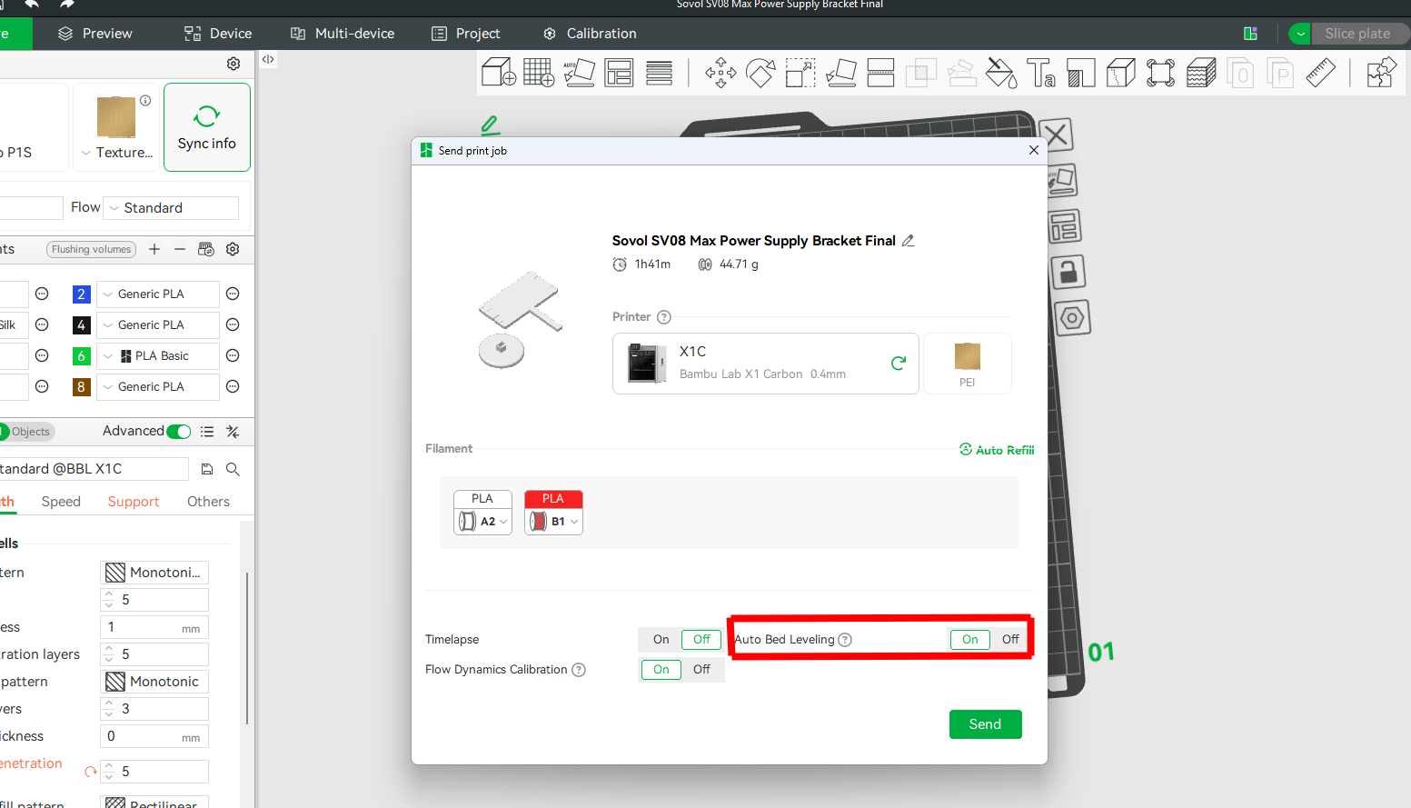

How do we disable the bed levelling in Bambu Labs ? It is happening on every print. It is a waste of time. As stated, it causes failures because the oozing of the filament and the sensitivity of the strain sensor on the tip. Also, the ‘XY mech vibration’ calibration is a waste of time and should be performed once every year, not 12 times per day. We are printing more than a dozen prints per day, with 0.6 nozzle. We can level the bed once per day.
The option to turn it off/on is in the final pop-up before you send the job to the printer:
