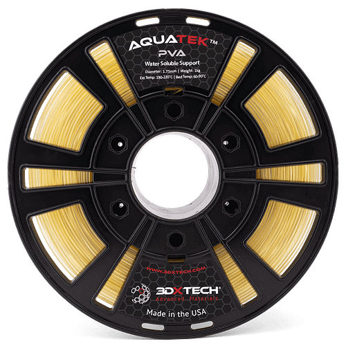

Not sure if it’s a different material, but for compare/contrast these guys are claiming that their water dissolvable support filament can support:
  • PLA, ABS, ASA, PETG, Nylons, and flexible filaments like TPC, TPU, and COPE.
Do you think it’s the same, or something different?
Ouch, price wise… 90 to 170 USD per 500g spool… and it’s a 2,85 mm diameter filament.
