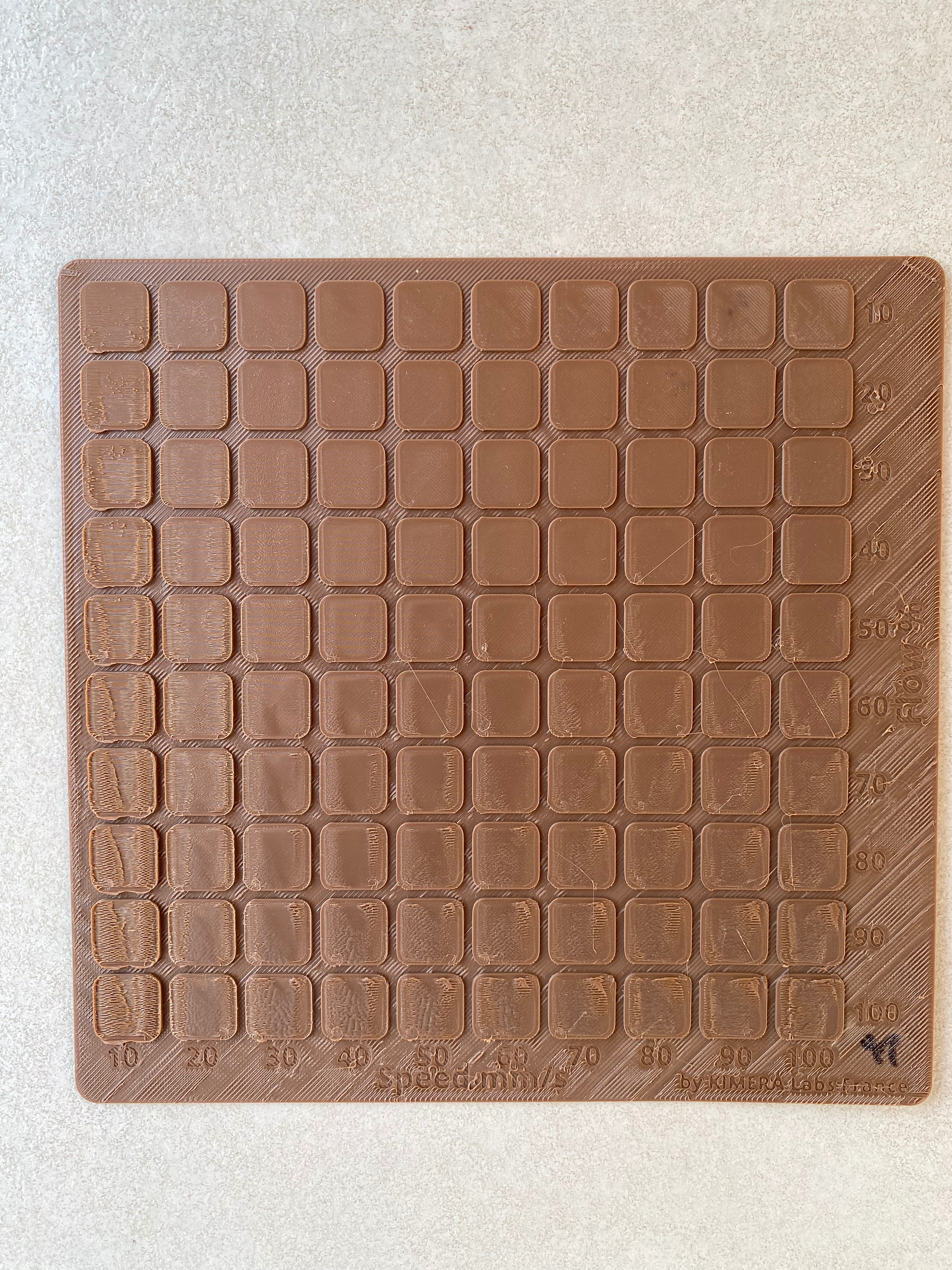

Hi everyone,
I’m really struggling to calibrate the ironing on my Bambu Lab X2D, and I can’t seem to find anything that gives good results.
What surprises me the most is the huge difference in ironing quality compared to my previous Bambu Lab A1. Despite trying every calibration and test I could think of, I can’t get a good surface finish—not even one that’s comparable to what I was getting with the A1.
I’m using:
  • Bambu PLA Basic (dry filament)
  • 0.4 mm nozzle
  • 0.20 mm layer height
The filament has been calibrated, and I’ve tried several different calibration settings and ironing configurations without any convincing results.
Currently my ironing settings are: speed 34, spacing 0.16, flow 13%.
I try to Bump temp up to 225°C — I saw in other posts that the printer might under-report actual nozzle temp, so I wanted to compensate for that. And it work’s well.
I try to calibrate my top layer with this maker world model
I’ve also used several of the well-known ironing calibration models available on MakerWorld, but none of them have led to satisfying results.
Do you have a reliable calibration protocol that you follow? Is there a recommended order for tuning the ironing settings?
Also, could you share the ironing settings you’re currently using (speed, flow, line spacing, pattern, etc.)? I know these values won’t necessarily be directly transferable, but comparing them with the settings I’m currently testing could help point me in the right direction.
If you’ve switched from an A1 to an X2D, did you notice the same difference in ironing quality?
Thanks in advance for your help!

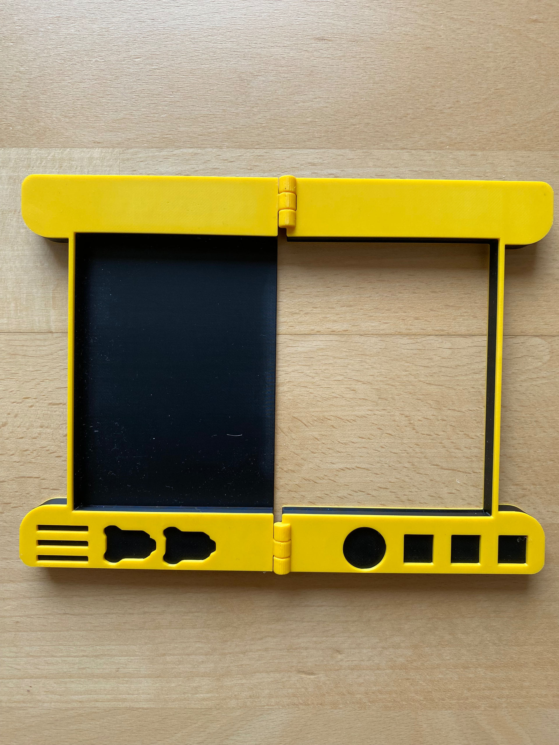

Ironing on my A1 :
Ironing on x2d, best settings currently:
Différents ironing calibration:

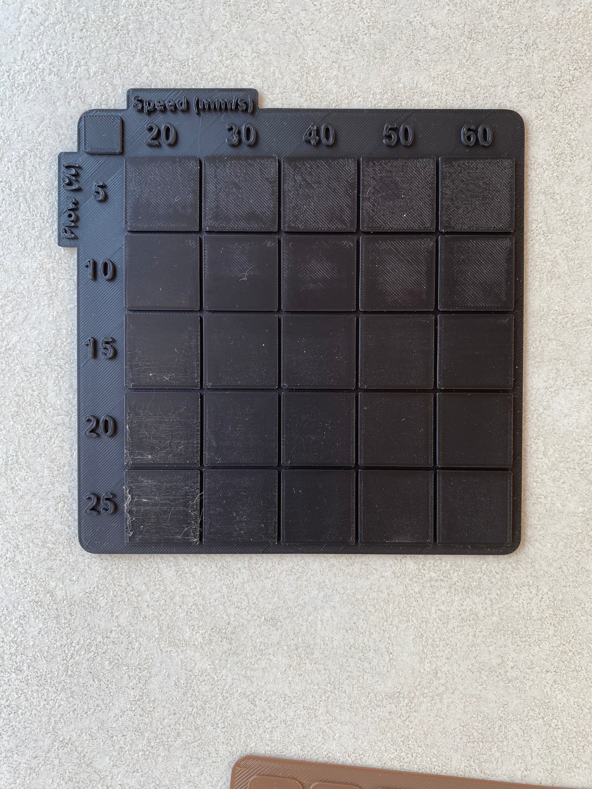

Test done with the MakerWorld model “Ironing Calibration Speed & Flow 15-40mm/s, 10-50%”.
Result : 35mm/s at 30% flow — excellent, reproducible result, regardless of the surface size tested.
The lines are barely visible to the naked eye, and the surface feels “mirror”/smooth to the touch.

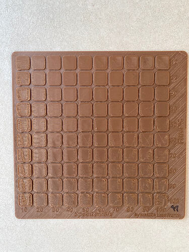

1 Result of the same calibration on my X2D
To calibrate the X2D I used this model: Ultimate IRONING Calibration Test - Free 3D Print Model - MakerWorld
As well as this model: Ironing calibration - Free 3D Print Model - MakerWorld
And here are the results
[image]
[image]
Result: no surface is truly smooth. The areas that look correct in the photo actually show the underlying solid top layer pattern “showing through” the ironing pass — the ironing does not fully cover the existing surface texture, even on the combinations judged best in this test.
2nd test (printed in black filament)
Result: many areas show noticeable under-extrusion.

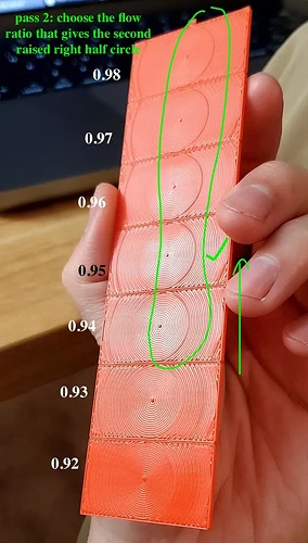

2.2 Flow ratio
Calibrated with the MakerWorld model “Improved Flow Ratio Calibration v3” (jimcorner).
2-pass method:
Rough pass: 7 values tested (1.12 / 1.08 / 1.04 / 1.00 / 0.96 / 0.92 / 0.88), filament flow ratio set to 1.0 during the test, identifying the threshold where the “raised half-circle” artifact appears
Fine pass: 7 values tested around the rough value (multipliers ×1.03 to ×0.97), filament flow ratio set to the rough value found, final value retained = the 2nd raised half-circle identified (from lowest to highest)
Result: 0.97x1.03= 0.9991

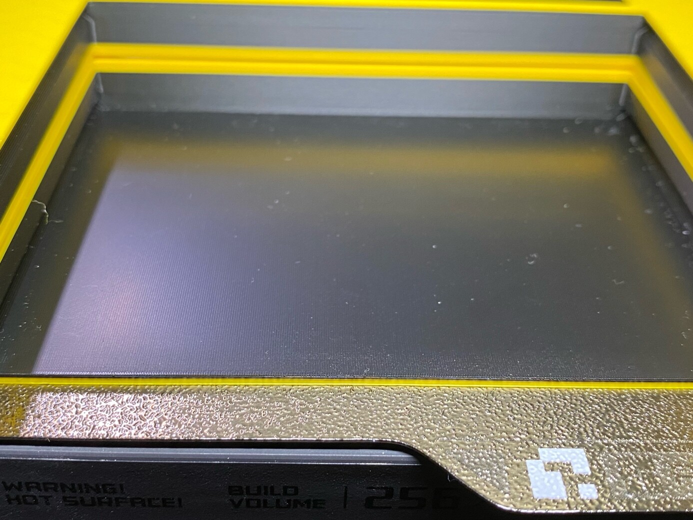

[image]
Result: great look and very smooth to the touch.

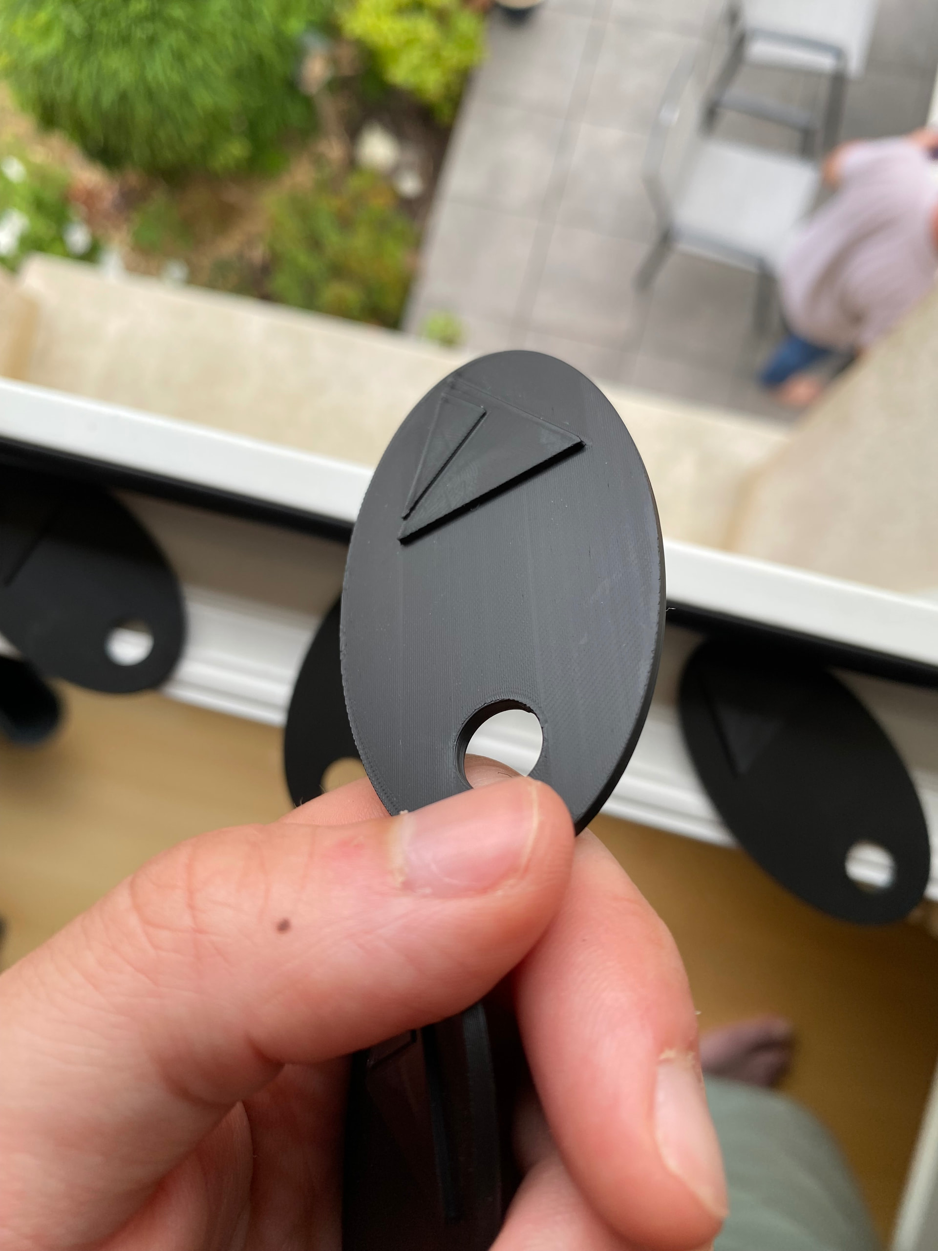

Result: 32 mm/s appeared to be the best (dust is visible here since this part was used extensively across several environments to compare results — “it has lived a life”).
Important point: there are lines, like shadows, that are consistently present in the same locations on the model.
[image]
This is the main issue with my ironing.
On the surfaces circled in green, I get very good ironing — smooth and glossy — but on the surface hatched in red it is matte and rough.
Regardless of the settings used, the lines are always in the same places, and the surfaces are also consistently degraded in the same places.
The goal now is to eliminate these lines and fix the center surface.

4.6 New MakerWorld calibration
I ran another MakerWorld calibration Ironing calibration: larger, speed & flow - Free 3D Print Model - MakerWorld
I calibrated with speed from 50 to 80 mm/s in steps of 5, and flow from 10 to 50% in steps of 5. T 220°C
The results of these tests are excellent and really match what I was looking for. I thought I had found the solution. They were so good that it was hard to decide on a value, but I chose 55 mm/s 15% and therefore 0.15mm spacing.
This confirmed another theory from the forum stating that this type of extruder struggles to handle low speeds. So I ran another series on the complex shape at 220°C, 55mm/s, 0.15mm, with flow increasing from 15 to 25% in steps of 1, then 30% to 50% in steps of 5%.
Why test flow? Because I noticed under-extrusion in the ironing layer.

I recently did fresh manual flow calibration BUT based on the quality on the first layer, which brought me to the 1.106 value from 1.006. If I look the top layer I would have picket at least 5% low value. I just paused the calibration after the first layer and make pictures and investigated it.
And yes this endless tests with “just works” printers are frustrating.

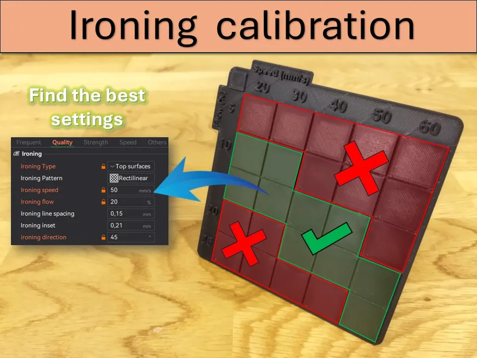

I tried to print this calibration model Ironing calibration - Free 3D Print Model - MakerWorld
With the new, but all come under extrude

:wrench: Update: tested a community “high quality” print profile on my X2D — still no luck
Quick update on my ongoing ironing saga. Following the idea that Bambu’s factory settings should transfer between users (unlike personal calibration), I tracked down a community print profile from someone reportedly getting great results on their X2D: X2D High Quality Print Profile V4
Test 1 — Generic PLA profile, as-is (ironing at 30mm/s, 20% flow)
  • No ironing: clear under-extrusion, very coarse lines
  • With ironing: good on the triangles (as always in my tests), but grainy texture + under-extrusion on the rest of the part. Not a good finish overall.
Test 2 — Same profile, but with my own calibrated flow ratio (0.9991)
  • No ironing: still some under-extrusion, but much less visible on the triangles
  • With ironing: good triangles, slight improvement on larger flat areas, but still not satisfactory
Takeaway: my top surface settings clearly matter a lot — under-extrusion shows up whenever flow isn’t properly calibrated. But even reusing someone else’s settings from a profile that reportedly works great for them, I’m still nowhere near the quality I used to get consistently. This makes me increasingly doubt that this is purely a “wrong parameters” issue on my end — if identical settings don’t transfer to similar results, something else seems to be going on.
Still waiting on Bambu support’s next step. Will keep this thread posted.
Generic PLA with ironing
Generic pla no ironing
My filament calibrated with iro
My filament calibrated no iro
