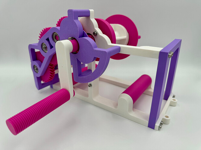

I’ve been pretty happy with this one. It seems to be more space conscious than others models.
Soner or later you will be happy to have a respooler.
Looks very nice! Did you print yours in PLA or PETG or…?
If I start now, maybe I’ll have it printed by the time the AMS arrives.
Printed in ABS.
There is also the Mini version without the top spool mount.
