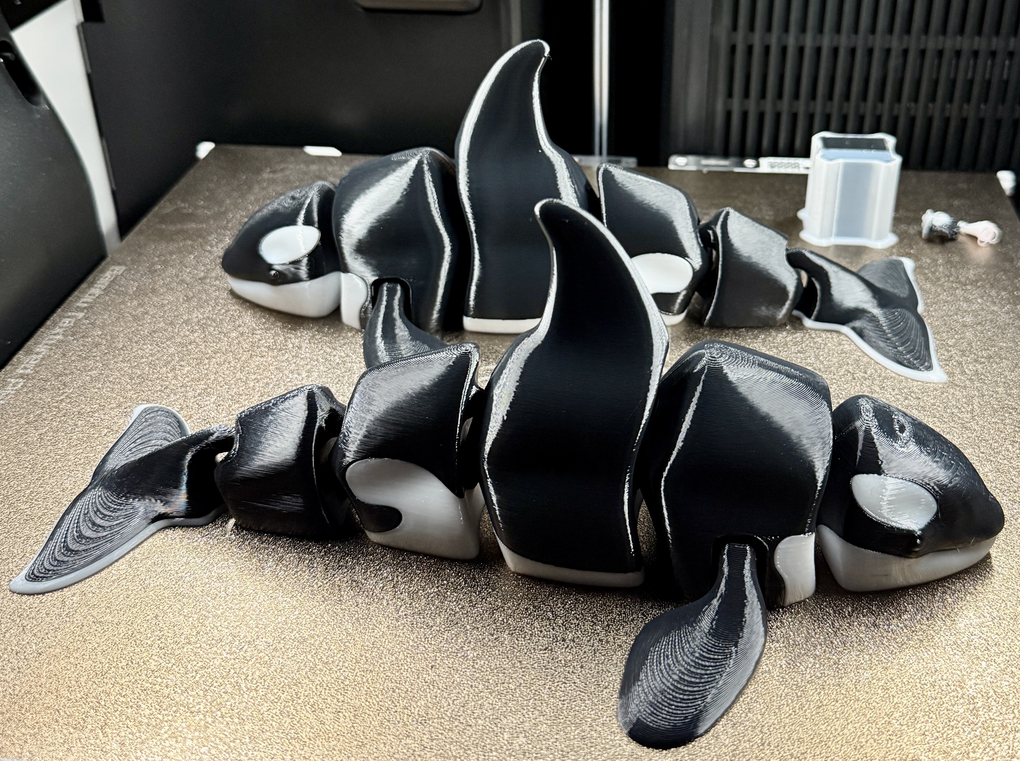

I love mine! Honestly! I’m enjoying PETG CF and ABS prints so far that are flawless for fdm. I actually printed some desiccant holders overnight with PETG CF, and when I pulled them off this morning, I honestly had to just sit and look at them for a minute. They looked that damn good!
Given, I increased my chamber and bed temp a little, but that’s all part of learning a printer, and it took me what, 5 minutes to change both profiles… And if it’s anything like both my P1S units, those settings will work for the vast majority of what I print. I first no problems venturing well into polycarbonate​and nylons, as a learning step(I’ve done a few nylon prints on the P1S’s, but they were not up to how I like my final prints to look}.
But this machine… It’s something else! I think it has allot of settings that a beginner could stumble on tbh, but that’s any machine with the number of features of this one…
But I think it was a worthwhile investment for sure!

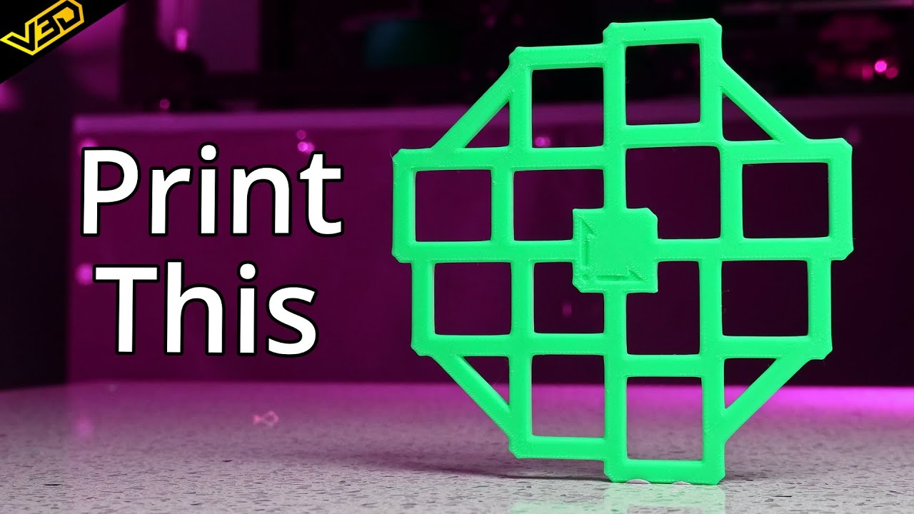

That brings up a good point. I believe the correct calibration sequence would be:
  1. Vision encoder plate calibration
  2. Flow rate calibration to eliminate (as much as possible) the over/under extrusion so it doesn’t interfere with the last step, which is:
  3. shrinkage compensation calibration.
Actually, to some degree, a good shrinkage compensation model will correct for over/under extrusion by using the two-pin measurement method (cf Clough42 for an explanation of that if unfamiliar with that approach for measuring center-to-center between two machinist pins), but, nonetheless, I still think it makes sense to reduce it as much as possible ahead of that if you’re ever going to do it at all. Here’s an example of such a shrinkage calibration model, one that I recommend:
You can even iterate using that model to get progressively more accurate shrinkage compensation plug numbers for your filament profile. I find that two iterations is generally enough, but I print a third as confirmation that I’ve reached the asymptote close enough.
