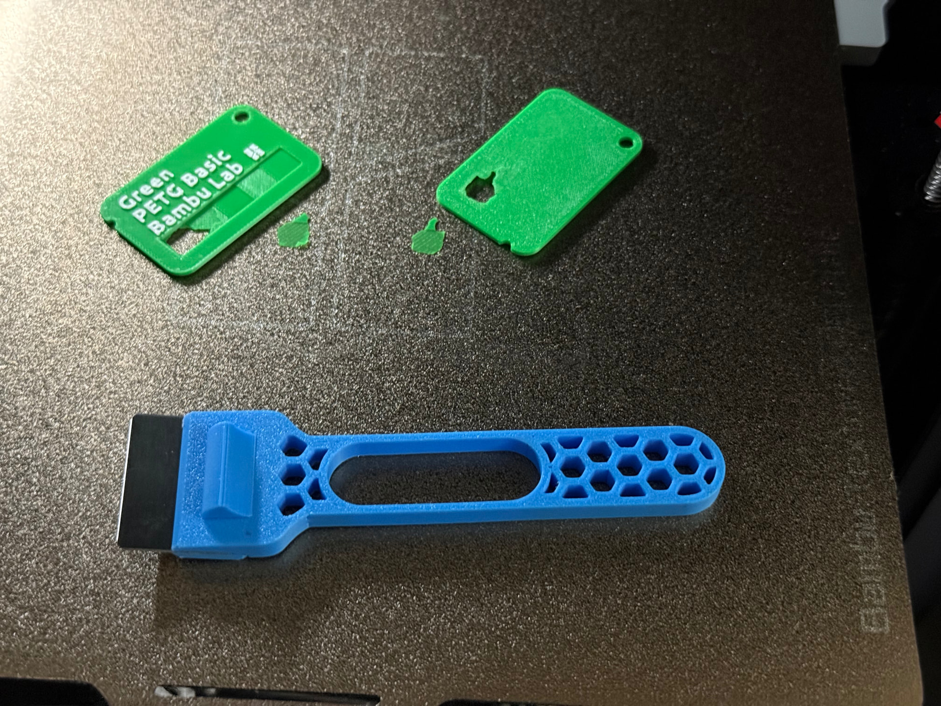

since the PETG HF is no longer being sold i bought some rolls of PETG Basic but ever since i got the rolls, the prints have not been in my favour, strange small missprints in the middle of bigger prints, and specifically the red PETG Basic stuck so strong to my Textured PEI Plate that i had to submerge the entire build plate in Hot water and spend 10 minutes getting the fillament off

Much like the PETG CF, it welds to the build plates, textured and smooth even more so.
I have left mine to stand for far longer than other filaments.
It lifts some of the gold of the textured plate.
What does the new PETG look like? Does it have the same glossy finish as traditional PETG?
Left for 12 hours.
I had to use the blade, I spent a few minutes trying to prize it up without it breaking, I failed.
The area of failure was the 0.2mm section of my own filament swatch design.
I have two more printed, and I am going to leave them 24 hours, I have also moved them to the front of the build plate in case it is easier to level them up without damage.
Third time lucky?
The white and black versions did come up without damage, they took a lot of effort.
so you are having a issue that i have been dealing with aswell, if you have too thin of a layer it sticks too well and breaks, when enough layers are stacked on top then it does not happen

Malc, did you use any liquid glue to put a cap on the force needed to separate the print from the plate? I use liquid glue routinely on textured PEI to both keep things stuck down and make separation easier.

PETG Basic and PETG CF are the only two that misbehave. PETG HF was a little tricky, but it came off and never had the issue shown in the photo.

Can try turning down bed temperature if it is sticking and you do not want to use a release agent.
I agree with whoever said use the biqu frostbite build plates for PETG. I switched as soon as they released as I prefer the less textured finish. I have not had trouble with PETG sticking too much.

Me either but advertising claims and manufacturer hype are realities in this world. My textured PEI worked great for a while then fine details stopped sticking until I used glue. It was a choice of buy more build plates or modify my procedure so I chose the cheaper option.
But stuff sticking so hard it breaks or pulls the surface off the plate is probably the new formulation. Glue would put an upper limit on that force and precent damage to the plate and part.

A 24 hour window did allow me to remove the filament swatches without damage.
Third time a charm.
I did also move the swatches to the front of the build plate. I am hopeful that is a coincidence.
so PETG Basic does seem to be not so forgiving on the Textured plate, even though it says you dont need to use glue on the plate, if the layer is too thin, glue may be required after all, its a fillament that one needs to get used to for sure, cause it is harder to print with then PETG HF
