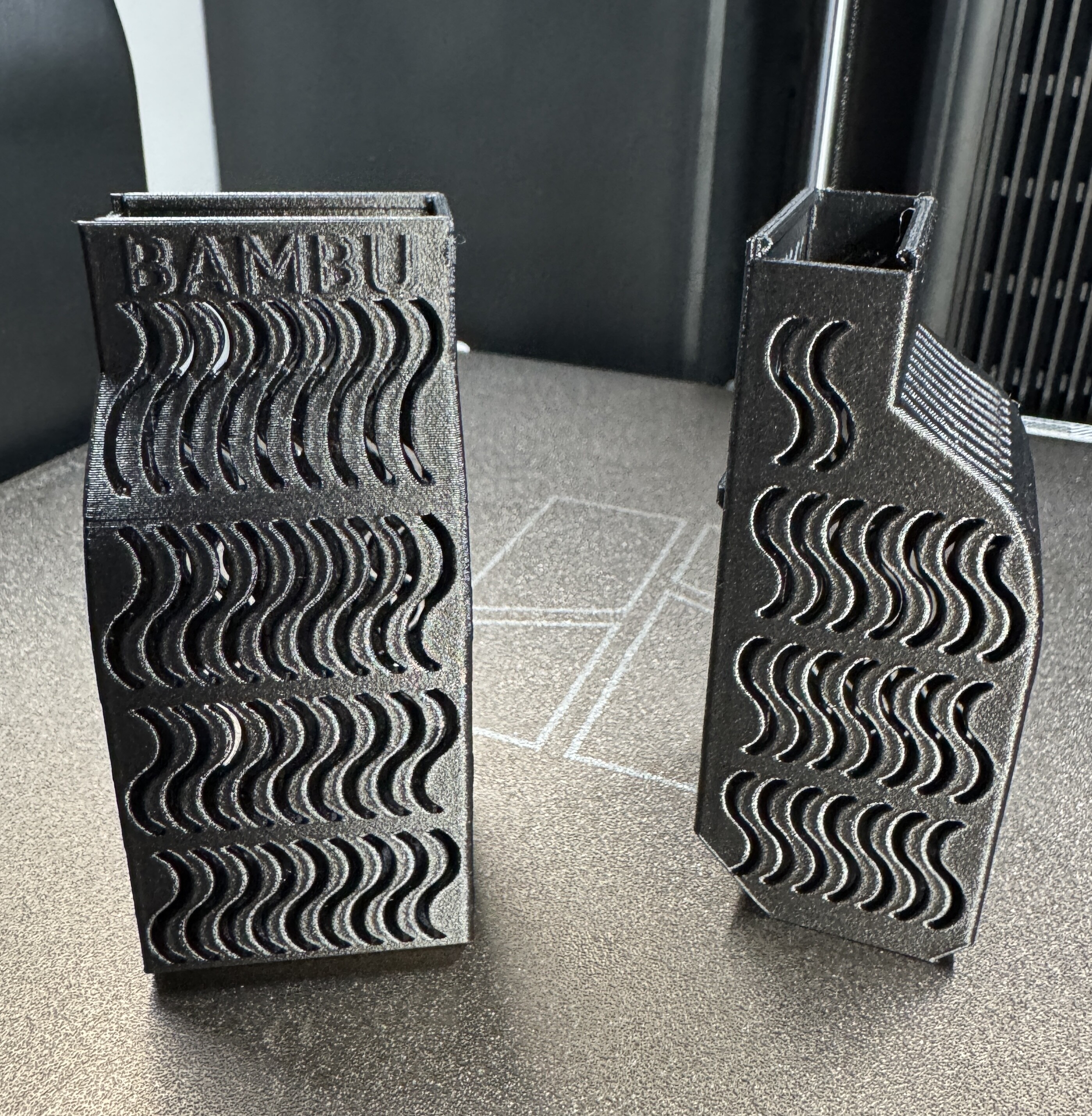

I have been trying to print PETG-CF on an H2D but, after less than 20 layers, the printer pauses the print with the error “Your nozzle seems to be covered with jammed or clogged material.” If I resume it or even disable the AI monitoring entirely, the print does come out badly.
I have tried different spools and different prints to see if it is for some reason the model. The print does work just fine on an X1C.
The H2D does work just fine with doing the same model out of PETG-HF.

PETG-CF is a bit too sticky which is why it would stick on the nozzle. If you’re printing with a low layer height (especially when lower than 0.2mm) , you’re highly likely to encounter problems like this, as the nozzle is pressing on the filament hard.
Other things you can try is to slightly reduce flow rate, or reduce the volumetric flow rate, and also reduce the infill/wall overlapping settings.

I tried adjusting the z-offset a bit and increasing the layer height. I think the z-offset might have helped a little because the print made it further, but it did succeed.
I am going to try to continue to adjust the z-offset, but I could not find out how to adjust the flow rate.

To modify the bottom layer flow rate, you need to enable Develop mode.
