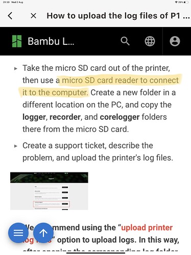

“The P1P’s log files can be automatically uploaded using Bambu Handy through the network, just like the X1 series. The upload speed should be approximately 150 kbps when the network conditions are favorable. When logs are uploaded, you can choose a time frame. If necessary, you can select a specified time period for the logs to narrow the overall amount of logs sent and decrease upload time.”
Just look at the wiki… How to upload the log files of P1 series | Bambu Lab Wiki
Trust me - There’s no option in my Bambu handy app to upload the printer logs. The instructions say to remove sd card and put into a computer which I can’t do unfortunately

If your machine is connected to your LAN, you can use filezilla to connect to it and copy anything off the card to your PC. Connect to your printer IP on port 22 with username ‘bbpl’ and the password is your LAN access code shown on the printer.

After following the instructions to try and upload my SD files - which unfortunately weren’t very clear - you have to go into support tickets, add more details then tick a box which says ‘log files’ then upload them from there. I just kept getting told ‘they are in the SD cards which you can access through studio’. Anyway I uploaded them and they have now sent me a part (which they think is the problem) which should be here mon/Tues. BUT bambu have said, if the fix doesn’t work I can return it for a replacement.
