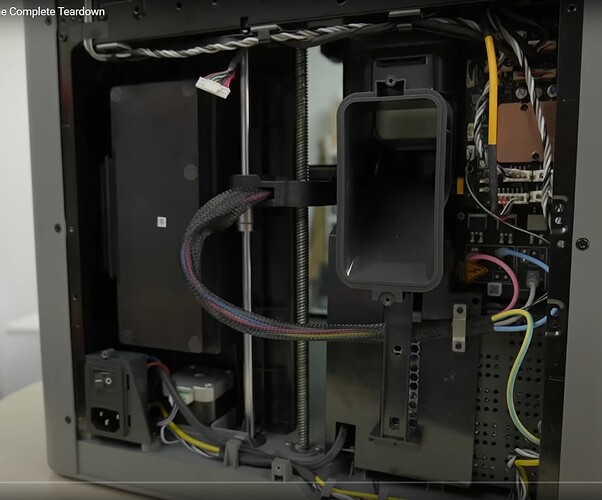

Just installed P2S rear exhaust fan, is it okay to seal old vent?
As the title states, I’ve just installed the external rear exhaust fan (with filter) and new rear panel. To help reduce fumes and VOC’s wouldn’t it be best to now seal off the old perforated section next to the poop chute? Or would this cause some sort of issue that I’m not aware of? Cheers
if you are not going to print any cooler filaments I would say yes: The exhaust will suck cold air into the printer (by creating negative pressure), and ideally that should happen as slowly as possible: just enough for toxic gas not to exit the enclosure from gaps. To avoid warping the enclose has to be heated evenly, hence the less cold air in the better.
You could also consider sealing the edge of the top door as warm air move upward..

BTW the perforated section next to the poop chute is to cool a motherboard, I believe, so best not to cover it. Last thing you want to do is overheat that!!!
Thanks, I did notice that and decided against changing the airflow.
You can cover it without any problem. That plate is directly connected to the inner zone in the area of the rear threaded rod, and it will be at the same temperature as the printer. If you also place the extractor fan over it (that’s how I have it set up), as Bambu Lab recommends on its Wiki, you’ll improve its cooling.
The the area behind the rear panel is vented through either the old vent near the rear poop shute or the later “new” vent so as long as one or the other is clear for air movement it shouldn’t be an issue.
