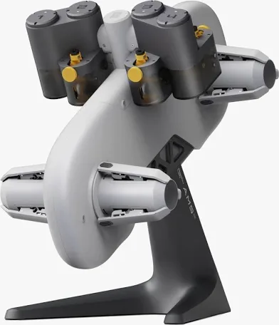

My P2S just showed up, I only have about 8 hours on it but no issues yet, EXCEPT what I believe is with the AMS 2 Pro that came with it. So I had Bambu’s PLA-CF in Slot 4 and printed with it fine. The next day I went to feed it, it goes in to the extruder but then retracts and keeps trying until it fails. I moved it to the other slots, no problems. I put some Basic Bambu PLA in Slot 4 and it worked. I tried the PLA-CF spool again and it failed so I’m not sure whats going on with that. In the future when i get one I will try another PLA-CF, but until then I guess Slot 4 just doesnt like this particular spool. It so weird because I see it feed in to the extruder but it still fails, but a spool of basic didnt…
I found the AMS 2 doesn’t like any deviation in the spools. If your spool is warped or has anything that may bump on its riding edge, it will cause it to stop turning and fail. This the original ANS had no such problem.
The werid thing is it worked one day 1 in Slot 4 (PLA-CF), and now day 2 and beyond it rolls it all the way in to the extruder (and i see the gears on the extruder turn to grab it) but then it kicks it back up and keeps trying till it fails. I move it (PLA-CF) to any of the other slots and no issues. I moved regular PLA basic with about the same amount of material still on the spool (low amount) and no issues with that in Slot 4. Its really weird. Its like my Slot 4 just doesnt like that particular spool. Only that spool and only in Slot 4 lol. I will say I’ve been using 2 original AMS’s since the release of the P1P with like no issues, the rest of my 5 others are AMS 2 Pros and I’ve had this issues and a bad board in one I got replaced. Granted 6 vs 2 is a large sample size for the AMS 2, but those originals ones are still killing it. Makes me think for any particualr situation I dont need the drying feature i’m about to just get more original AMS’s

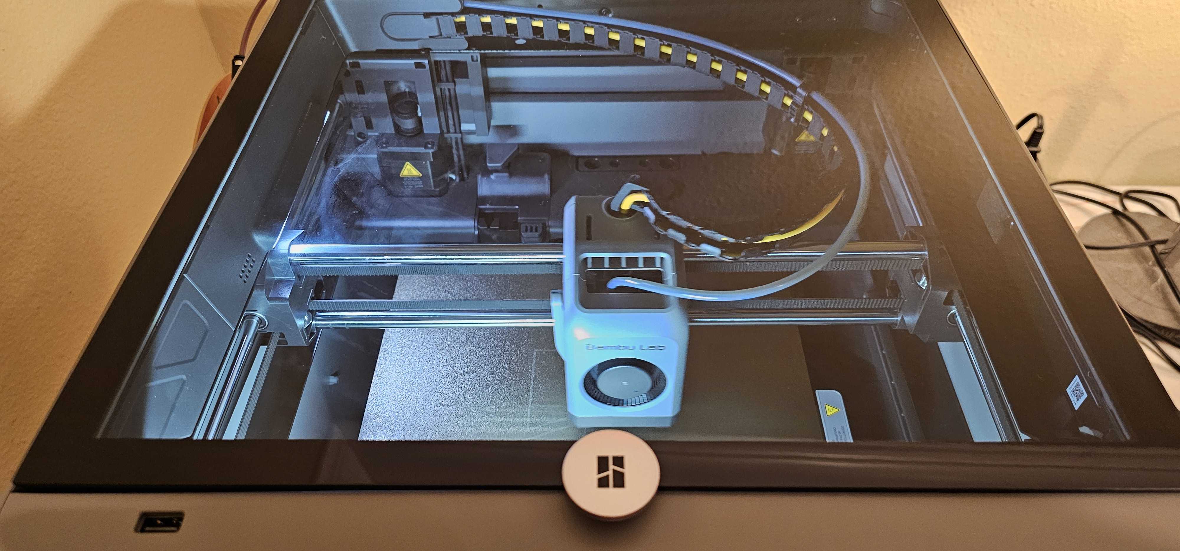

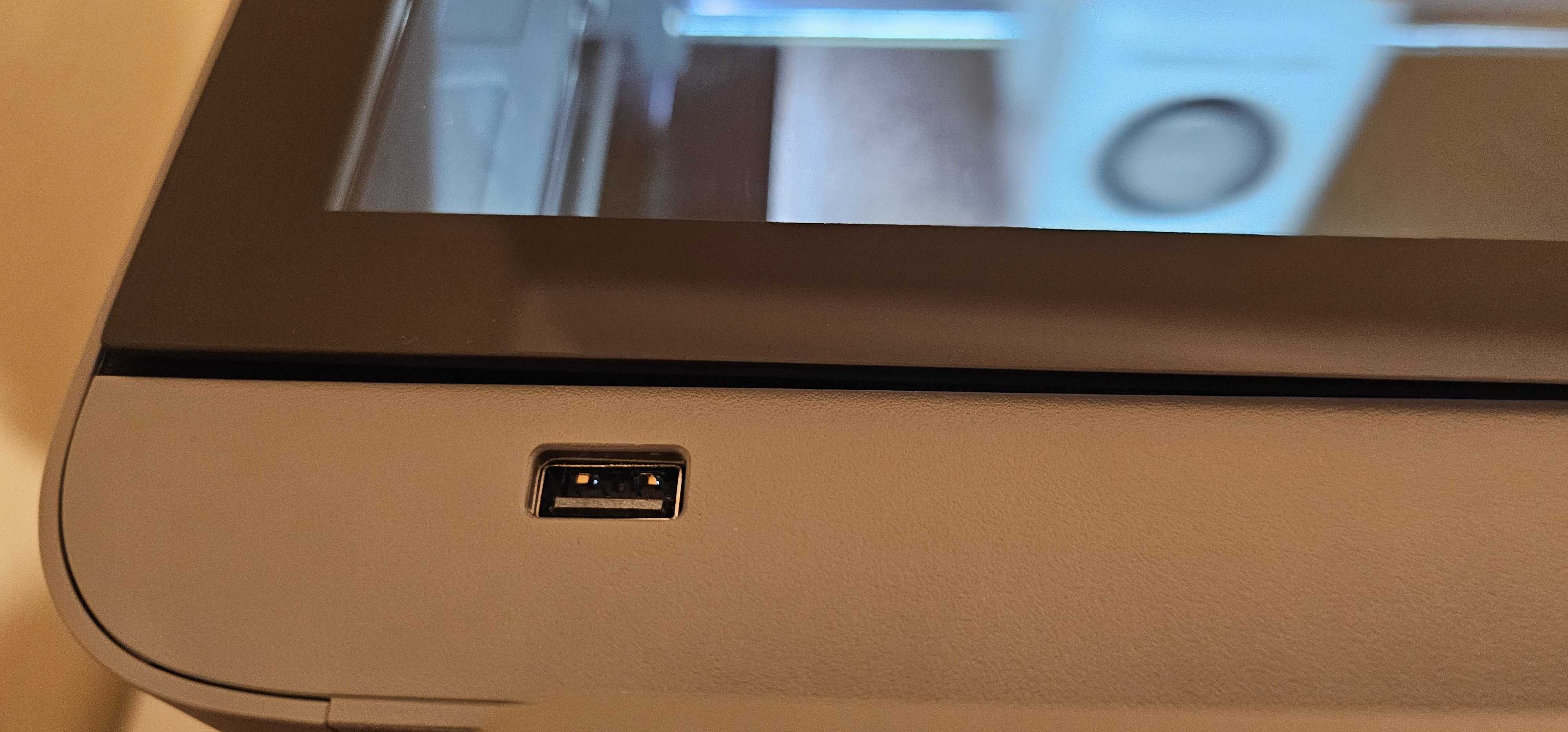

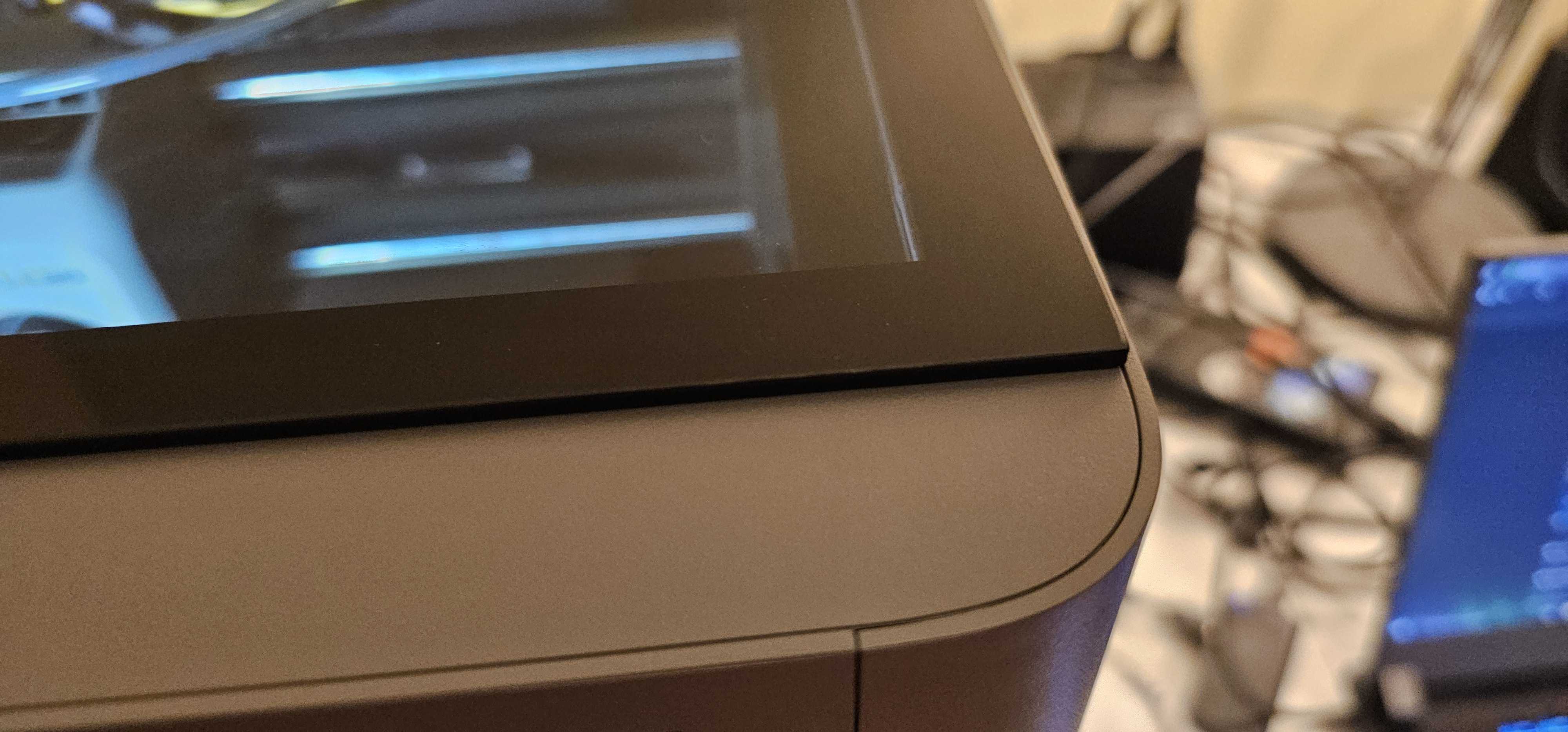

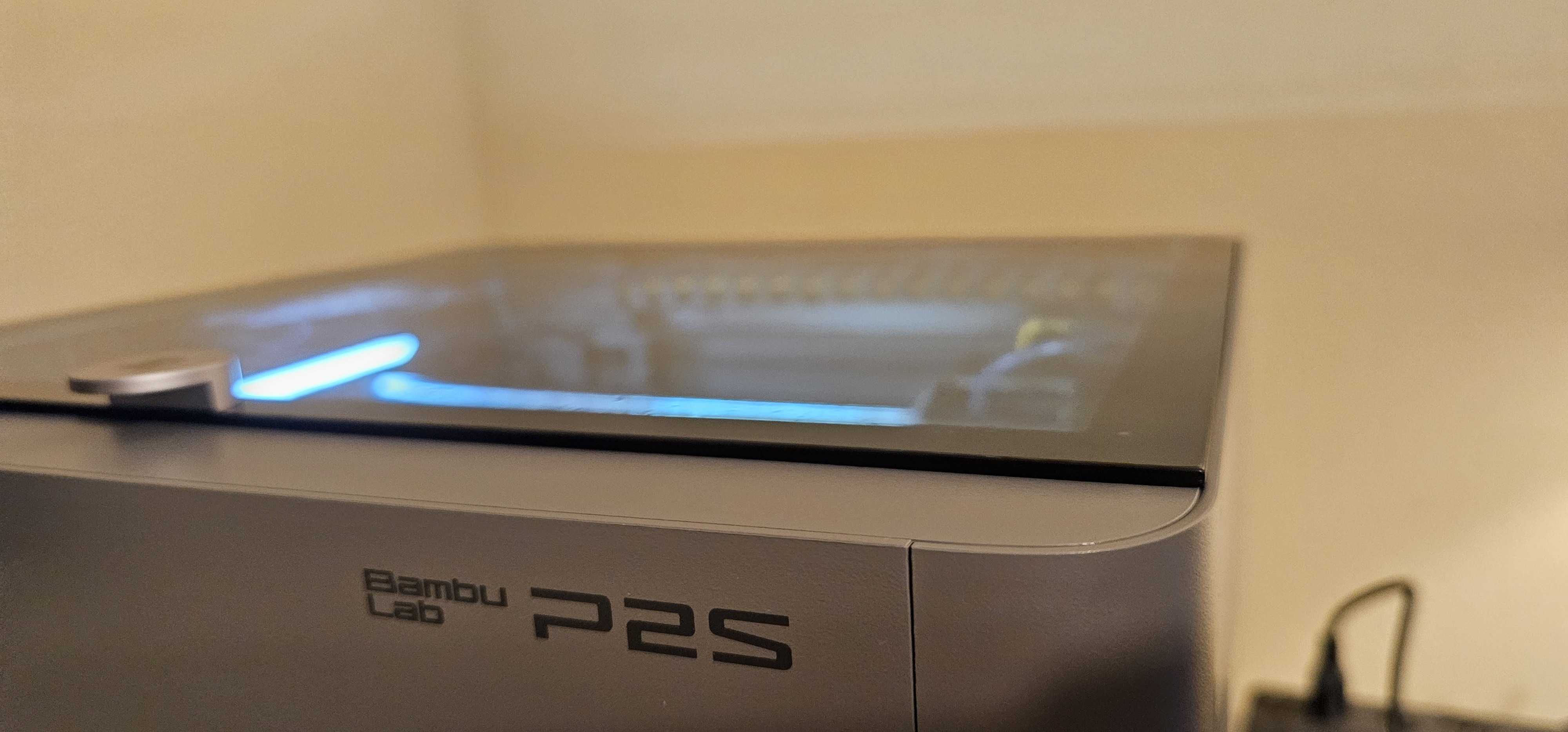

I just got my Bambu P2S and I think it got damaged during shipping or something because the glass lid doesn’t close entirely at the top.
I saw another person post on reddit that had an identical issue which makes me think its a QC issue or something rather than issues with shipping. So far it’s printing fine but I’ve put in a support ticket to see what can be done.
