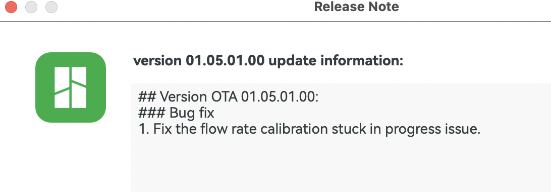

Look they just released 01.05.01.00 Firmware which, according to the release notes, should fix the calibration stuck issue
Where did you find the release notes? I’ve been looking all over for them.
I clicked the “Release Notes” Link in the Bambu Studio Update Tab
The wiki also has them but often it often lags behind the actual updates.
Flow Dynamics works for me with the update to 01.05.01.00 but Flow rate still don’t work for me. Is Flow rate working again for you?

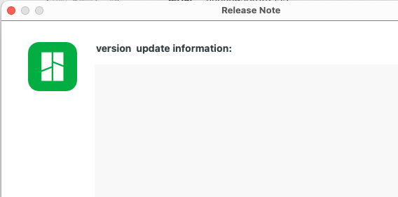

The Link “Release Notes” opens a new window here, but it stays empty:
Also, the release notes page in the Wiki hasn’t been updated yet. So, I’ll wait a little… @JonRaymond 's information worries me a little. :grin:
Release notes updated for 01.05.01.00.

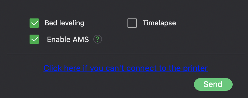

Hey, i dont know how to make a post as many others. I just want to know how i can disable auto bed leveling and poop shoot in Bambulab slicer. It happens before every print. Thanks
I don’t think you can disable the purge “poop shoot” in the beginning but bed leveling can be disabled when you select “Print plate” another window pops up and you uncheck the box before you hit send.
you can if you remove it from the machine gcode
Very true. I didn’t think of that when responding. Was totally on a checkbox checked or not thought process.
