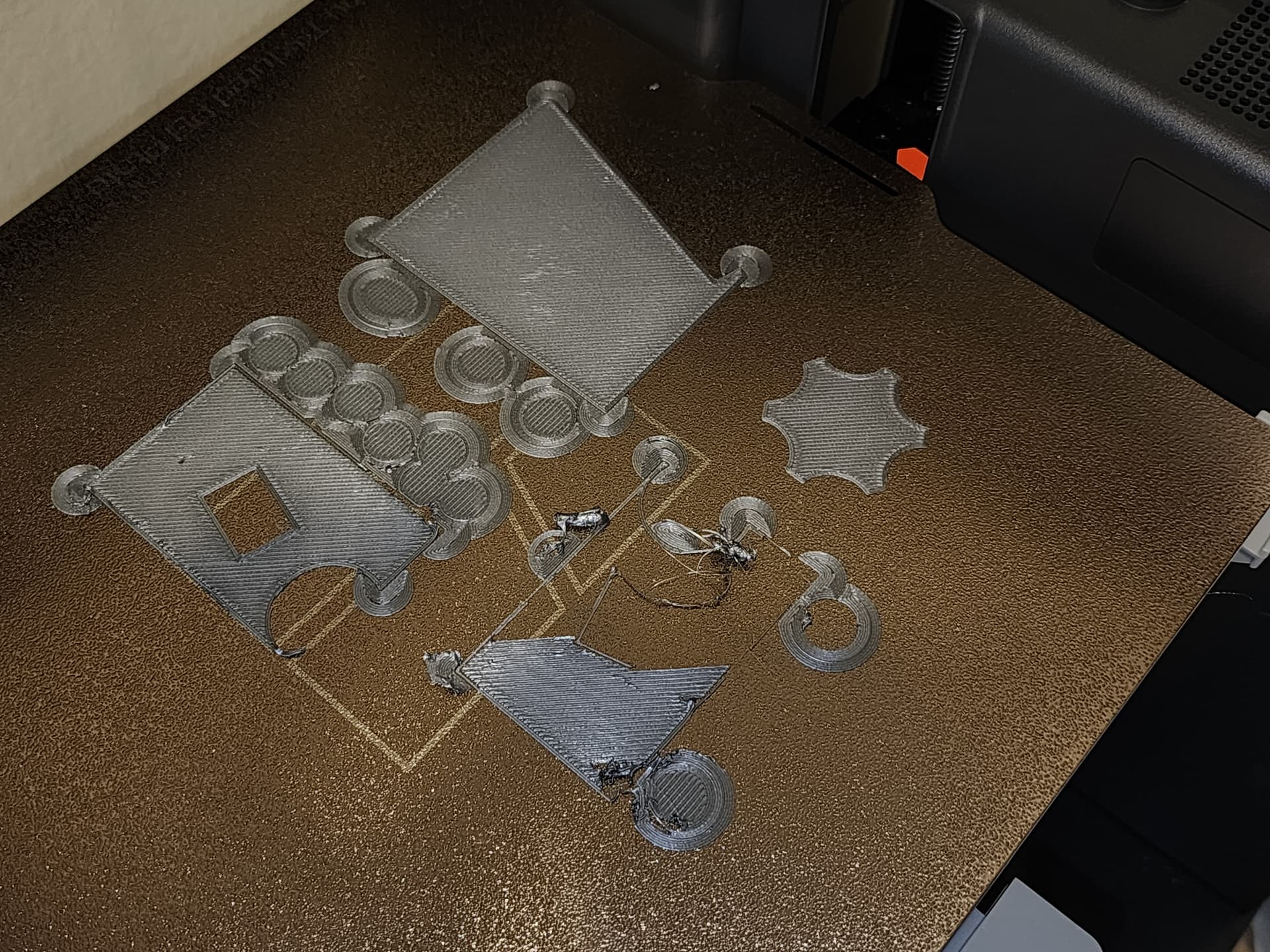

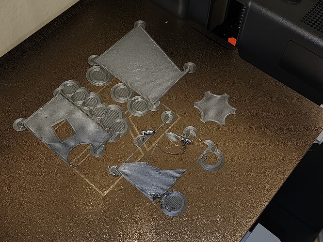

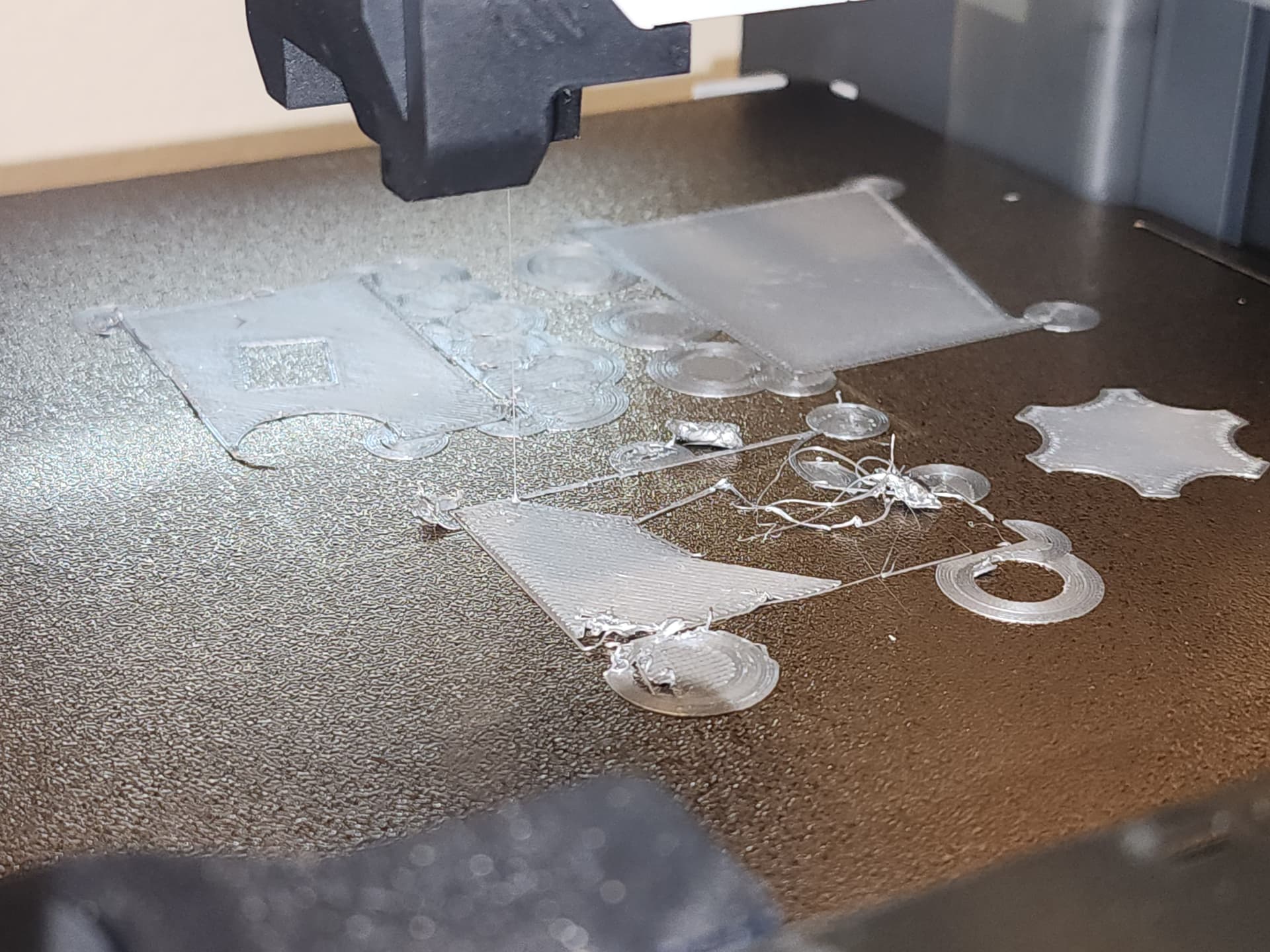

Hi,
As you can see from the pics; I am having trouble getting some, but not all of my PETG parts to have a decent first layer.
I know you won’t believe it but I had the filament in a dryer for 13 hours.
I saw this post, which seems “a bit” similar, but not exactly the same issue - but there was no solution provided
Any other suggestions?
  • First layer speed suggestions
  • Room dehumidifier (should I get one, will it really help)
  • Using Polymaker Lite PETG (cuz the Bu Labs PETG-HF is sold out still)
  • Any other suggestions
Thanks!
AJ
Here are some things to check:
  1. Clean your build plate with dish soap and warm water.
  2. Perform a filament calibration for pressure advance and flow ratio.
  3. Perform a printer self calibration.
Guess again. Dirty build plate. :astonished:
It could be wet filament but that won’t reveal itself until you’ve had multiple layers. This is clearly a first layer adhesion issues. Until you have that part remedied, one cannot truly diagnose if the filament is wet.
Before you waste any more filament and time, do a first layer test.

Ohhhh I have a Creality dryer. The thought was using a room dehumidifier in addition to the drying. Actually cleaning the build plate worked like a charm.
That did the trick. Cleaned the build plate with Dawn, and we’re up and printing.
