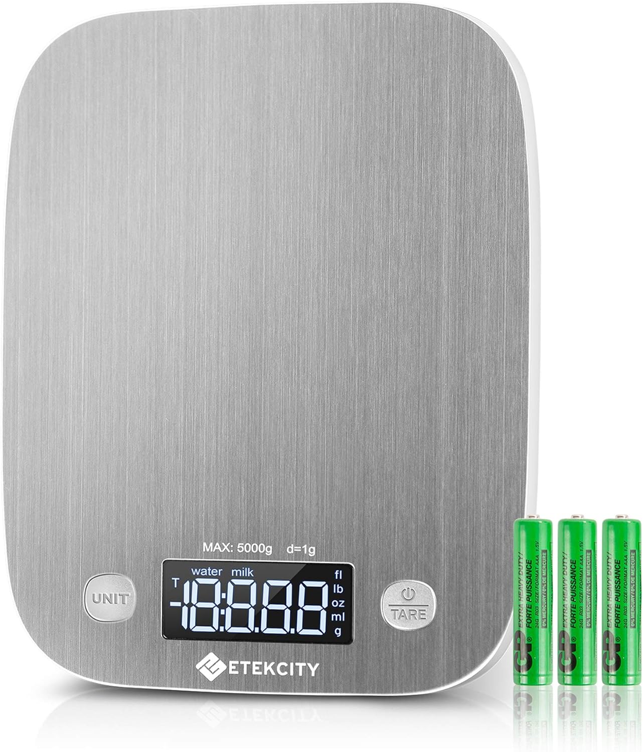

A cheap kitchen scale is what I used to measure before an after. I think I paid $10 in 2022, it’s now up to $13. The point is, get the cheapest digital scale you can find because you’re not interested in absolute accuracy, just weighing before drying and after drying weights. Remember, 1g=1ml=1cc of water, gotta love the metric system. :sparkling_heart:
