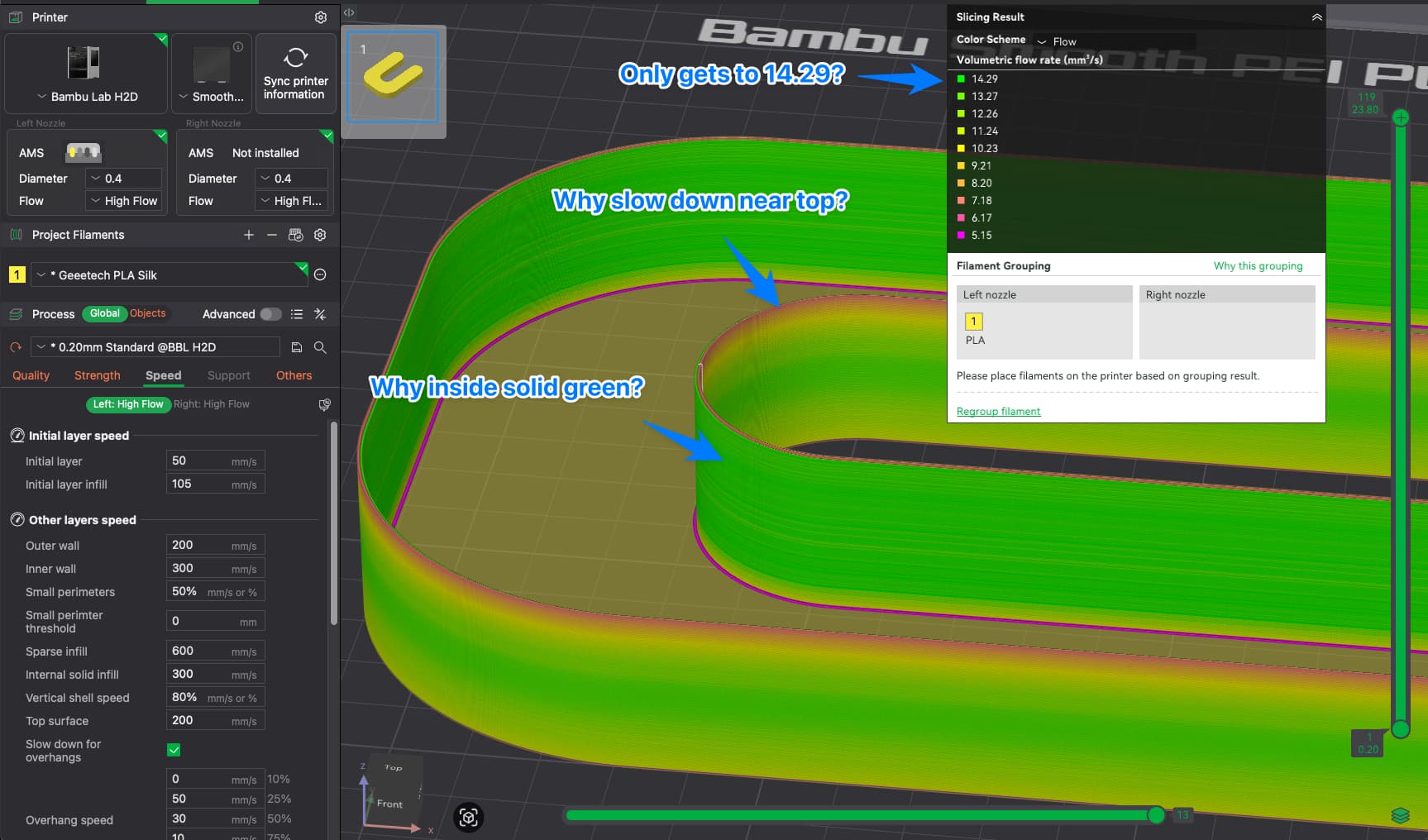

I’m trying to calibrate the speed of my filaments and I’m using this flow test tower.
Now, for the test, I temporarily set my filament’s profile to have a max volumetric flow of 200mm3/s so that there’s no way there’s a bottle neck.
When I slice the model and look at the Flow Color Scheme in the Preview, I see this:
14 seems kinda low for PLA with a HF nozzle, how is this the max?
I started to do some math:
The last layer on this model has its outer/inner wall set to 476mm/s.
As far as I’m aware, to get the MVF, you would do Speed * Layer Height * Line Width.
In this example, the Layer Height is 0.20mm, and the Line Width is 0.42mm
So: 476 * 0.20 * 0.42
This would result in: 39.984mm3/s
Why does the preview show 14.29?
Am I missing something?

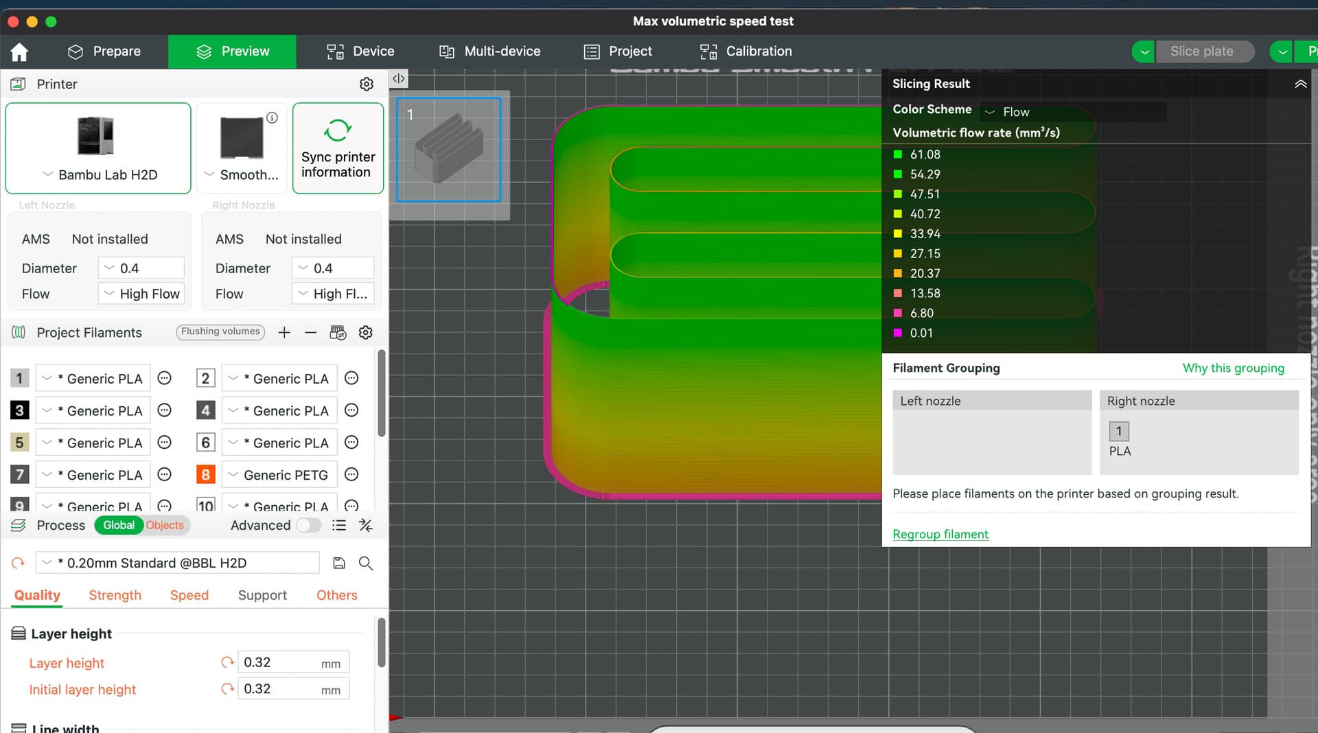

I’ve also been trying to figure out how to set one of these tests up. I’m running into something different though. My previews are showing the flow going up to about 43 but about half way up the speed caps out at like 173mm/s. I couldn’t get it to change no matter what settings I changed.
I’ve tried setting it up with a non Bambu printer profile and then switching back, but that didn’t work either.

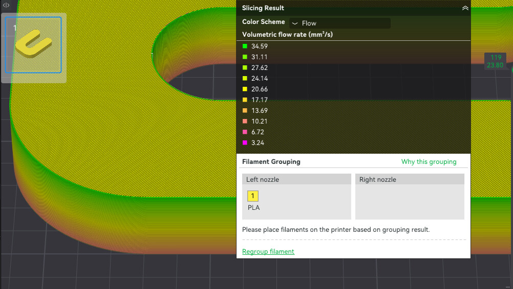

So I added another printer (I choose Qidi Plus 4) it loaded the new printer. I went back to the H2D and it looks like all the quality settings had been reset, but when I checked the flow, it’s actually the correct calculated value!
But I don’t want to print a solid model, so I remove the top/bottom layers, still the correct values. However, when I remove the infill, the flow drops back to the incorrect values. Something about the 0 infill changes everything.

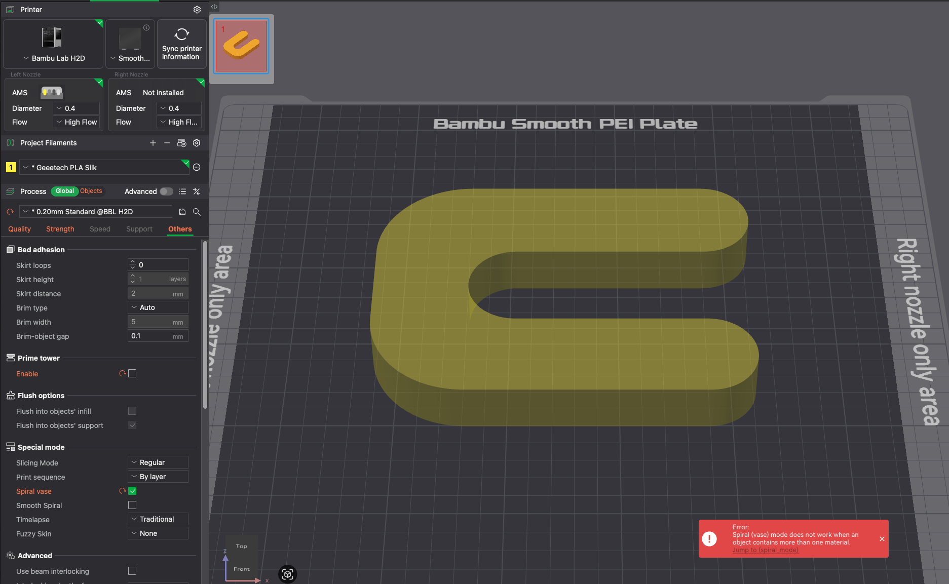

change it to vase mode.
2525252525
That seems so obvious in retrospect, a true face-palm moment.
Unfortunately I get this error saying it can’t do multi-material?
But, I don’t have any other materials?
So confused.
Could I try the one you’re using? :pray:
Yea I think modifiers/modifier objects are being considered as ‘other materials’ in bambu studio. I think it’s a bug.
https://www.reddit.com/r/OrcaSlicer/comments/1frx94l/help_how_to_add_modifier_in_spiral_vase/
I don’t think vase mode would be possible in this use case then.

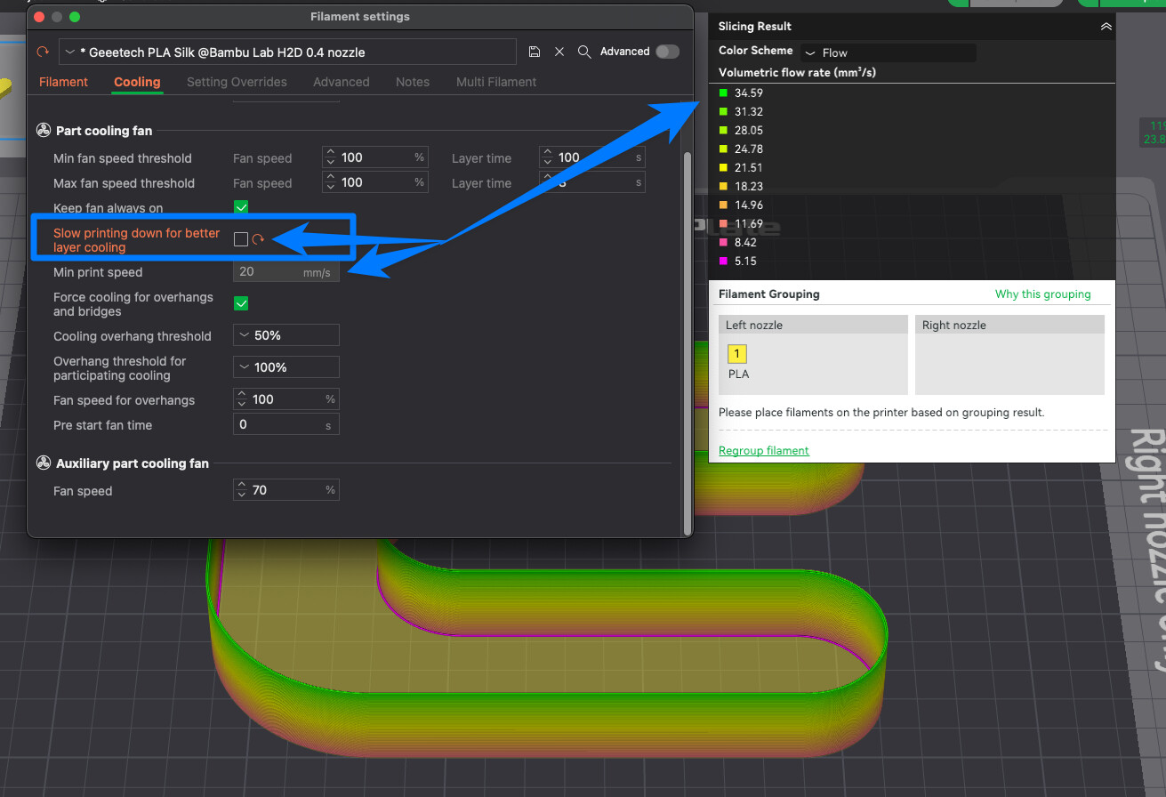

SOLVED IT.
I should’ve looked a little closer when checking out @EnoTheThracian’s suggestion. The problem wasn’t Max Fan Speed Threshold, it was actually the Slow printing down for better layer cooling setting. It essentially just overrides the Max Volumetric Flow setting for better cooling. Makes so much sense in retrospect but yea, solved the mystery.
