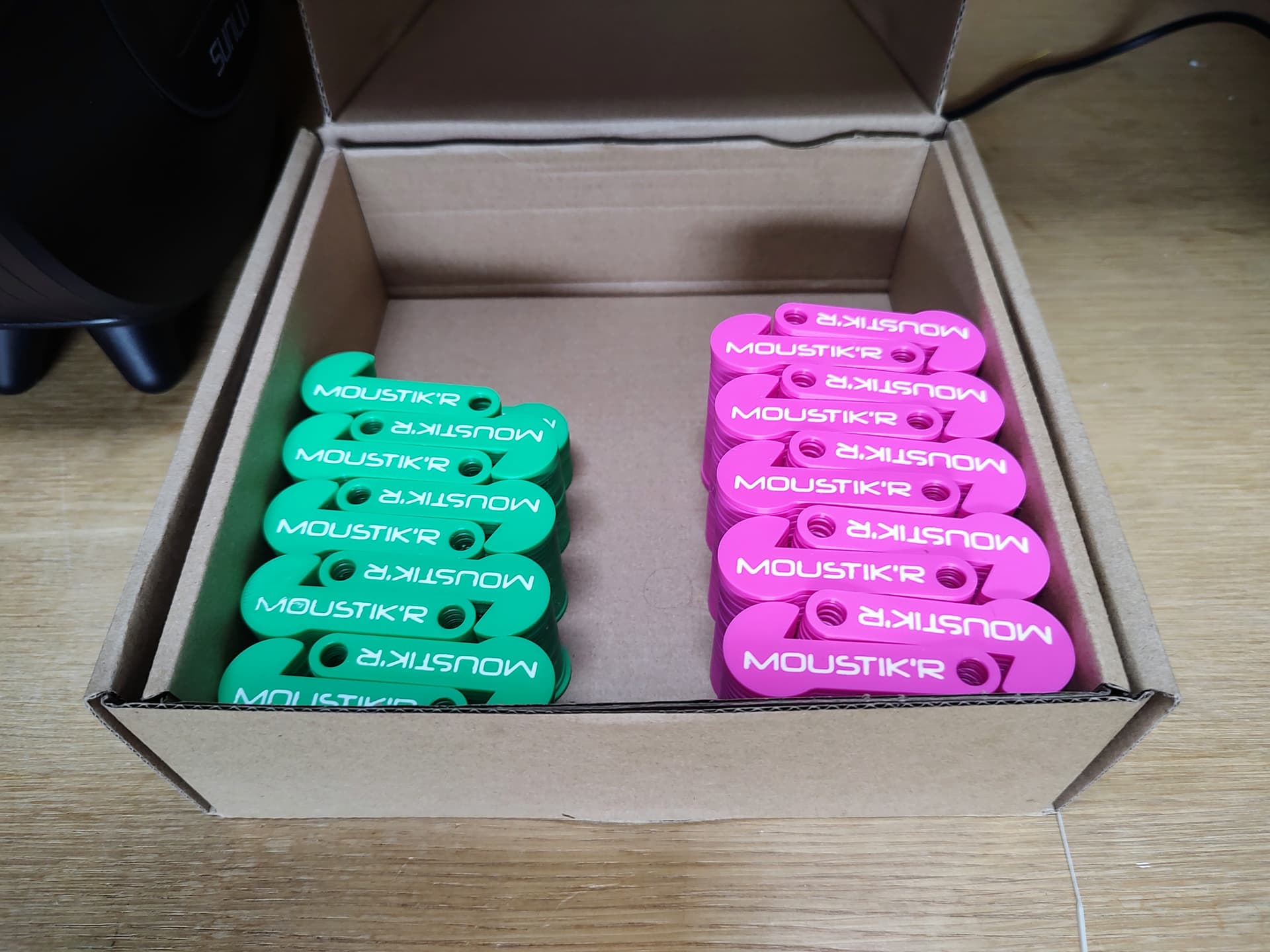

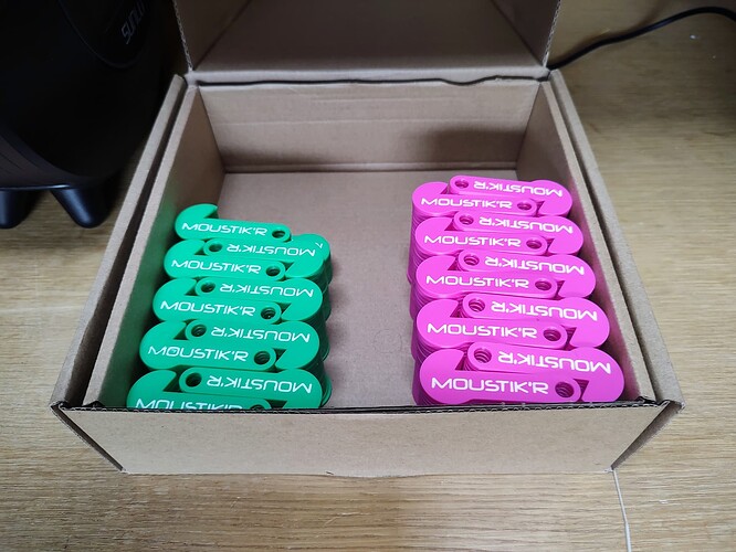

I have a practical example, I’m currently doing a job for a client : 750 customised dual colour cart coins.
I have printed 450 cart coins in 3 days.
Cost of the setup
A1 mini combo + swapmod + 8 smooth plates
350 + 70 + 825 (20 during the sales) = 620€ (580€)
Vs
2
A1mini combo + 2 smooth plates = 750€
Added advantages:
  • I don’t need to have 2 spools for each colors or respool
  • I don’t have to dry 4 spools but only 2.
  • Reduced the human labour. Ideally only one human intervention per day. So at least 6 times less than a dual printer setup.
  • I had zero lost on 450 parts, all the parts look amazing.
  • if the printer brakes or needs maintenance, I can just swap the A1M with a new one (plates, swapmod and AMS are still good). 620 + 200 = 820€. But the production is not affected where if one of your printers is down the production output is divided by 2.
