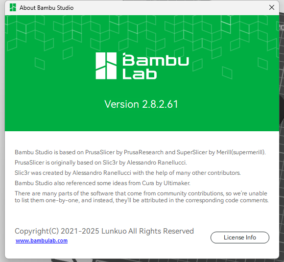

Is the gcode you have on there made for your printer ? unaltered ? made with ?
I knew I forgot something.
Code straight out of Bambu Lab, version 2.8.2.61.
Please post your project 3mf file, I’d like to see what the nozzle change code looks like.
