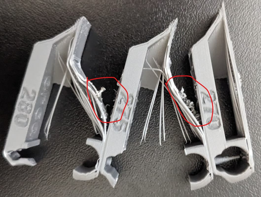

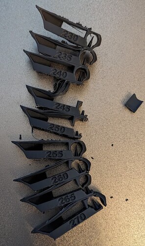

I am currently attempting to calibrate a spool of eSun ABS+ Silver on my P1S printer, but am facing extreme difficulties with layer adhesion. Despite having dried the filament for 8 hours at 70°C, the issue persists. My goal was to print a temperature tower to find the optimal printing temperature, however, no matter the temperature setting, no layer seems to adhere properly. I can easily separate the individual layers with just a finger, a problem I’ve never encountered with any other filament before, even though I have experience printing with various materials including ASA, PLA, PETG, and TPU from different manufacturers.
I am utilizing a 0.4 CHT nozzle which has performed flawlessly up until now. As a test, I printed a temperature tower with eSun PLA Marble and the result was excellent with proper layer adhesion, which implies that the issue seems to be specific to the ABS+ material.
Here are my current settings along with some photos of the temperature tower.
One thing I’ve noticed is that the nozzle tends to push some filament aside during printing, as can be seen in the images. This problem exacerbates as the printing temperature is lowered.

I have just printed a tower with eSun ABS+ Black and it is exhibiting the exact same behavior with the Generic ABS profile.
I have printed a few parts with eSun ABS+ grey yesterday without any issues with the Generic ABS profile.
The layer adhesion is so poor for me with both that I can simply snap off the individual layers of the temp tower with my thumb without any effort. I’ve never seen anything like this with any other filament no matter what temperature was used for printing.

I have now printed some parts with the filament using the mentioned profile from eSun. The parts look quite good so far, but I still find that the layer adhesion is pretty bad and the parts are relatively unstable. It’s possible that I just got two bad rolls.

I did notice you have the flow really turned down (.96) for this filament. How was that in the profile or did you do that. You could just be under extruding. .
The 0.96 doesn’t fit, I conducted a flow calibration afterwards and my value is now at 0.99. I will try an ABS from another manufacturer soon.
this is a widely known problem with eSun’s ABS+, a lot of discussions on reddit about how bad it is with layer adhesion. Their regular ABS doesn’t have that problem apparently, so it’s the plastic that they alloy the ABS with that makes it not stick together well. Another reason to move onto ASA!
