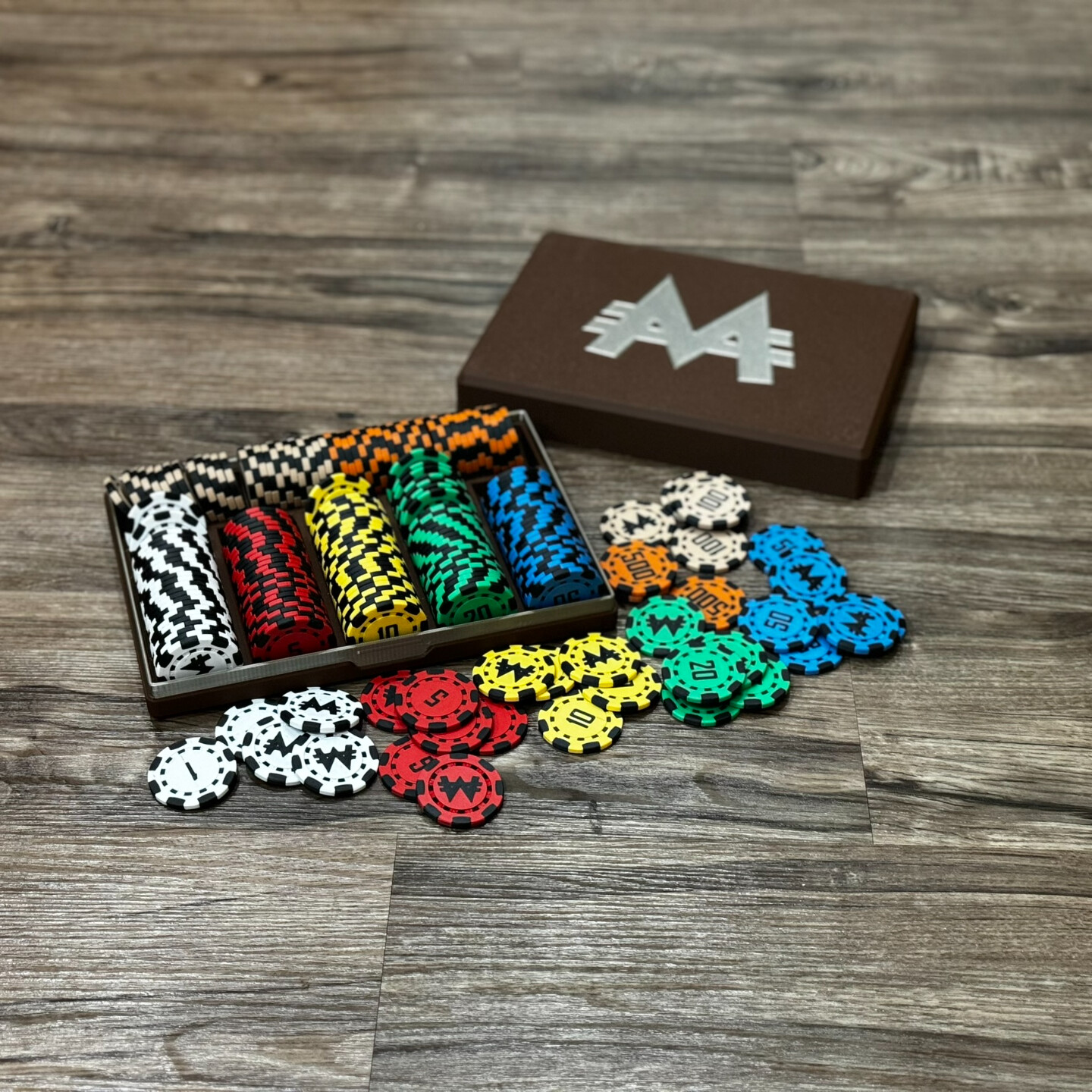

Here’s Josh’s chips for reference. No supports are needed, they just print on both sides.

There are many poker chips available on MakerWorld I didn’t bother designing one I wanted to as it was already flooded with them.
What are you trying to print that is so different to standard poker chips and all the ones already available?

Not sure why you need to flip it to print, is it because there are patterns on both sides? For general depressions, it can be printed smoothly face down without support. For example:
https://makerworld.com/en/models/240581
For models that can only be printed with both sides facing up (for example, both sides are relief), it is recommended to cut it in half, print it separately and then glue it together.
Print split in half. Facing up. Glue together.

That circular inset around the M would print without supports. The slicer will just create small bridge and / or overhang extrusions across the gap. Printers can bridge surprisingly large gaps without supports depending on the geometry. In this case it’s a rather small distance. Honestly, the only setting I can think of changing based on the screenshot is enabling the Arachne wall generator to perhaps get sharper details.
That will print without any issues in one go.
Turn off any supports they will not be needed that span (bridging) is tiny that a really old printer could manage, let alone your P1S that could span significantly further without issue.
