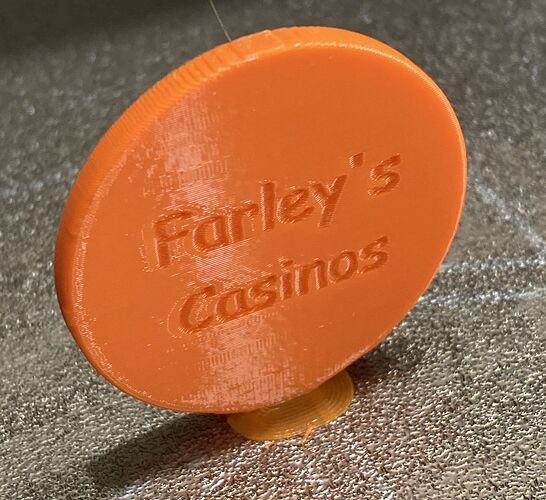

What I meant was that I don’t have AMS. I have different color filaments. But hey-- check this out: Printed on edge. Both sides beautiful. A testament to the PEI textured plate in combination with BBL liquid glue! Just keeps getting better!
(A Josh3d print file. Thanks)
I really thought the aspect ratio was going to be just too much to print that like that without falling over.
Nice work!

The bridging on your example is what I was hoping to get away from. Printing on edge seems to be the way to go (so far).

Yet another prototype. Needs more detail. Just iterating a little at a time.
Now you’re just rubbing it in Bill… go ahead an print a chip that says, “You were wrong!” LOL… Seriously though, that looks great.
Ha!
No never. Not a rubber inner. :grin:
You may wish to experiment with variable layer height to try and get the curve surfaces a little cleaner.
