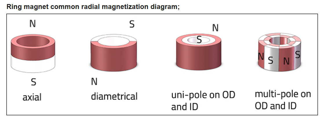

If your previous magnets were of type multi-pole (most right) then a slight rotation of the magnets might already cause issues.

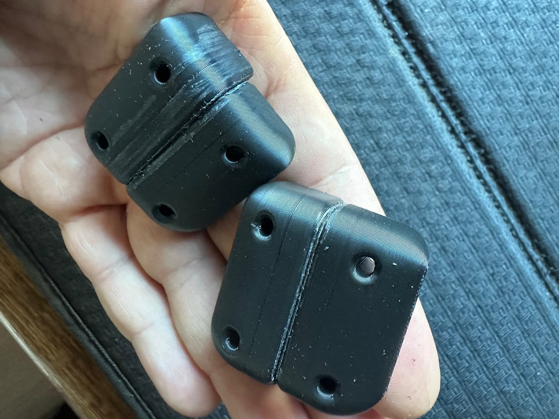

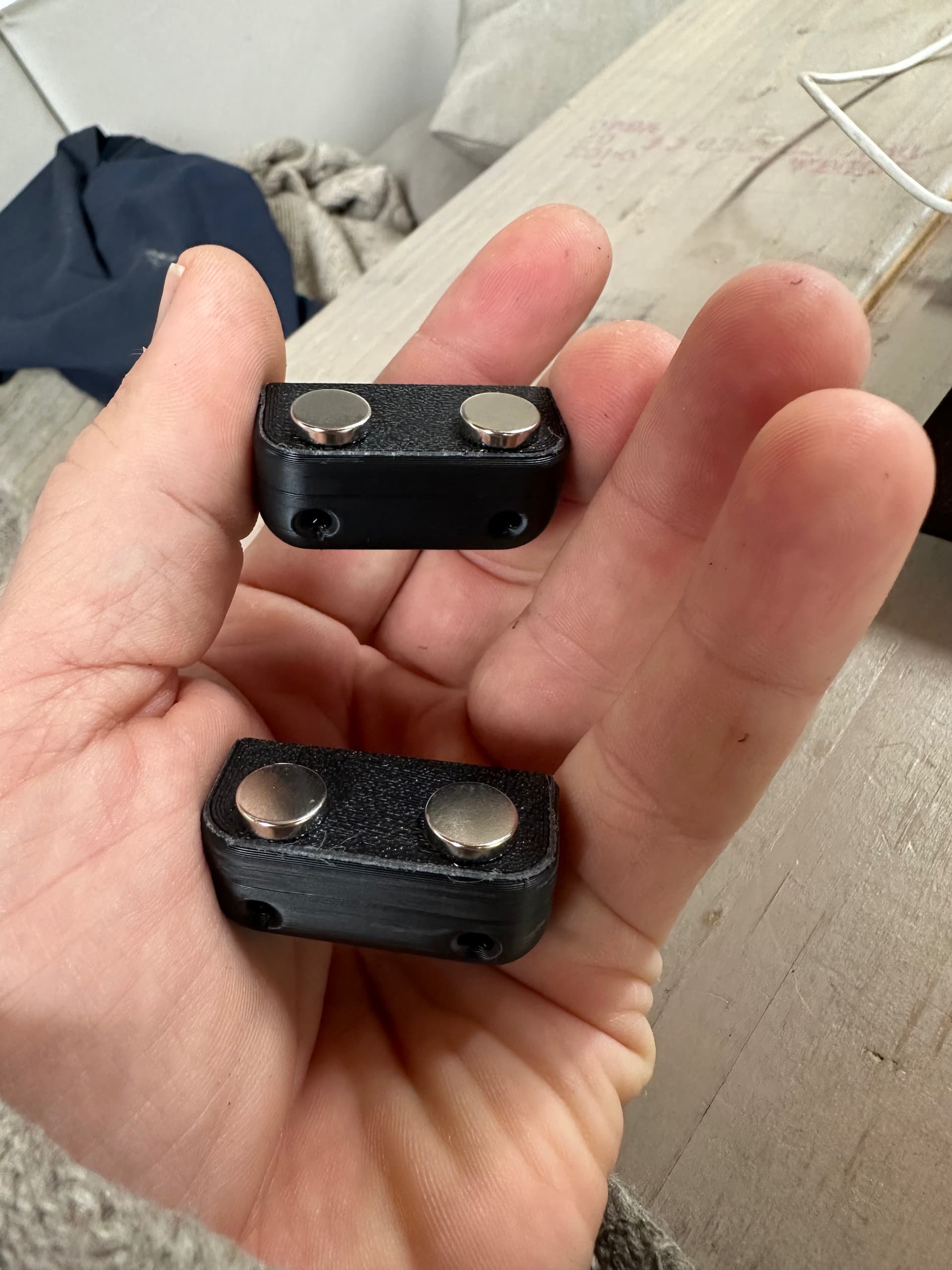

New neodyme closed disc magnets embedded problem solved! Thanks yall. I think I’ll make the pocket 10,15 to have a press install with less force to prevent bed movement layer distortion visibility.
I think the open disc magnets weren’t neodyme or had something like multi vector polarity….
The reason I dont want to glue them is of course by owning a H2D I can! Using this embedded method also prevents loosening magnets or damage coating by slamming the door…
I can’t disagree with the “I can” statement, but making the pocket for the magnet slightly deeper and even make a tiny overhang at the top prevents them from touching each other.

I just figured out the best pocket for a 10 x 2,5mm neodyme magnet is 10,15 x 2,8 mm. It is a snug press fit without the need for a lot of force and makes sure the magnets are resting 0.15 lower than the next layer height.
10,2 is to loose and results in a couple of spaghetti layers before the nozzle covers the mess
It’s even possible to fully embed magnets within a pocket so there’s a full layer of material covering them! Requires the part body to be split in two in CAD, then assembled together in the slicer.

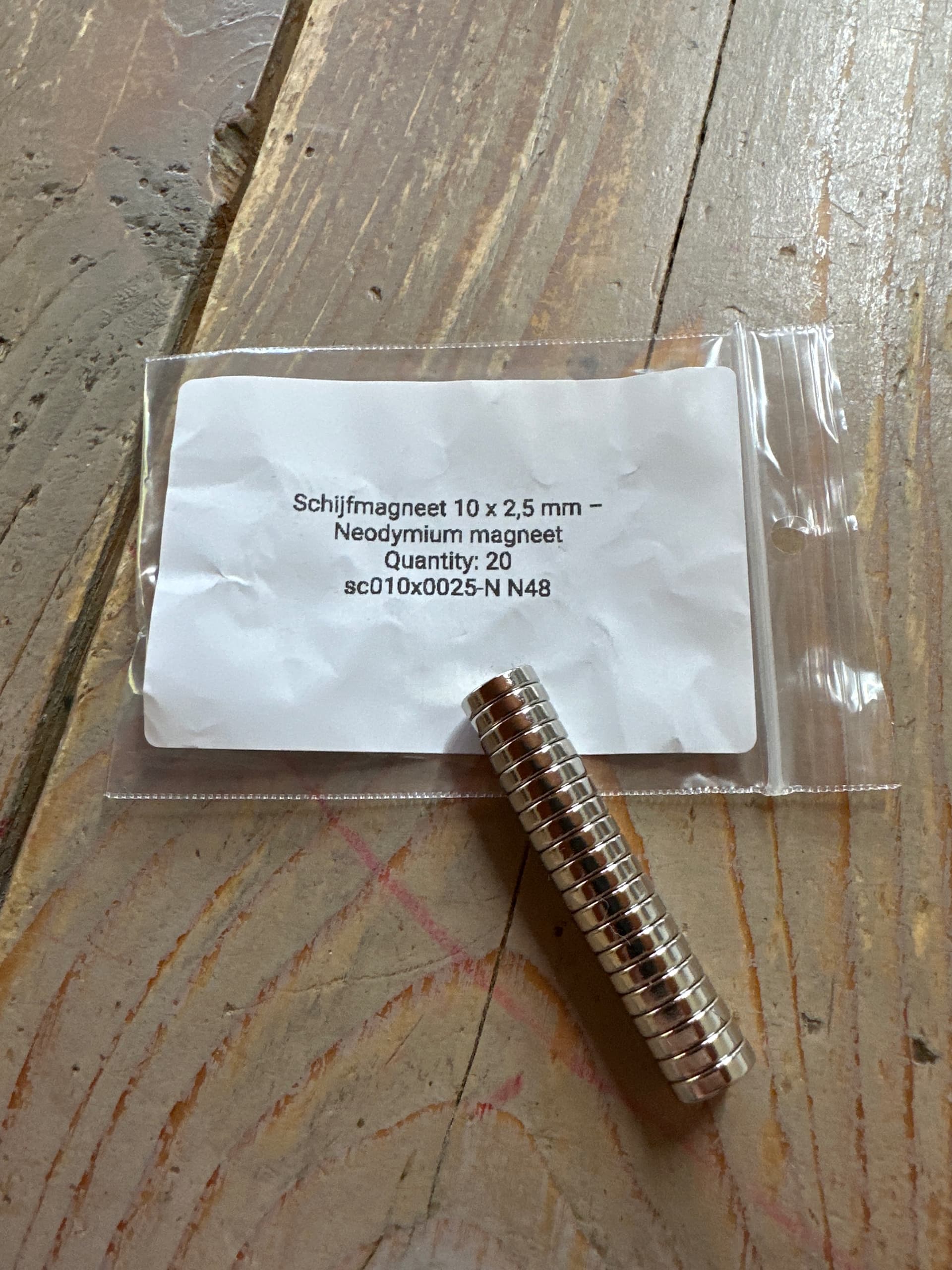

You’re doing it in that photo. They stick together? Then they are working.
If you want to measure strength, oppose the poles on two and push them together. How hard they resist is an easy way to gauge strength.
Also, the easiest way to mark poles? With the magnets all stuck together like in the photo they are lined up N/S/N/S/N/S. You don’t know which end is N or S without using a known magnet as suggested earlier (and ignored), but you know the faces alternate. You can go right down that stack and mark all the faces pointing the same way with a dot. They will all be either the N or S pole. Then align in the model and pair marked with unmarked.

Probably not. This is almost certainly because you assumed you had a simple North / South pole arrangement along the axis of your ring magnets, but they are actually something else.
Just like you assumed the “magnets” in the build plate are a simple orientation like having North facing up, and filling the printer with magenetic field. Which they do not. Like someone showed by holding that film up to the build plate, the build plate “magnets” are actually a plate of material with alternating lines of north and south poles. This is done because when you put the build plate on top the build plate ends up pulling 99% of those little fields into itself, creating a strong and even attraction over the whole surface rather than a few strong spots and nothing in between.
With the film you can also use the film to see for yourself that the kind of electric currents in a heating element barely register compared to either the build plate or even tiny neodymium magnets.
Using it on different things you’ll quickly find that most magnets are not made how you think they are. Probably including those ring magnets, which I suspect you “flipped” during installation by inadvertently rotating them in their sockets.
