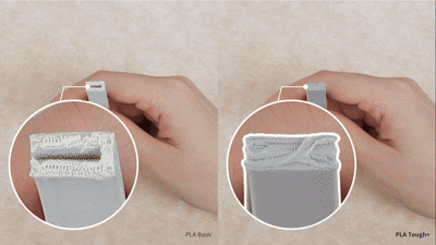

Withstands Repeated Flexing
Designed for repeated flexing, Bambu PLA Tough+ outlasts standard PLA where it typically fails. It’s perfect for prints that need to bend without breaking—like springs, clips, and connectors.
