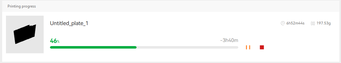

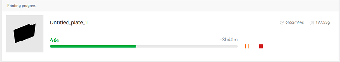

In bambu studio?
Do not hit ‘send’ or ‘send plate’ but the arrow left before it and select print plate.
Then be patient as the file is sent over the cloud, unzipped, prepared.
Then the pre heating and calibration starts
After about 9 minutes or so the actual printing will start.
Status can be checked in Device tab
