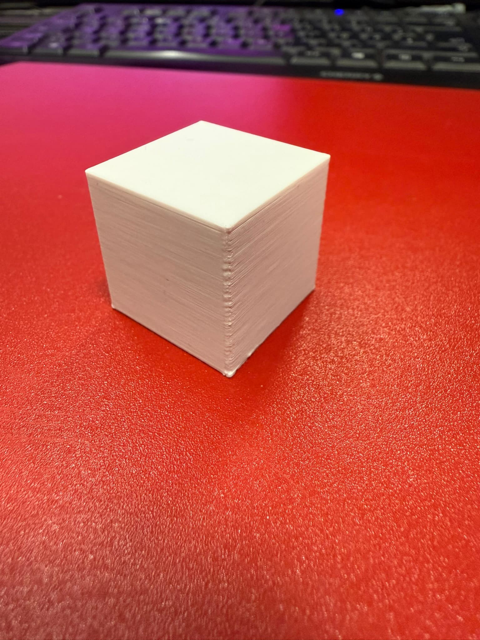

We recently purchased the X1E for our company. The PLA prints came out great—impressive quality and very fast.
Since our prints need to withstand disinfectants, we wanted to start printing with PETG. I ordered the PETG HF in white directly from Bambu, but the first prints were really disappointing. To test further, I tried printing a simple cube.
After reading some tips here and online, I increased the print temperature to 270°C, but it didn’t improve.
The filament was dried on two consecutive days for 12 hours at 65°C.
I used the 0.20 profile and made some adjustments I intended to do anyway (Arachne, outer walls first, infill gyroid), but these changes didn’t affect the print quality and the defects are still the same.
Using the textured PEI Plate but this should not change the wall quality I guess. First and last layer look really good.
Autocalibration was also done.
Any ideas?
Could you please confirm if the Z seam position is set to aligned?
If the position is set to Random, the issue you shared in the picture might be linked to this.

Thanks for posting a clear picture, this helps a lot.
My first reaction here is that it looks like this is more of a calibration issue. My experience with the default Bambu factory profiles are mixed and I’ve found that one can benefit from manually calibrating the filament. In this case, I’m seeing flow issues in your model. I would recommend three calibrations steps.

I set it to aligned, and it really made a big difference, but I still don’t think the seams are very good.

Now that the source of the problem is identified, you can simply do the Flow Dynamics and Flow Rate Calibrations in Bambu Studio, most of which is automated.
I also recommend ensuring you are using the default filament profile settings, as they were fine tuned for best results. Considering that you have changed the location of the Z seam, if you changed other settings in the default profile, it could impact the print results.
Try using the default settings first as a test, before trying any other calibrations or tests.

Okay, I did the calibration and used the standard profile “0.16 optimal”.
I turned on supports and gyroid infill.
The results are much better now!
