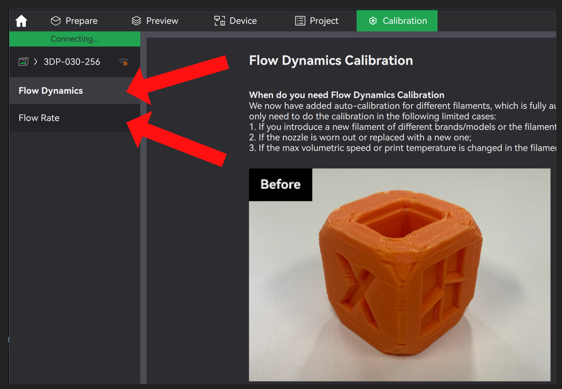

If you’ve replaced many parts, it’s a good idea to reset the printer to its factory defaults and recalibrate it. It’s possible that your printer is still calibrated for the old parts. You don’t necessarily have to do it, but I personally would start with that.
To rule out the AMS, I would try not to use it - if possible - and simply hang the spool on the external mount for the time of calibration.
So, step one: Reset the printer and perform the printer calibration.

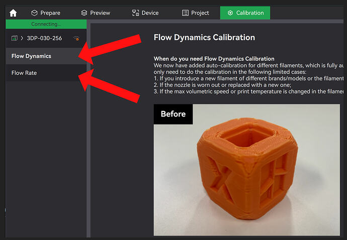

Step two: Perform the separate calibration in Bambu Studio:

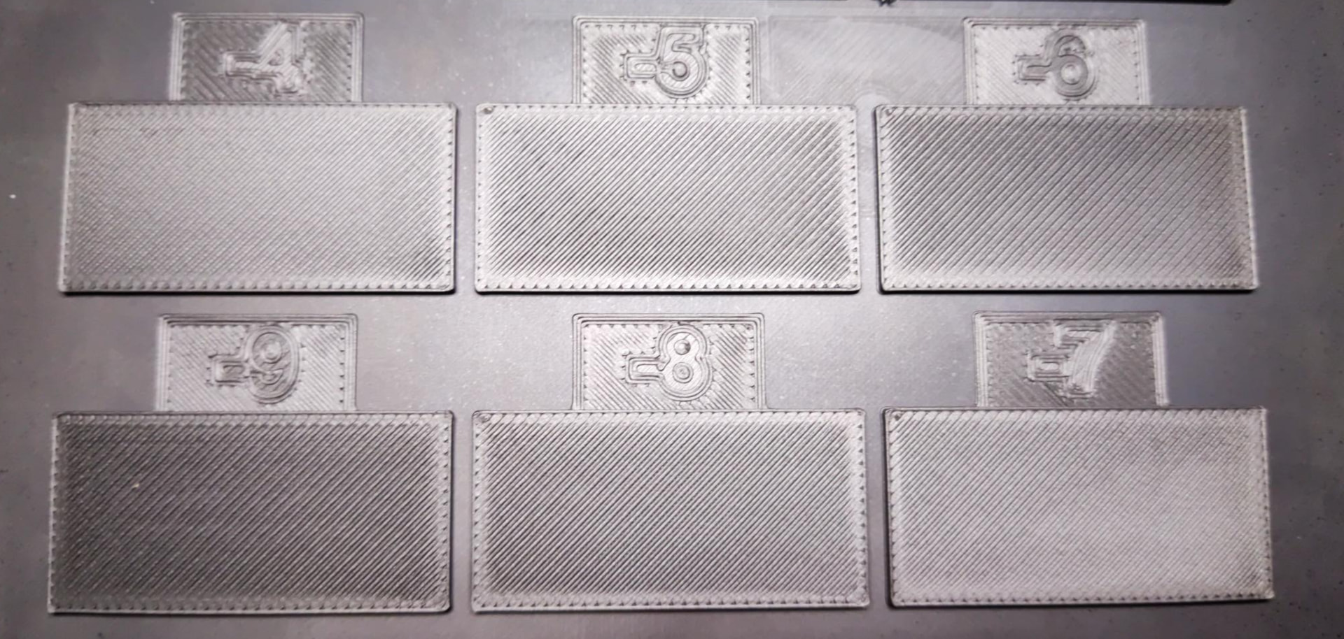

Then check the result: it should look something like this:
This doesn’t address your actual problem yet, but at least it gives us some common ground. Please take a photo of what the calibration results look like - that often helps identify the problem. Also, whether the filament feeding problem occurs during calibration!
