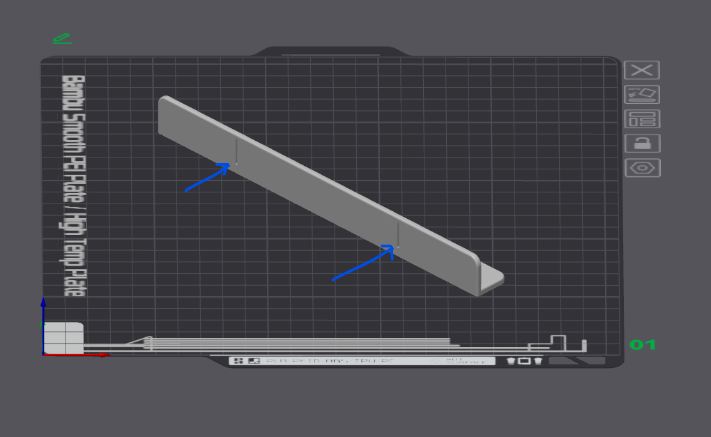

These are areas/cutouts that break up long sections of the model which help to control warping. Not always possible as they can comprise strength.
I haven’t experimented with larger layer heights but I’ve found some models seem to warp more with lower (.08-.12) heights. Generally I print at .2 as a base line and then experiment with lower layer heights.
