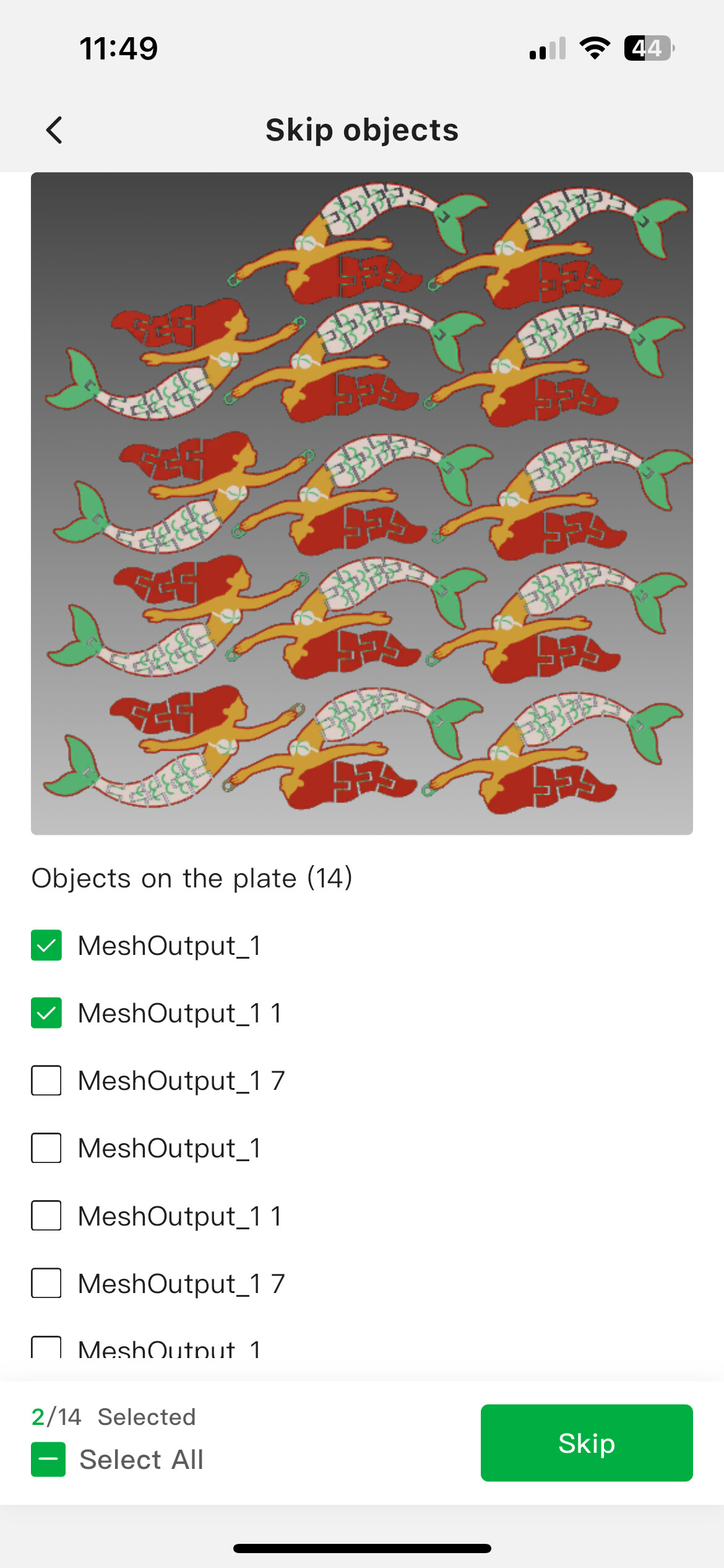

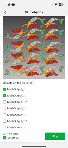

Not allowed to skip a failed object while printing
Hi to everybody. I found solution on my A1 and P1S printers - it is not to use timelapses. When thay are switched off - i have no problem with skipping objects during printing.
This seems to be the issue. I will test this again after I figure out what to do with this 48 hour print paused halfway because 2 a few of the parts popped off the bed.
No Timelapse
Tried pausing before
Uploaded via cloud
I can’t select a object nor I see wich object is checked.
