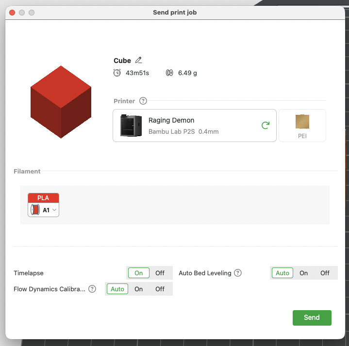

Flow Dynamic Calibration
Auto Bed Levelling
I’m new to P2S, only had it for few weeks now, but I find the bed adhesion to be excellent across different PLA, PLA+, PETG filaments I used.
However, I always keep the flow calibration and bed levelling set to auto - so far never had any issues.

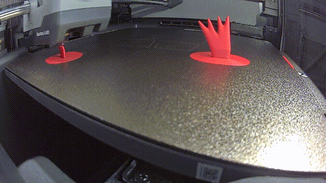

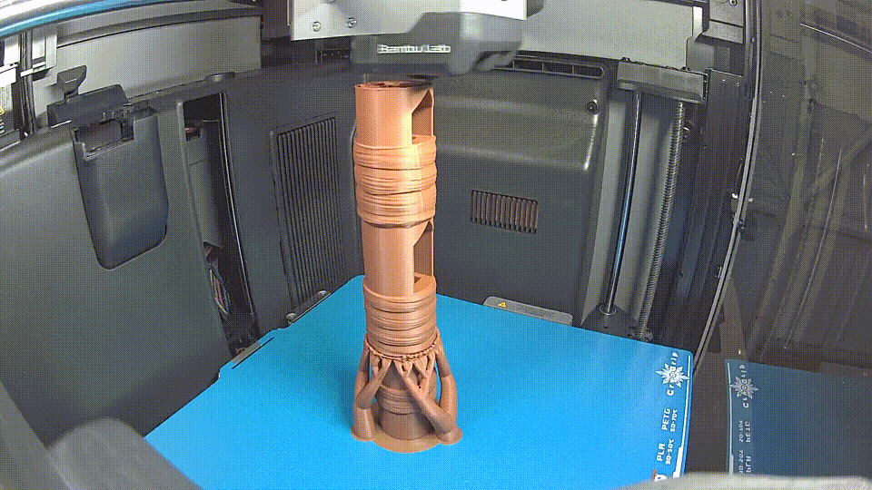

Alright, so I am attaching a couple of videos to show what happens. The quality is limited as there is a max upload size of 5MB.
Bambu PLA Basic Brown on BIQU CryoGrip Frostbite (no magigoo):
frostmourne-hilt-failure
Tinmorry Black PETG-Eco on stock textured PEI plate (with magigoo):
ams-hub-a1-failure

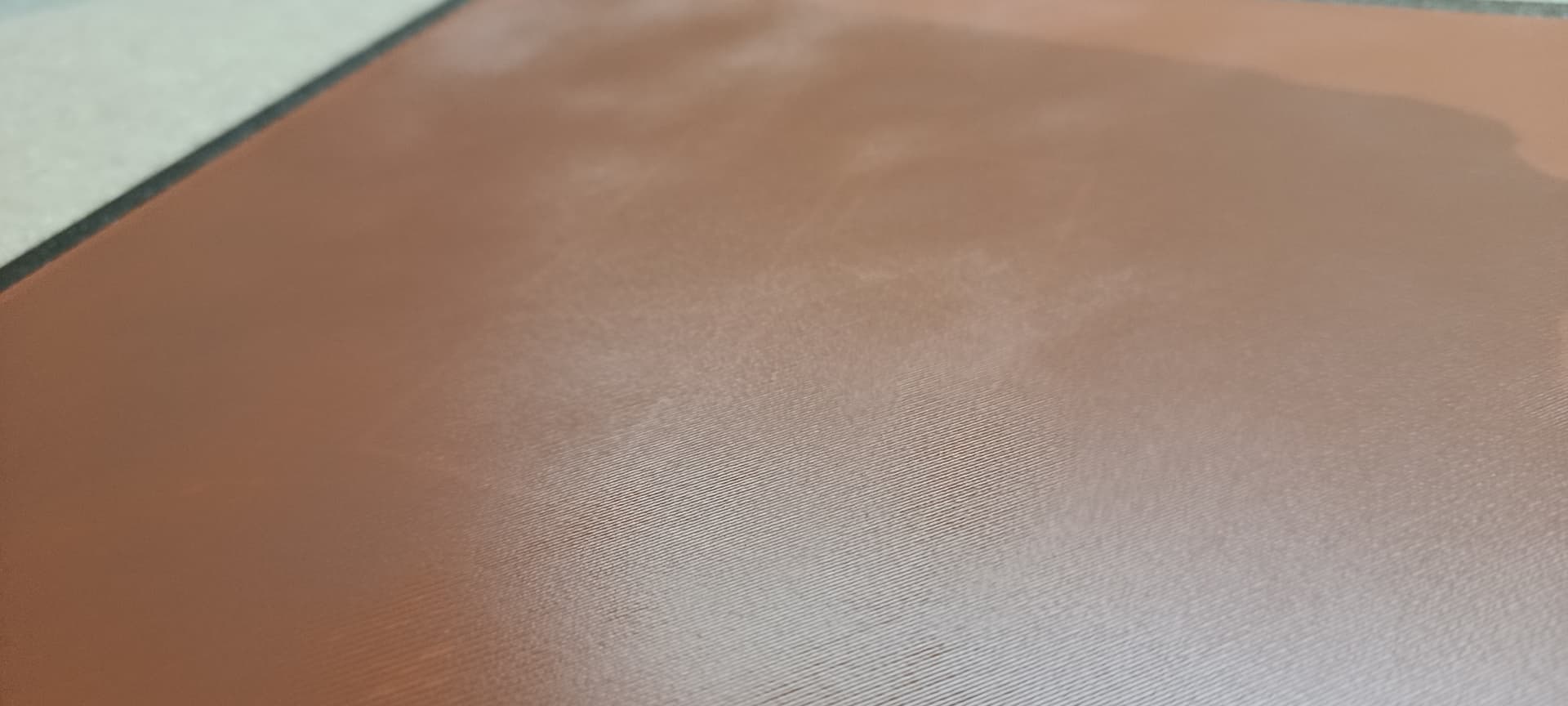

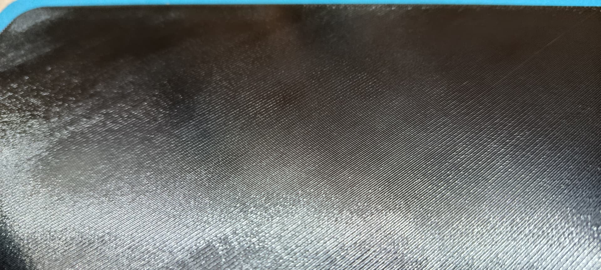

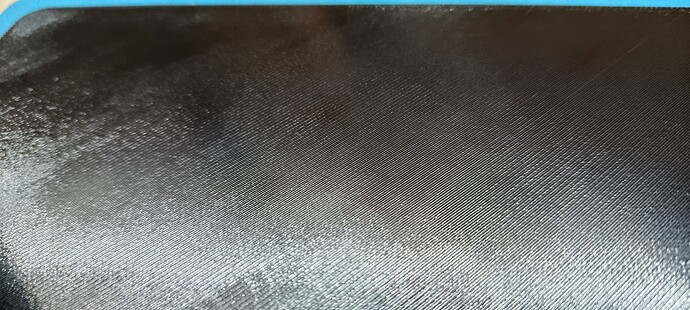

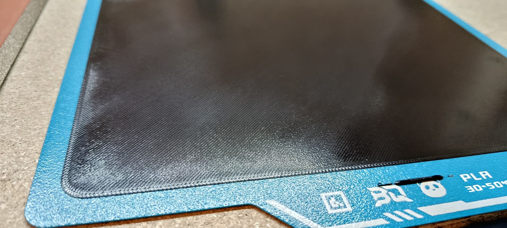

I just run a full-plate first-layer test, but it looks pretty flawless to me, at least on the brown (you may see some uneven areas, but that is where the glue is, and it was out for a while so the outer part started to release with the cold air). I am attaching some photos (same filaments as above, same plates as above). The only thing, for PETG, the bottom-right corner came undone a bit as I was lifting it with a scraper, but that corner was not involved in any print failure.
After this test, I also unscrewed the ceramic heating assembly seat and re-screwed it in after making sure all screws were tightened (they were already). I also replaced the nozzle with a new one I had laying around and I am running a full re-calibration now, but I ran calibration multiple times already and the adhesion issues still occur.
I haven’t touched the heat-bed screws yet, because the first layer test seems to be of acceptable quality.

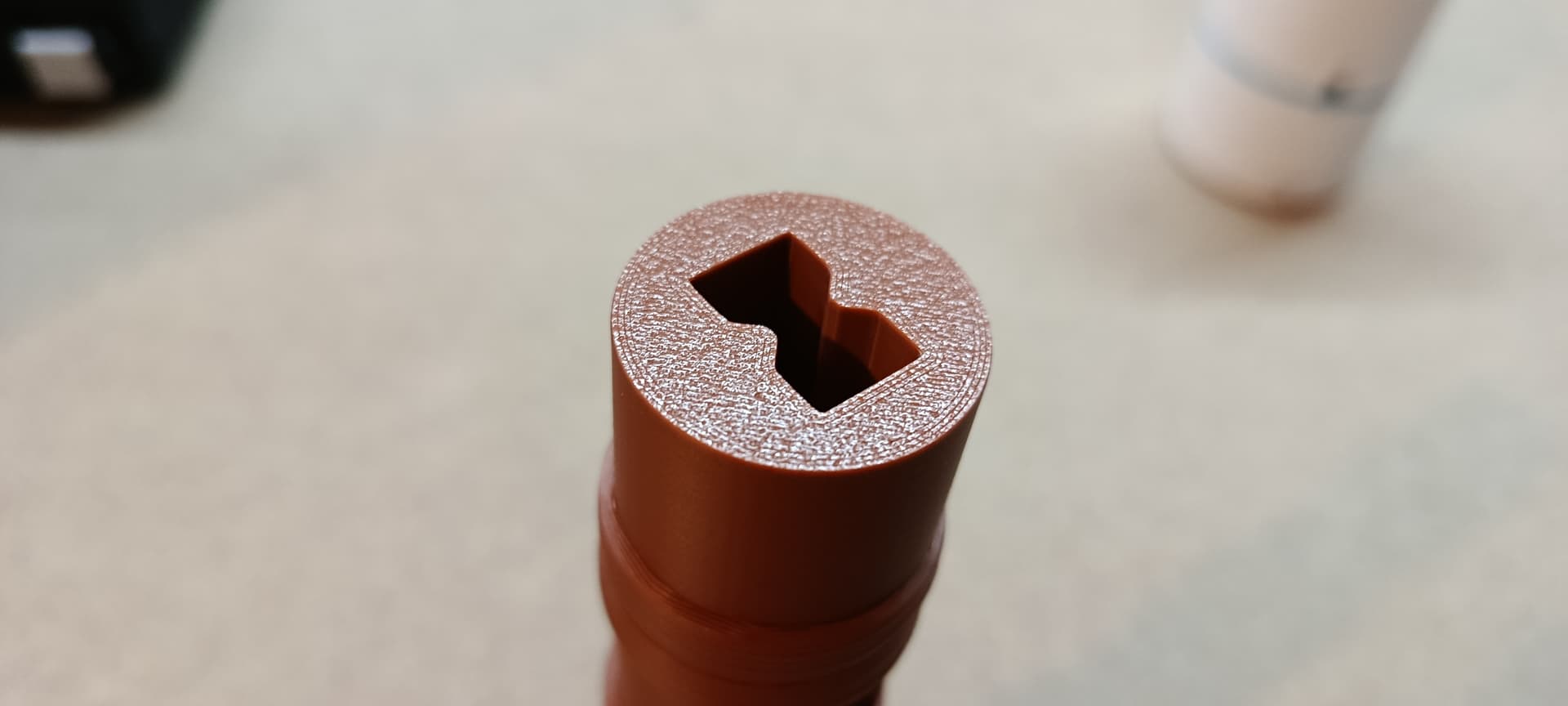

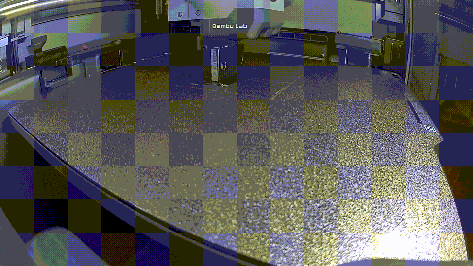

I eventually managed to print the hilt of that sword by manually adding a 4cm diameter 0.4mm thick disc as a new model part to the bottom of hilt, in addition to a brim. So the disc was printed as if it was part of the model and I had to carve my way through to uncover the hole at the bottom. A dirty solution that worked. Still, I think the issue is still hidden somewhere.
When it comes to extruding, I cannot see any visible signs of over-extrusion or under-extrusion, or any artifact of any kind, so I am doubtful whether the extruder is at fault. I hoped the first layer test would highlight some obvious fault and the z-offset would be the issue seeing as the brims seem to detach so easily, but I am not 100% convinced yet that is to blame.

Since its ripping off the item but the brim is staying attached to the plate I would try to change the brim object gap to 0 and increase its size, inner + outer. It will require some post processing but wont let go as easily.

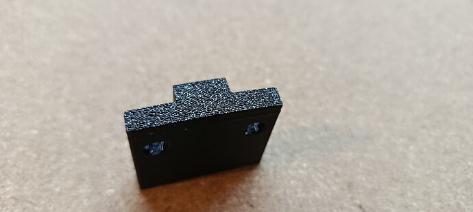

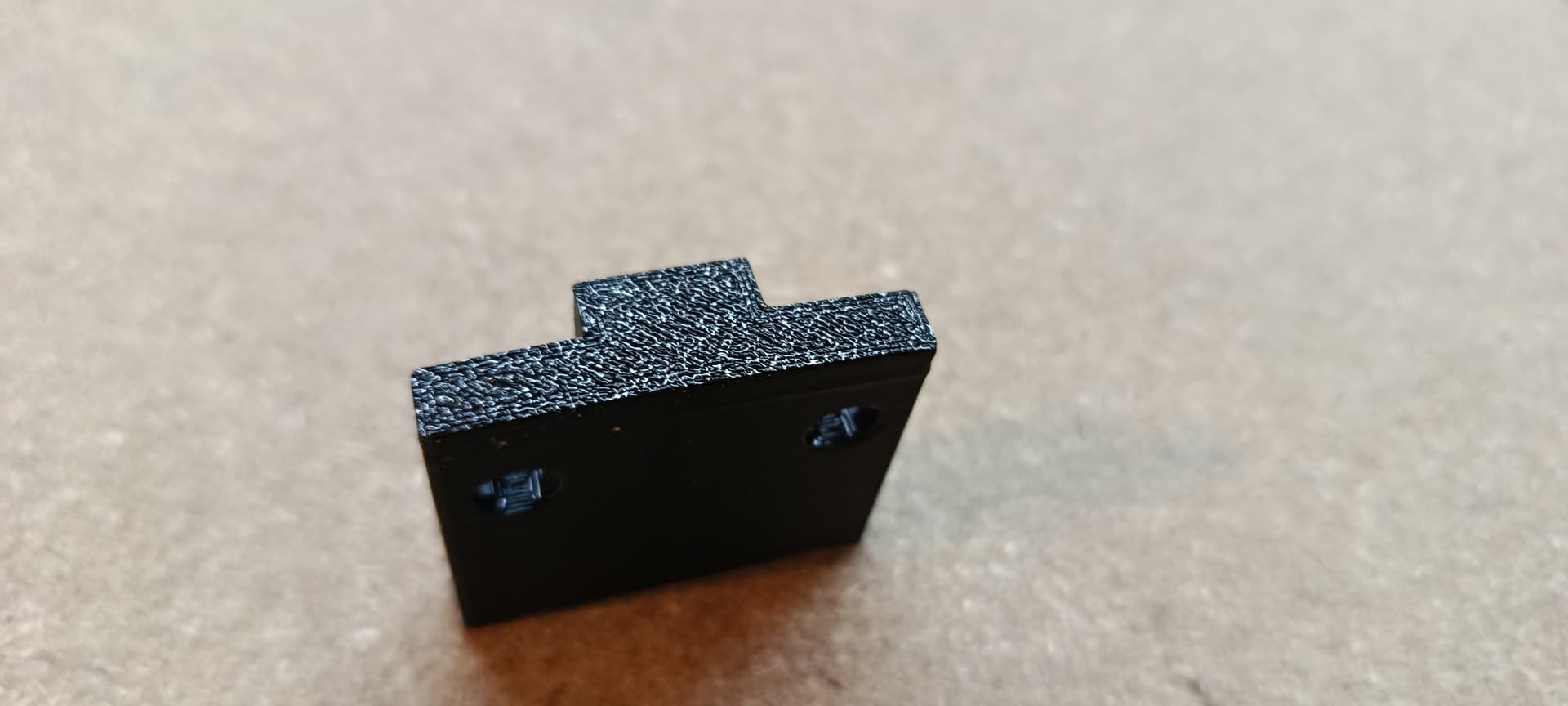

What does the underside of a print that detached look like? Interested to see if it has a good even squish or the layers are just plopped on.

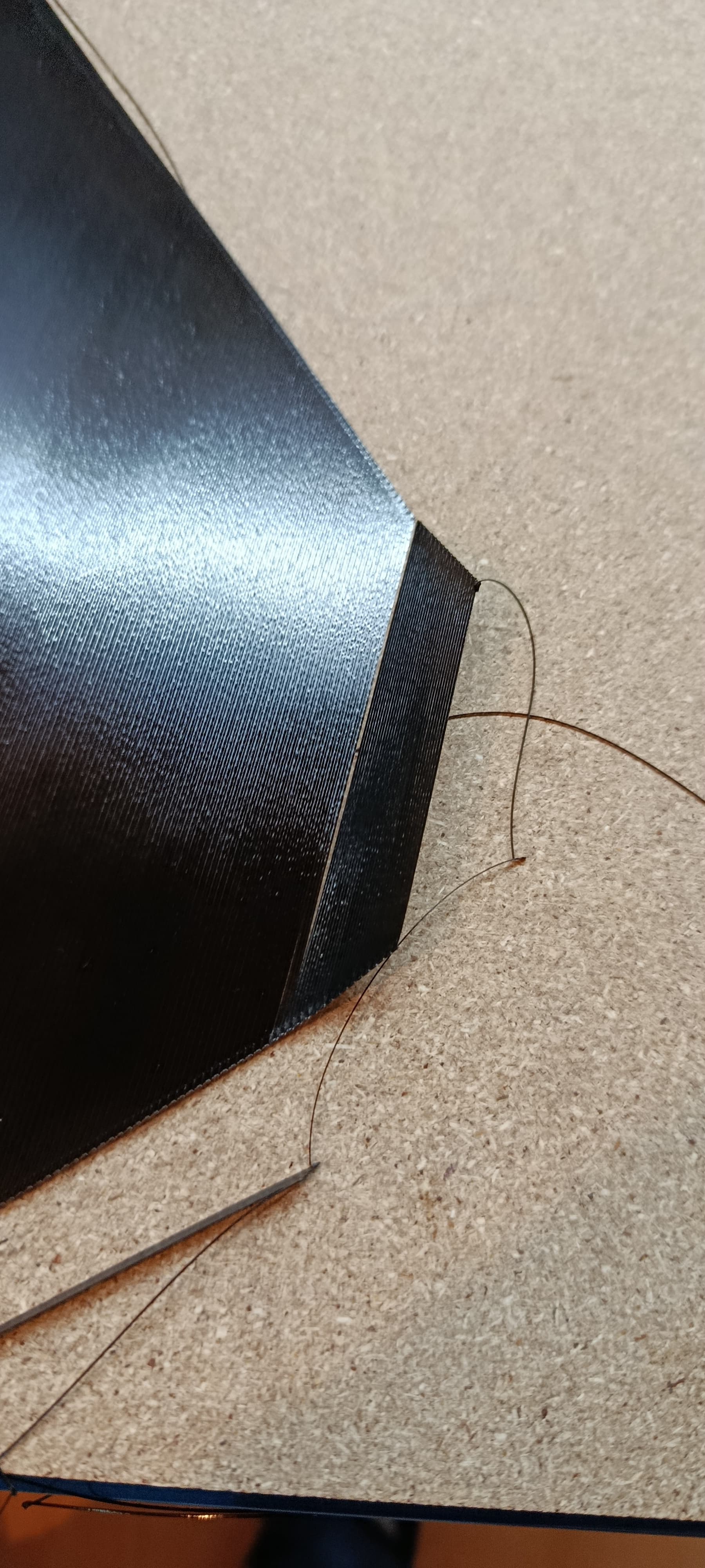

@Bullocks I am attaching a few pictures of the failed prints in the other gif. The underside looks ok to me.

Thanks for the vid’s. That does look quite different from what I had expected. It is a fairly common failure case for tall prints which is not (so heavily) connected to the build plate as is may appear.
Since the brims remain attached to the build plate while the tree brims come away clean, I doubt that you’ll have much luck working further on the build plate.
Instead, you may want to look at the following question:
  • What is actually causing thr sideways force responsible for the print failure?
    There are a few likely candidates:
  • A crossing infill like grid for sparse infill. Rectilinear works better. Honeycomb is my go to for tricky prints.
  • Although you mentioned that your filament is dried, in particular PETG is very sensitive. In fact, I find curling to be the first indicator of moisture in a filament. Well before stringing.
  • Sometimes, drying is not enough to prevent curling. There is one key property that you can control further using two parameters: Even out cooling by lowering the deposition rate (towards the top). You can use adaptive layer heights to reduce the layer heights and/or you can reduce the print speed. Since curling is a result of uneven cooling, these parameters allow you to even out heat injection (and thereby also the heat extraction rate), reducing curling.

To my eye the bottom looks ever so mildly too-high (0.01 - 0.02) but definitely acceptable and definitely should be holding.

I did have some success with tall prints, for example the following one, the guard of Frostmourne, printed in black Tinmorry PETG-Eco on the stock build plate with magigoo applied. This one has a cross-hatch infill.
frostmourne-guard
