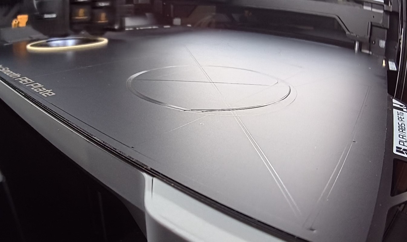

Quick snap from my live camera, this damage was caused to a perfectly intact smooth sheet after the nozzle blocker was folded back on itself resulting from automatic motions at the start of the print.
Prior to the crash, perfectly intact and aligned nozzle blocker, with no previous bumps or bends, good nozzles, normal Bambu material, nothing whack in the slicer settings (stock bambu preset). Most likely firmware to blame (or Bambu studio, either way, nothing the operator could anticipate as it happens very quickly even with personal check-ins for the first layer).
That entire quadrant is useless now, hopefully I can be expecting a replacement sheet soon :frowning_face:
