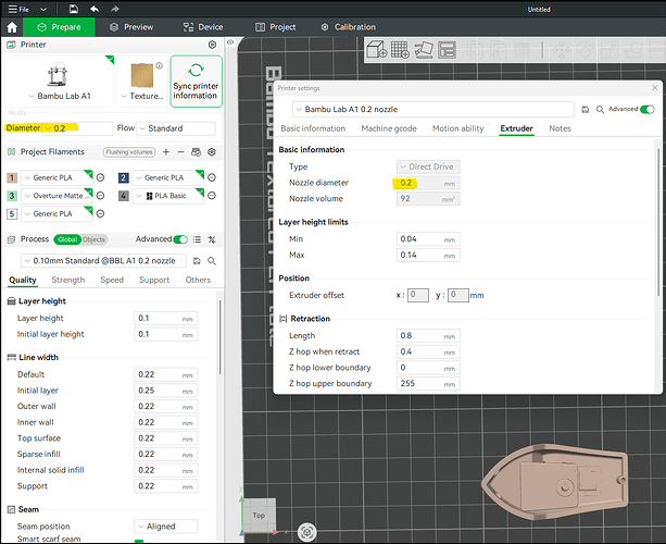

If you choose not to tell the printer which nozzle you have installed, you need to do this in the Device Tab of Bambu Studio.
You also need to set the chosen nozzle size in the Prepare Tab, as you are defining the project here, rather than the device.

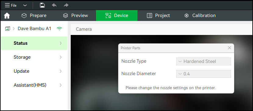

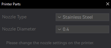

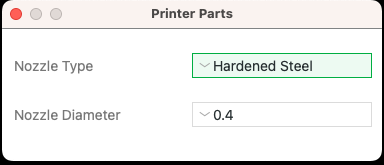

When I go to printer parts I get this:
I have seen this before when a misconfiguration has occurred.
  • Have you recently changed something?
  • Did you just change the nozzle size/type?

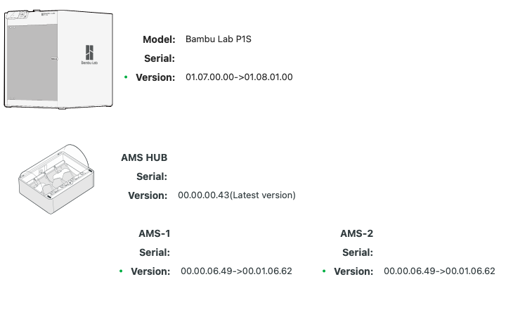

I physically changed the nozzle on the printer, but didn’t change any settings in Bambu Studio, that I’m aware of. I tried updating the firmware (which I was putting off) but it didn’t changing anything. Anything I should look into?

The screenshot is from a couple of days ago.

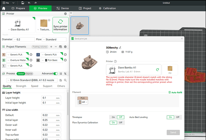

Even if I try to print a new print as .2 I get this error of the nozzle not being correct.

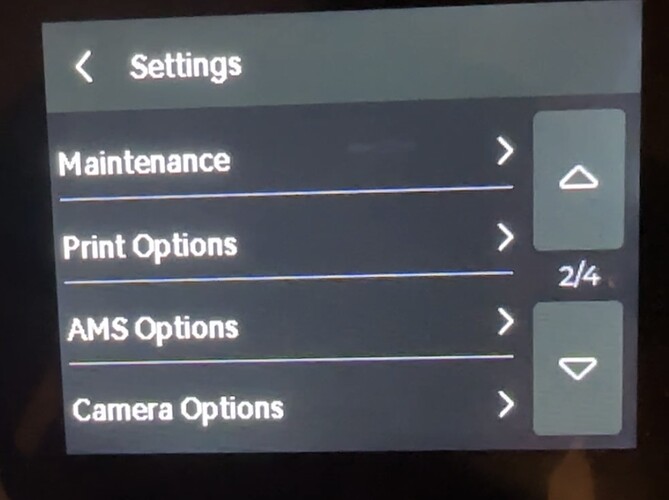

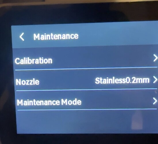

As a note, you CAN still update the nozzle size directly on the printer menu interface. More annoying to click through, but at least it’s not a complete show stopper.
What printer menu do you mean?

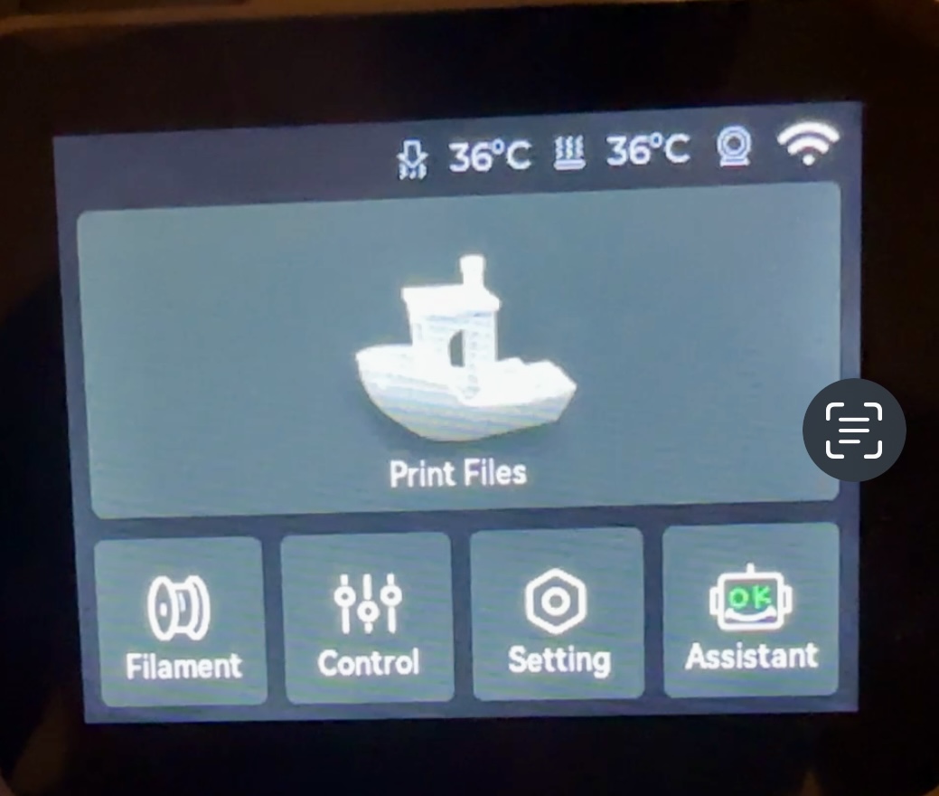

Hehe, found it ON the printer…

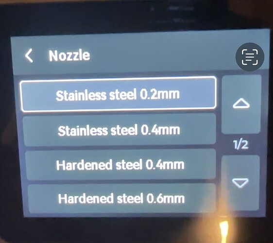

Okay I found the setting on the printer….I’ve never had to do this before
Click Settings
Click Maintenance
Click Nozzle
Select Nozzle size
