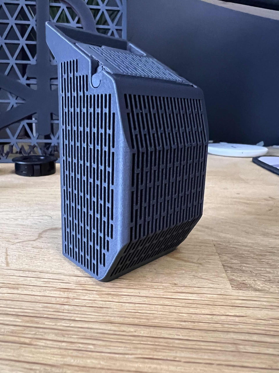

Just woke up to the completed print. And I must say, all though not perfect, it is much better!
There’s a few small marks in the outer corner side walls which to me look like slight layer shifts so I will try and retention the belts today. Also there is a very small amount of stringing in the lower layers which I am guessing is due to retraction. But overall a successful print. So thank you very much to all of you for your help and assistance over the past couple of days.
With regards to the retraction, I did try and carry out the retraction tower calibration model but got no stringing. Therefore I didn’t adjust any values. But I am thinking a little adjustment may now be good. Can anyone recommend any values for the retraction settings at all please?
Lastly, am I right in thinking that layer shifts are generally to do with belt tension or speed? Am I right in thinking this?

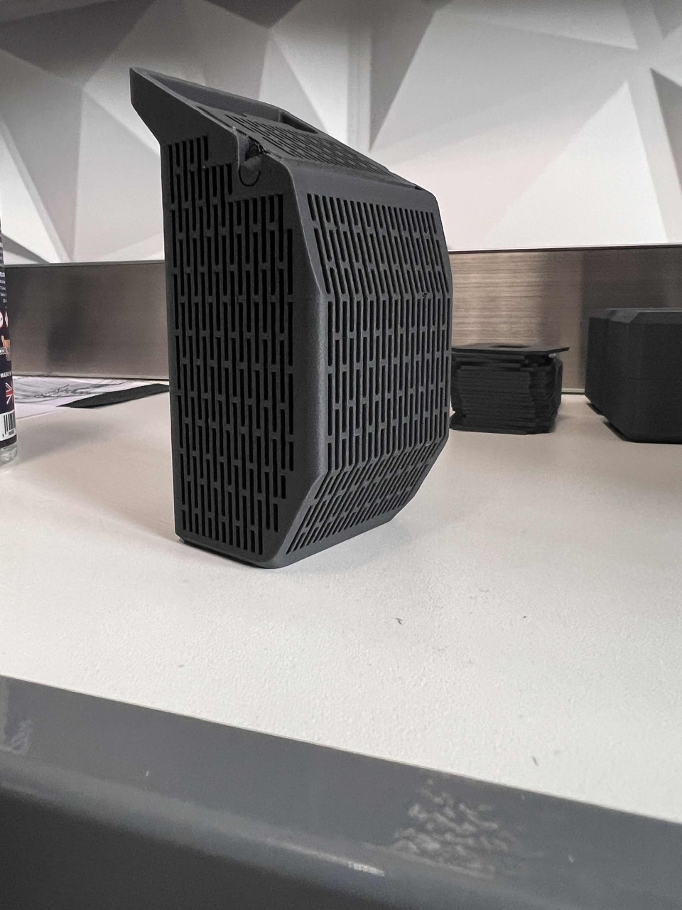

Here’s a picture of the completed model, printed at a 0.16mm layer height in Bambu Lab PETG CF.
Once again, thank you for everybody’s assistance and help with this. :pray:
