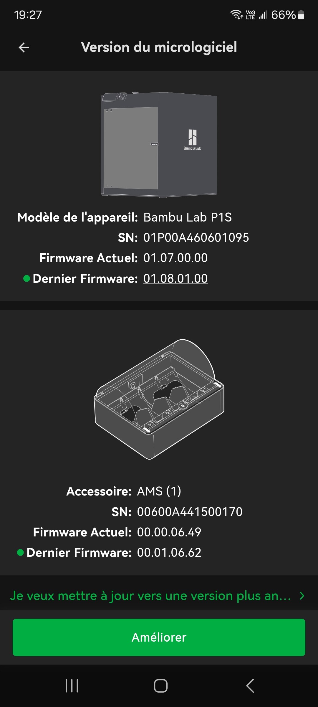

I tried the roll back as well and it made no difference. When I checked the printer it was still on the new version. Did yours actually roll back the firmware or just say it updated to the old version like mine did.
Here a screenshot
Screenshot_20250528_192715_Bambu Handy
I just got mine working by going back one more version to version 6 on the printer. That one took ok and everything is working again
