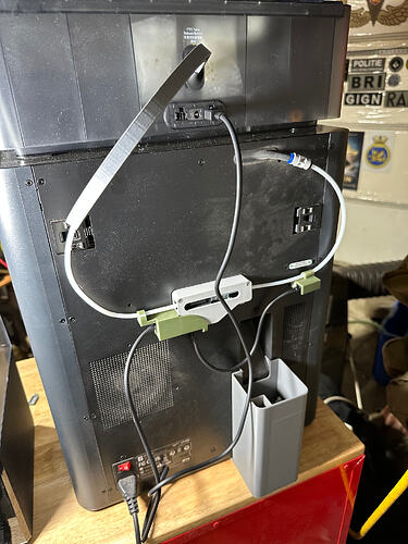

So I have a P1S and I purchased an AMS2 Pro. First AMS unit I got the filament would make it through the buffer and go about 1/2 way up the right side tube of the buffer then retract. Tried all three slots and got the same failed load. If I take the right side tube off it will clear the buffer and the filament will flow with no problems. I made a ticket and they wanted me to do some testing with a volt meter on the mother board. I was like ■■■■ no, send me a new unit. I sent the logs and videos of this issue. Crickets. But when I disputed the charge with PayPal that got their attention and I was sent a new unit. But when I connected it all I got the same problem. Any ideas or solutions would be appreciated very much!
a picture of the set up would help, but it sounds like the radius of the bowden tube is too tight or the coupling on the back of the printer is backwards, if it makes it that far. (Blue towards printer)
Thanks! I will post a pic. Very frustrating for sure.

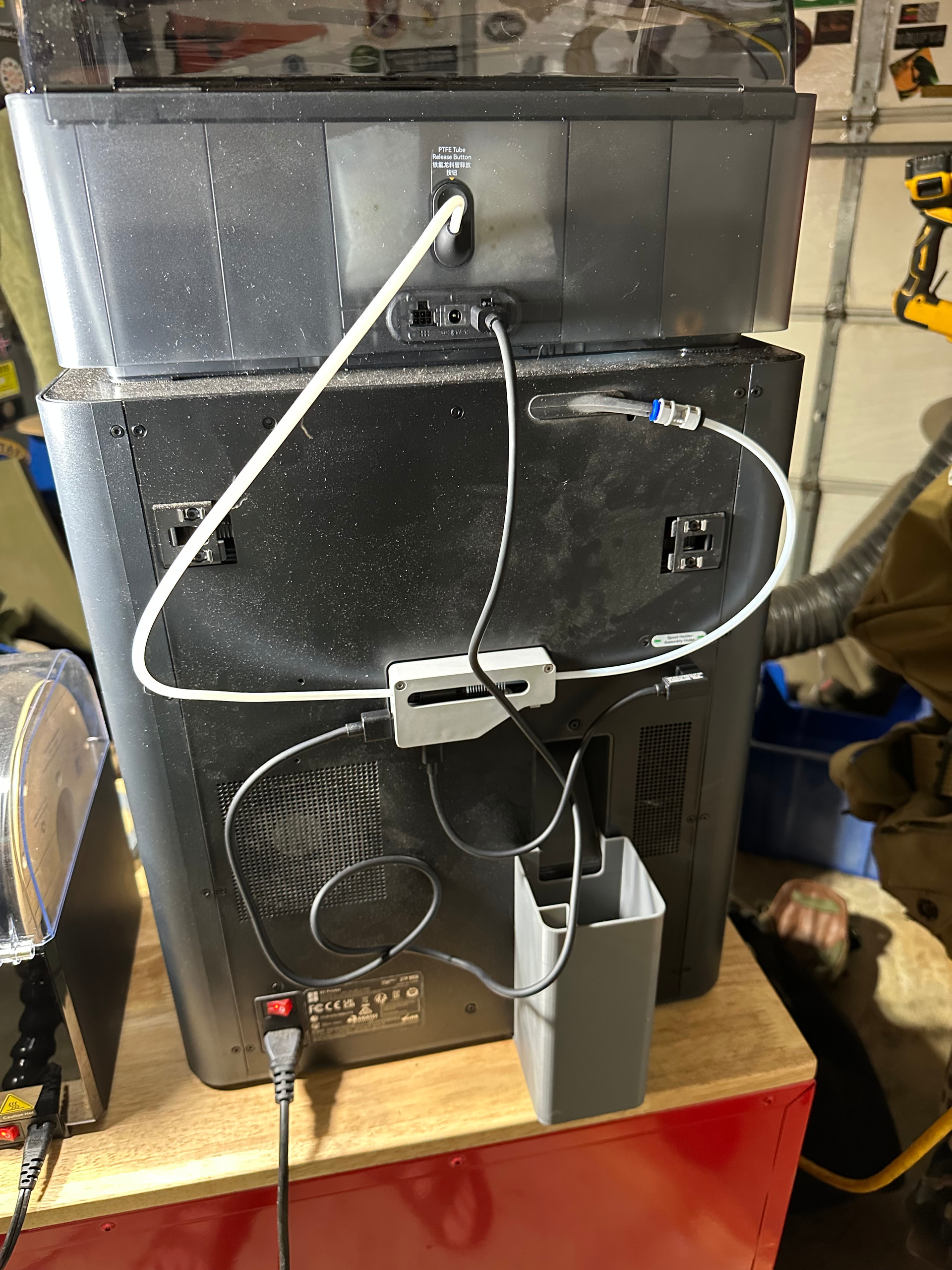

So it gets to this point and retracts
This is the second unit that’s exhibiting the same problem. I disputed the charge with PayPal and that got their attention. I might try the regular AMS instead. I cut that tube to see if I could get it to go further ie trying to rule out bad ptfe tube.
my tube out of the buffer is ~3x that long, I have the same combo. I’ve had two similar problem, once when I had the black/blue union backwards. The other when the tube going into that same union on a slight angle, just pushing down to get it seated fixed that.

that has some of its own issues, but you seem to have a more basic issue since 2 different systems did the same thing. Unless there’s a production quality problem with the new units, but can’t say if its the buffer or the sensor in the AMS.
Do you know someone that has one near you that you can borrow to test?
My brother in law has one but it’s a pain in the ■■■ to get it over to him unhook all his stuff and hook it up. Thanks for your insight! Probably gonna go with the regular AMS.
Got my first AMS2 hooked it up to my P1S and the filament would make it through the buffer only to make it half way up the exit PTFE tube and retract. Went through the nut role with their CS. Send pics, send logs, send videos etc. They even wanted my to test something with a voltmeter. I put my foot down and said this was ridiculous. They finally sent a return label. Boxed it up and sent it back. Got another unit and same problem. At this point I want my money back. I’m waiting on a response….. so very frustrating. What got their attention is when I disputed the transaction with PayPal. I have had to do that again. What a shame. They can do better

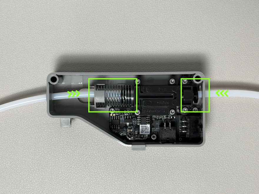

Above all, you need to make sure you order the right accessories for the AMS2 & P1: a filament buffer (SA003), a PTFE tube connector (FAZ006). Every printer needs a different filament buffer

Have you checked out the Wiki yet? What they suggest? I don’t know what you’ve already tried, so I’m just asking the basics. Does your setup look like this?
Also, make sure the tubes are deep enough and secure. They should also be cut cleanly, not at an angle.

Make sure your buffer spring looks exactly like the one in the photo above and not asymmetrically bunched up/slanted as if it is caught on one side.
I’ve also had trouble when I cut a tube with scissors and the end pinched into an oval shape. It was just enough to add a little drag. I re-cut with a razor and that solved it.
By chance are you using your own PTFE tubes instead of the ones that came with the printer?
I will echo @RetroSharky ‘s original comments, it’s exceptionally uncommon to see this issue once, much less twice. This sounds a lot more like something systemic in how you’ve set up the equipment. Do you have the PTFE tubes absolutely, positively inserted 100% into their receivers?
