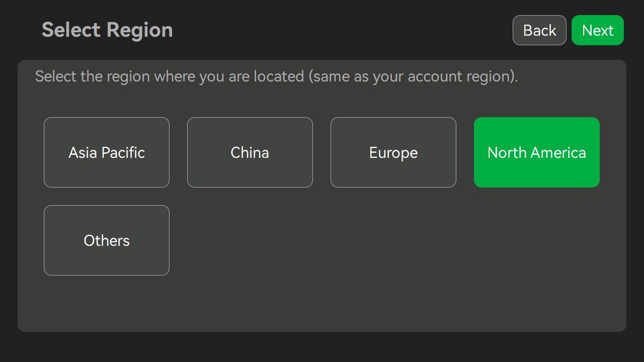

Does any one know or remember when one sets up the initialization if it asked you what country you were in? I ask because that’s usually when the frequencies are locked into the Wi-Fi.
Does anyone know of an external way to upgrade the firmware without calling back to the mothership? I looked for one out of curiosity and it was one of the glaring omissions for support. I consider it a poor design to not allow for manual updating, especially if it’s the Wi-Fi you’re trying to upgrade/recover. Either way, that might be a back door to make a Chinese Bambu Printer into a Western Printer.
It does
But I assume the Chinese version doesn’t have this menu, although the reseller told me the menu is in English… interesting … Why would the Chinese version have the menu in English if it isn’t intended for export ???

My guess is that the Language selection is a global variable and isn’t dependent on location. Also this is a screen shot lifted from the Release notes. It has nothing to do with your question.
I think it has to do with difference in certification for that given area. “Others” probably has the least restrictions? Would be interesting to bind a printer/account to “Others” and see if the Wi-Fi signal strength is any different. You might have to use a vpn for Studio to link correctly?
