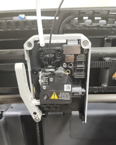

Hello,
I received my P1S and AMS combo yesterday. After a handful of small prints, the AMS cannot retract the filament from the toolhead. I am unsure what to do as the filament is stuck all the way in the toolhead. Isn’t there a mechanism that cuts the filament in the toolhead, what is it stuck on? The issue does not seem to stem from the spool failing to turn. I take it I will have to remove the toolhead’s bowden tube, snip the filament, disassemble the toolhead, and remove the filament from it to clear up this issue? Is there another way?
So if the spool is turning and the filament is still stuck, I am wondering if the filament is broken at the print head? If so, then just open the front cover of the print head, remove the PTFE tube and you should be able to remove the filament.
Try to excange the cutter, i think it will fix further problems with filament stuck in the extruder. Bambu lab recommends to exchange the Filamentcutter after 5 Kg Filament or after 2 Kg of abresive Filaments like CF

I know this has been awhile since anyone posted to this thread but, I’m having a similar issue with the toolhead. The filament seems to be locked in the toolhead. I disconnected the hotend and no filament was attached. Disconnected from the AMS by cutting the filament just outside the printer. Filament retracted to the spool no problem. Pulled on filament stuck inside toolhead, wouldn’t move. Followed your advice and removed the tube from the toolhead, pulled the filament back to the toolhead and pulled up on the filament. Will not come out. Moved slightly up and then stopped. I can push it down and it moves down the same amount and stops. I’m afraid to pull to hard, I don’t want to break and teeth or anything in the toolhead. Should I just pull really hard? Thank you for your time.
NVM. Removed the toolhead gear assembly from the toolhead and managed to get it moving by pushing the large plastic gear around till it moved passed a kink in the filament. Then the rest just slipped out.
