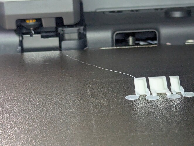

  1. First Use, Nozzle Wiping Performance: The nozzle wiping performance appears to be worse than the stock P1S. I have never even upgraded the wiper component on my P1S, and it has always functioned perfectly.

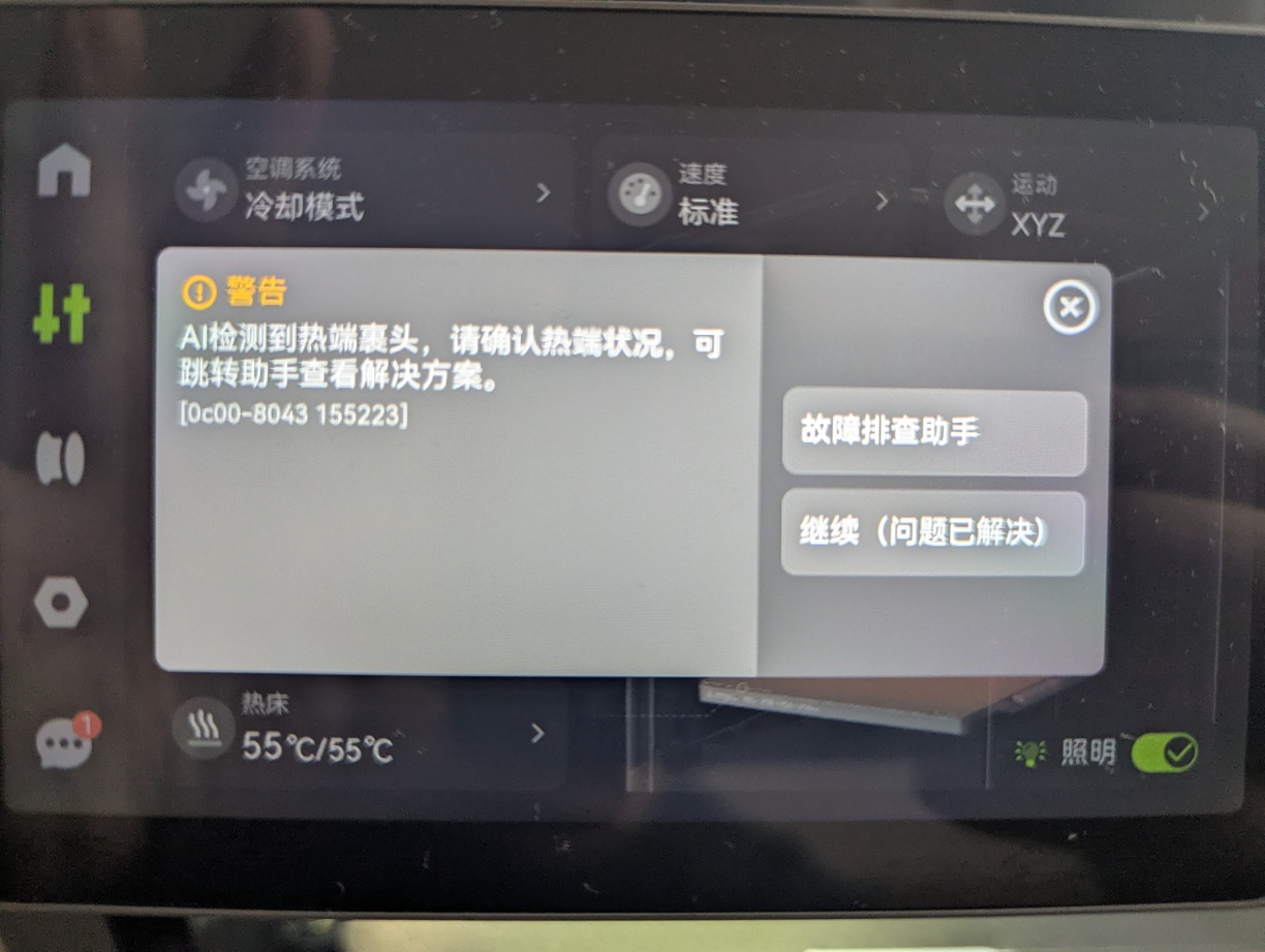

  2. Hot End Toolhead Clog/Wrap False Alarm (Misreporting): This issue occurs even after adjusting the sensitivity setting to the absolute minimum.

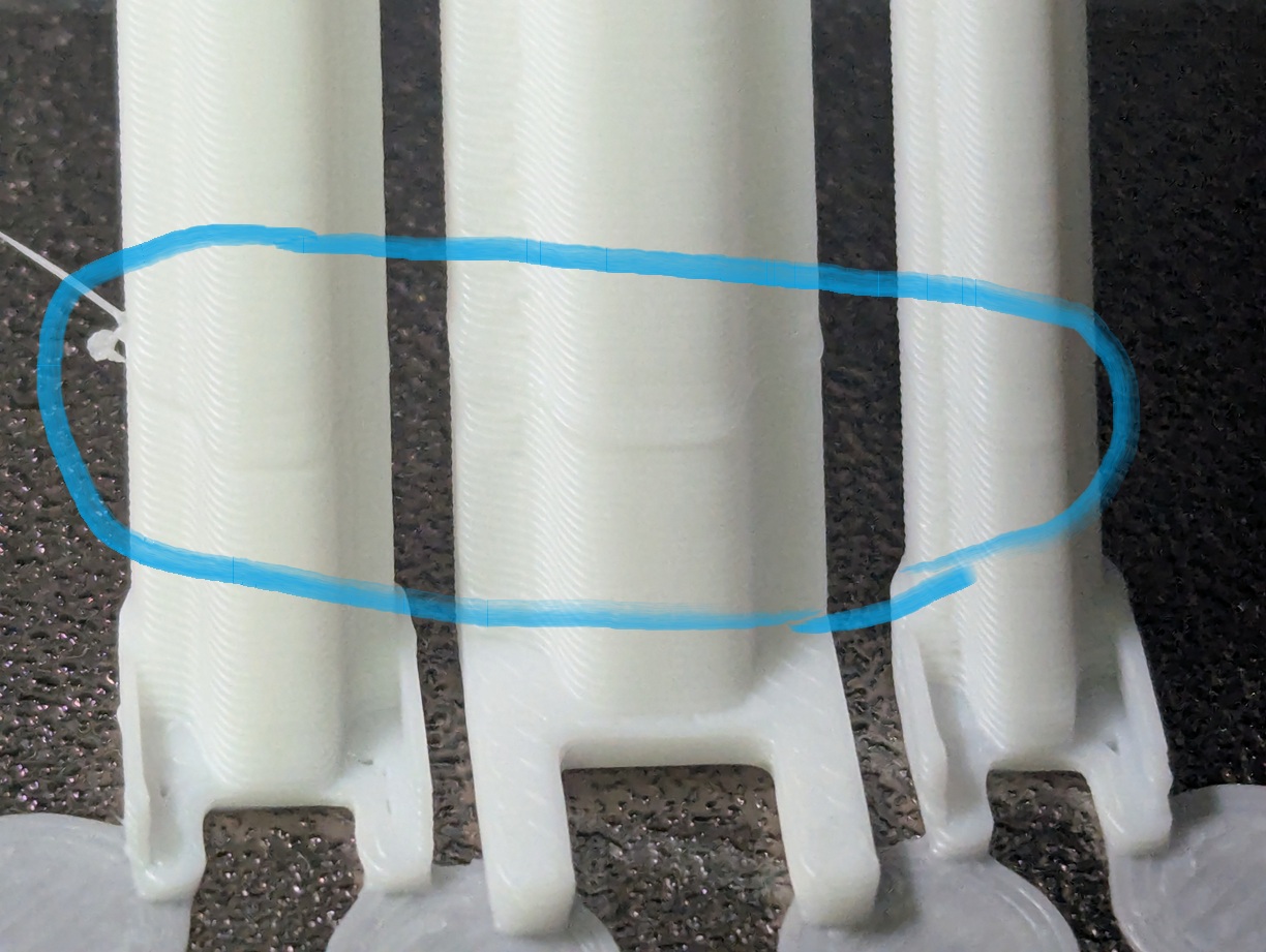

  3. Layer Shift/Displacement After False Alarm: Following a misreport, resuming the print invariably results in a significant layer shift or displacement.

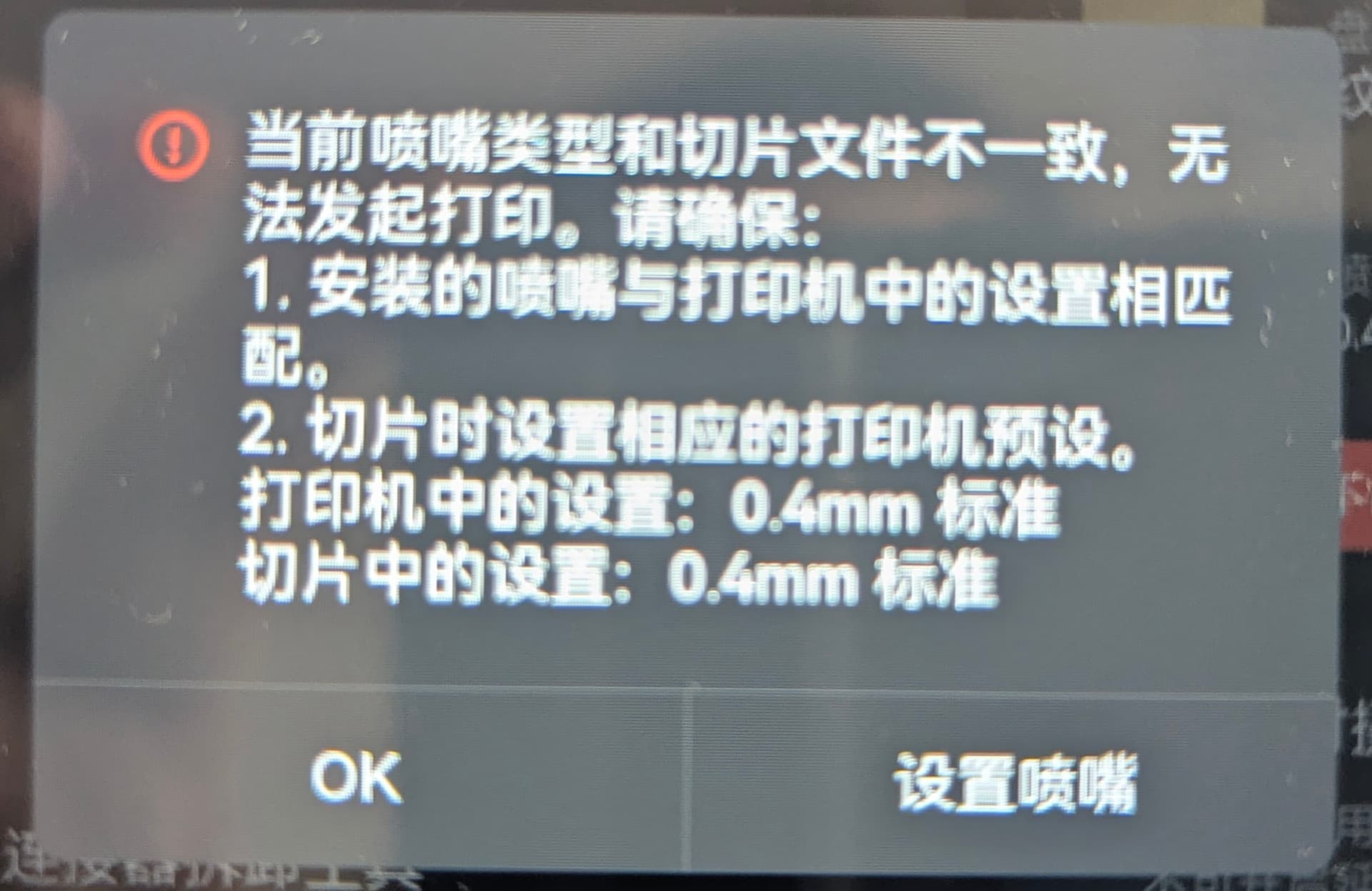

  5. Nozzle Size Misreport/Inconsistency: The printer is equipped with a 0.4mm nozzle, and the slicer requires a 0.4mm nozzle. Yet, the machine flags an error, stating these two specifications are inconsistent. Are these 0.4mm nozzles somehow existing in different dimensions?

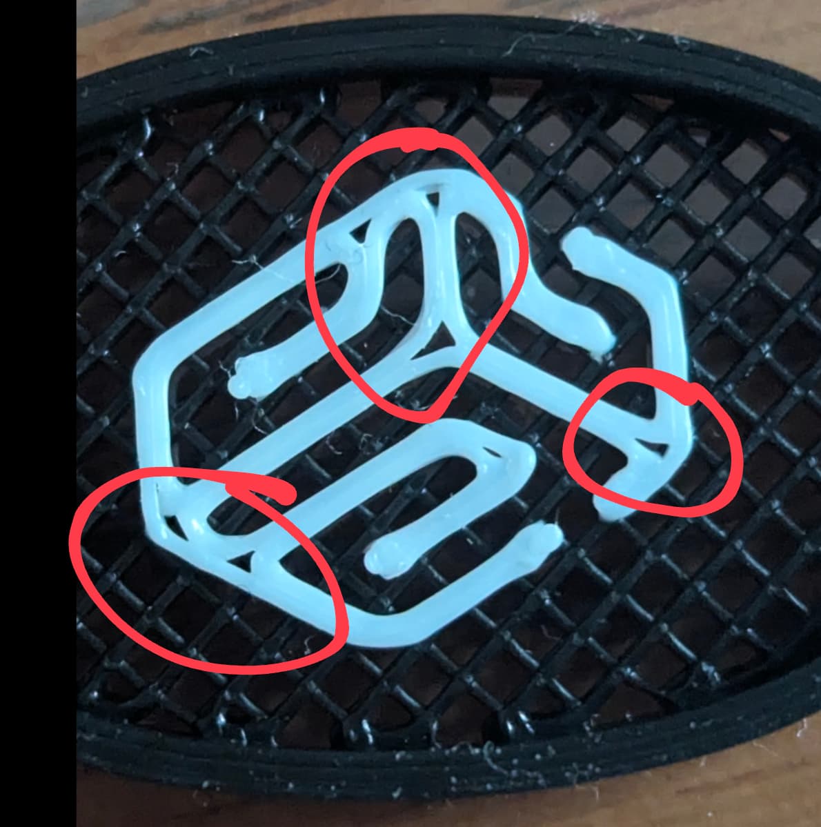

  6. I am constantly facing issues with stringing, stringing, and more stringing. (I do understand that this might potentially be a settings issue, but the premium price I paid was specifically to avoid having to deal with these kinds of problems. Furthermore, I never encountered these issues with the P1S or A1 mini—both worked flawlessly straight out of the box.)

Not a single clog/wrap alert, no layer shift, even after pausing and restarting a print some hours later, no alert about nozzle size neither (I already tried printing with 3 differents nozzles, 0.2, 0.4 and 0.4 high flow).

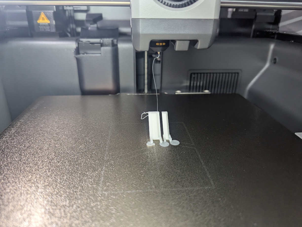

Point.1 : I face the exact same issue, the nozzle and the inside of the printer are way more dirty and messy than my previous P1S. The previous nozzle wiper might have been a noisy solution, but it seemed to work. In this printer I constantly have strands of filament everywhere, on the bed plate, on my parts etc… I think it can easily be improved by Bambu Lab by adjusting the starting sequence and the line flow calibration line.
Each time a print is ending it seems that the extruder is pushing down the filament just after it is cut, which creates a string below the nozzle. This string finish onto my plate at the very beginning of the following print.
