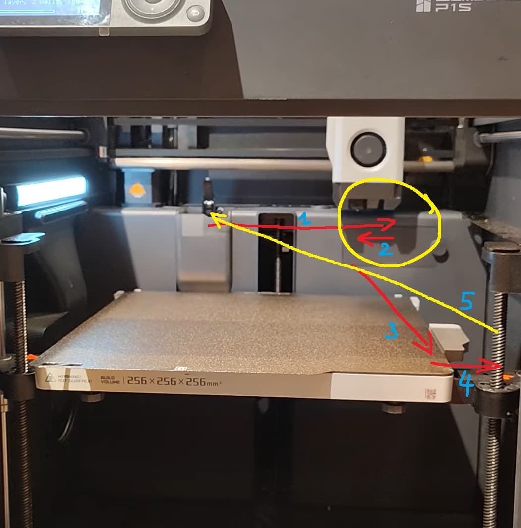

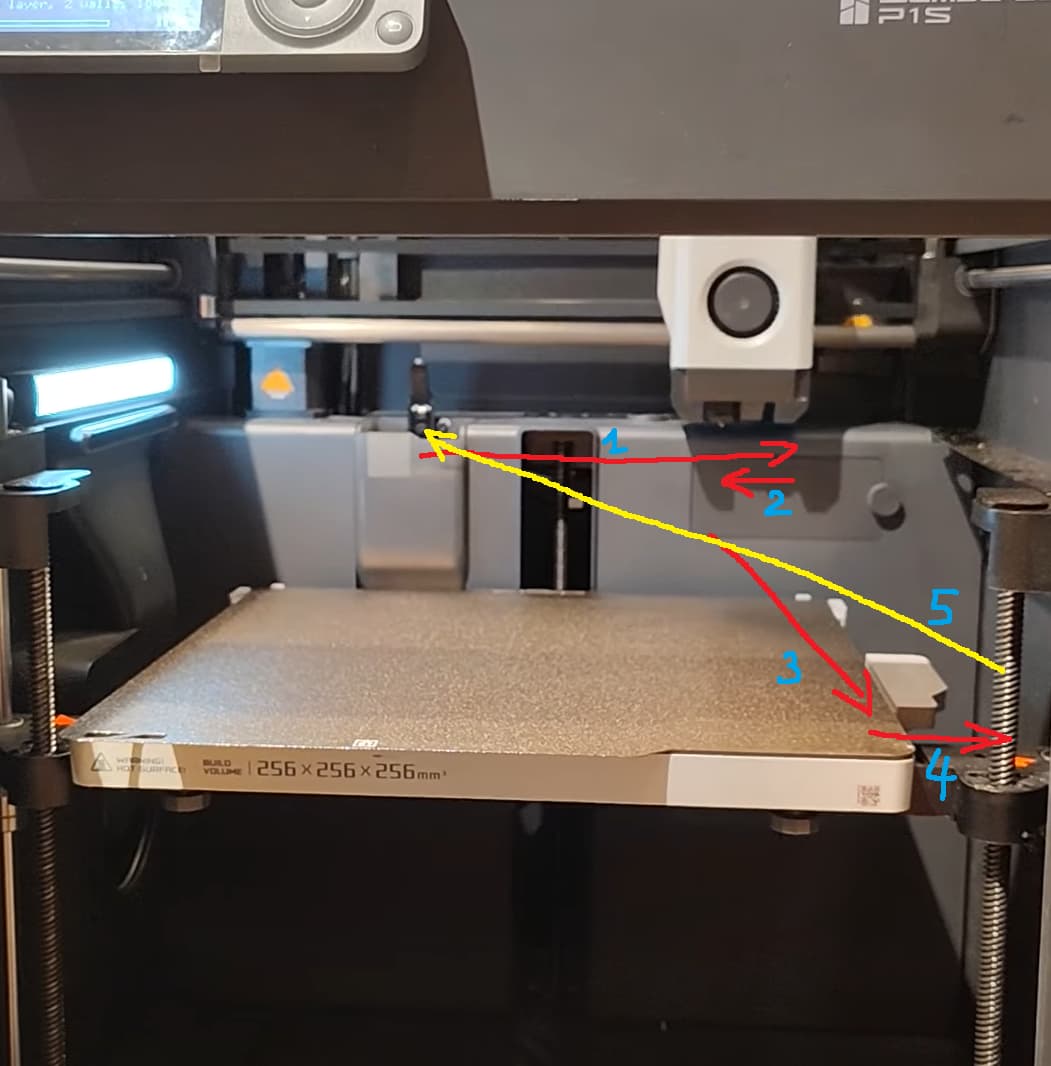

For everyone else, it does movements from 1–5 and repeat
What I think is, the tool head hits something while on path (1) then it reverses to path (2), to avoid obstruction maybe. It continues on homing with path (3), then (4) and (5)
Since path (4) was too long, it thought that there was something obstruct tool head on path (1) and considered homing failed, hence re-did homing again, and again.
Or else it is dancing for 3D Printer God.

Good news, I solved this problem by disabling the “Auto resume after lost steps” function. To do this, you need to:
1 - Go to BambuStudio
2 - Go to Devices
3 - Click on “Print Options”
4 - Disable the “Auto resume after lost steps” function
That definitely fixes the problem.

The question is, why lost step in the first place and only at that spot?
You treat the symptom but not the cause. It’s unlikely for your case but may cause layer shift due to step skipping.

This function is meant to perform a homing again if the printer encounters a problem and can’t find its zero position. For now, I haven’t had any issues since disabling this function, so I’ll just keep it that way.

The printer homes at the front right corner. If any debris is present in this area, it may restrict movement and cause the sensoreless homing to trigger incorrectly. As a result, when the toolhead returns to the purge chute, it uses inaccurate homing data, leading to a homing abnormality.
We recommend carefully checking the front of the printer to ensure it is free of debris. Small pieces of filament can sometimes get stuck, causing the X axis end blocks to push against them, incorrectly triggering the homing process.
The same can be done for the back of the printer.
Additionally, it is advisable to clean the carbon rods and re-tension the belts if this maintenance has not been performed recently.
