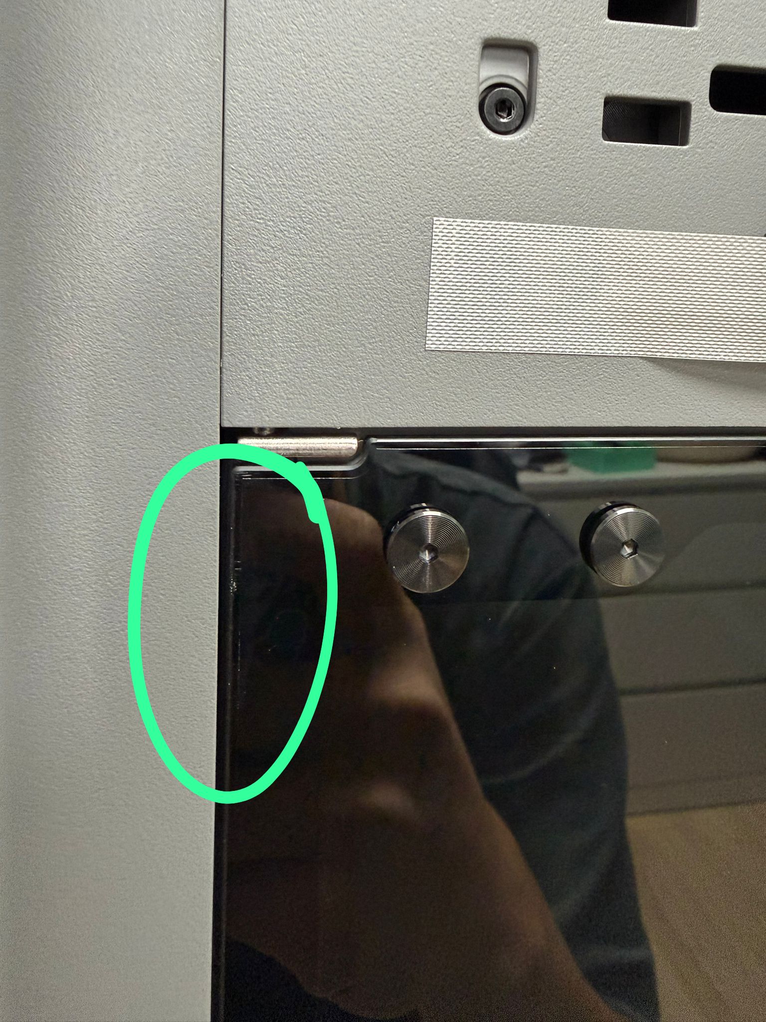

My p2s come on Monday after 5days of using.
Here are my issue:
  1. Top plastic cover resonances noise at certain speed
  2. Right side plastic panel deformation (convex) during high temperature print
  3. Scratchy grass panel on arrive
  4. MOST important issue the uneven heat bed , mine is concave about 0.5mm in the centre ,i can insert a card between the ruler and bed, totally unacceptable
    I am considering to return the machine and replace to H2S

It is same without build plate
It is minor defects, but still defect , I tried using IpA to remove but it didn’t work , it just scratched, I can feel it with fingers nails
I take the photos at cold , but it is same when heated
So the bed is just as concave when heated? I struggle to believe it would be exactly the same heated.
What makes you think the H2 series has better quality control than the P2S?
Whatever cold or heated , still concave.
I take more photo for bed heated to 55degree c
The gap is basically the same
H2 series had launched much earlier, they should fixed some common issue in early batches. But the P2S is like a pre production unit for beta test

That is most likely an acceptable variation under their quality control standards since the leveling system will account for that.
If you really want to. There is a older trick of putting foil under the plate to balance it out.
Is is actually hurting print quality? Probably not.

How would it do that? Every large, flat object he prints is going to be bowl shaped on the bottom.
I think you’re overstating things a bit there.
I’d only be concerned if it were functional prints.
Get a straight edge and check yours.
Yes, absolutely, it’s not going to matter if he is printing dragons, and most people print dragons (or something equivalent). But certainly people print things like helmets or models that aren’t “functional” but still rely on close tolerances to fit together.
To be fair, a helmet shouldn’t be in that area. I get what your saying, but I don’t think it’s the 5 alarm fire OP is making it out to be.
