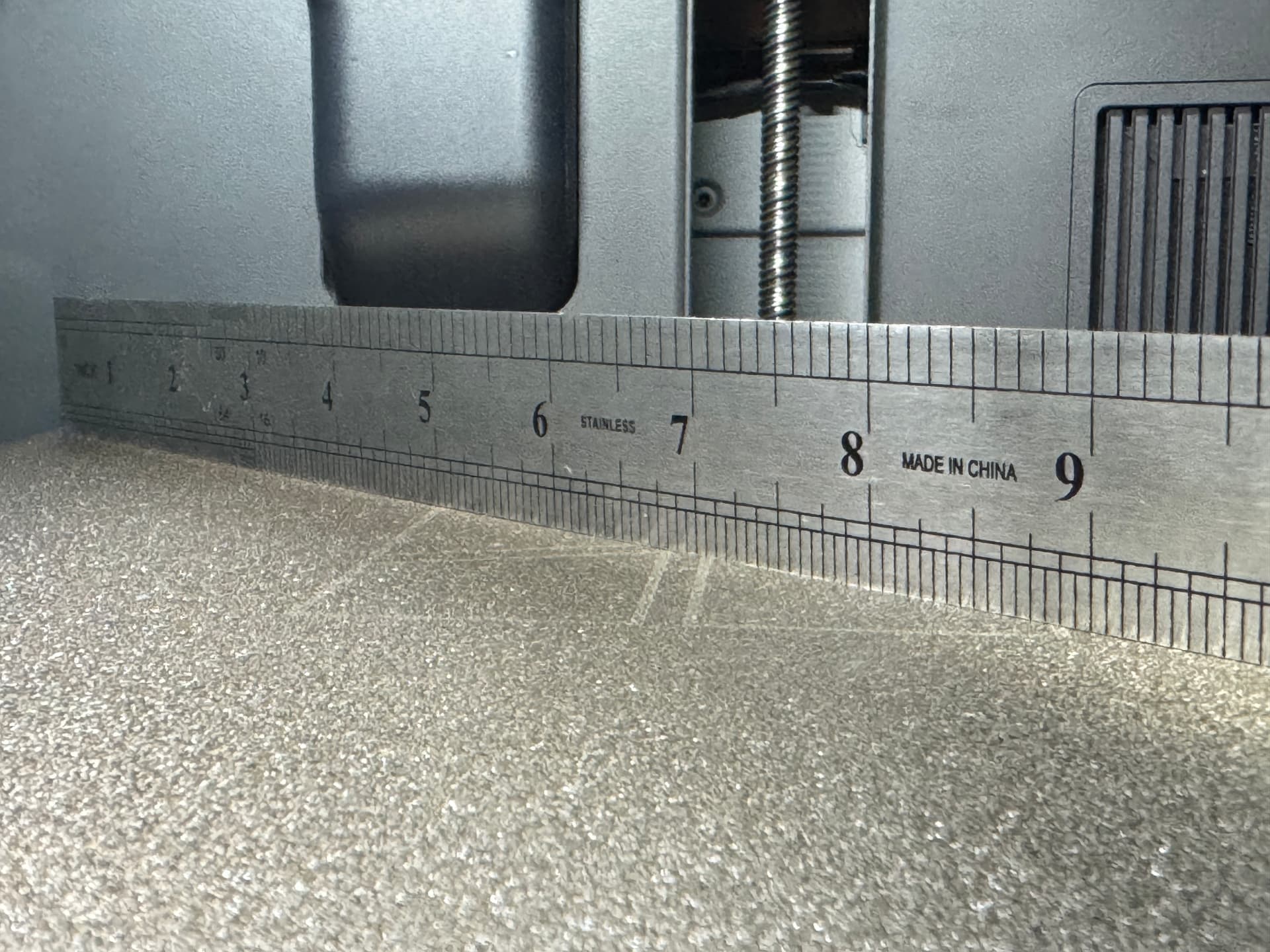

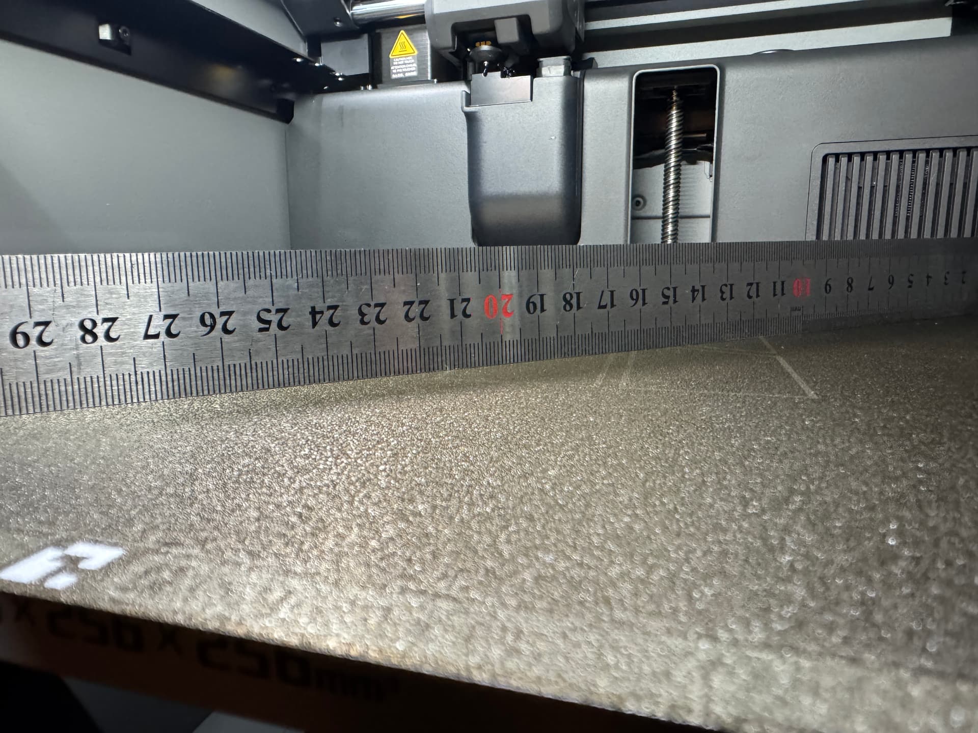

I checked my bed and it looks perfect pre heated to 60 degrees. No complaints here.
As far back as I can remember, Bambu beds have never been perfectly flat. My three X1Cs are concave in the center, and my H2D too. The only thing I’ve been able to do—on all my machines—is precise tramming of the build plates with a digital dial indicator mounted on the head, then fine-tune the distance at the four corners. The mesh handles the rest.
Totally agree with your statement, as a maintenance engineer I can’t even remember the amount of times i’ve said “What sort of IDIOT designer thought this was a good idea??” referring to trying to do a repair on a machine that you have to remove almost every part to get to the so called wearable part!! and also be double jointed in almost ever joint in your body just to get to it…!! As you said designed for cheap manufacture not repairing!! By contrast i’ve found both my P1S and A1 mini fairly straight forward to maintain and repair when required and the Bambu wiki has a vast amount of information on do these repairs yourself and please don’t forget that if you opened the back of your tv to replace a component you’ve instantly voided your warranty, but not with Bambu labs they encourage self repair and you keep you warranty too boot!! Lets be honest they are easy to repair one of the people that works in our factory bought an A1 mini to print bits for fishing and something went wrong with one of the boards in the extruder head (he doesn’t know one end of a screwdriver from another!) yet with support helping and me showing him the wiki he managed to swap out the faulty board!! Now that says something…!!
Checked mine too, was a bit convex (mid higher then edges). Ran the manual tramming as per wiki, seemed to do the job.

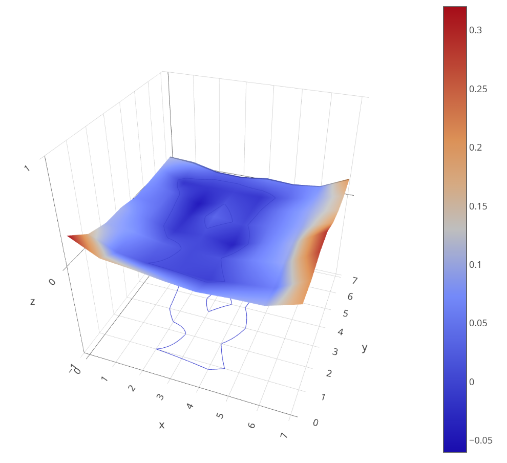

Oh it works for sure, some values go from +0.10 to -0.02, from 0.16 to 0.05 etc.
I did it this time with bed heat off (chamber temperature at 23°C), results below. I also added a partial video of the meshing process.
Would you be willing to create a post with methodology and tools/code used for others to replicate? I think this is something that may be extremely useful to the community, given that BL doesn’t want to expose the ABL data.
That’s a good idea, challenge accepted :slight_smile:
Wholeheartedly thank you. IMO tools like those are great for any advanced measurements or troubleshooting.
Done!
Seems to work fine for you! I’m getting slightly different readings, but I measure the heat bed itself rather than the plate — it should be almost the same though.
When I place my plate on it, everything looks perfectly flat, which is why I measured the bed directly.

I finally received the replacement heatbed but it’s even worse than the original one with a 1mm convex bulge on the backside. This is ridiculous.
I contacted Bambulab with the ticket to report the issue and they offered me four spools of PLA as a solution. This is ridiculous. Four spools of filament aren’t a solution for delivering a usable or defective machine.
I’ve requested a replacement heatbed, a replacement machine, or a refund. Let me be clear, I don’t want to cause any trouble. I just want a usable and acceptable machine. I’m even willing to pay more to upgrade to H2S/D if the machine is more mature.
