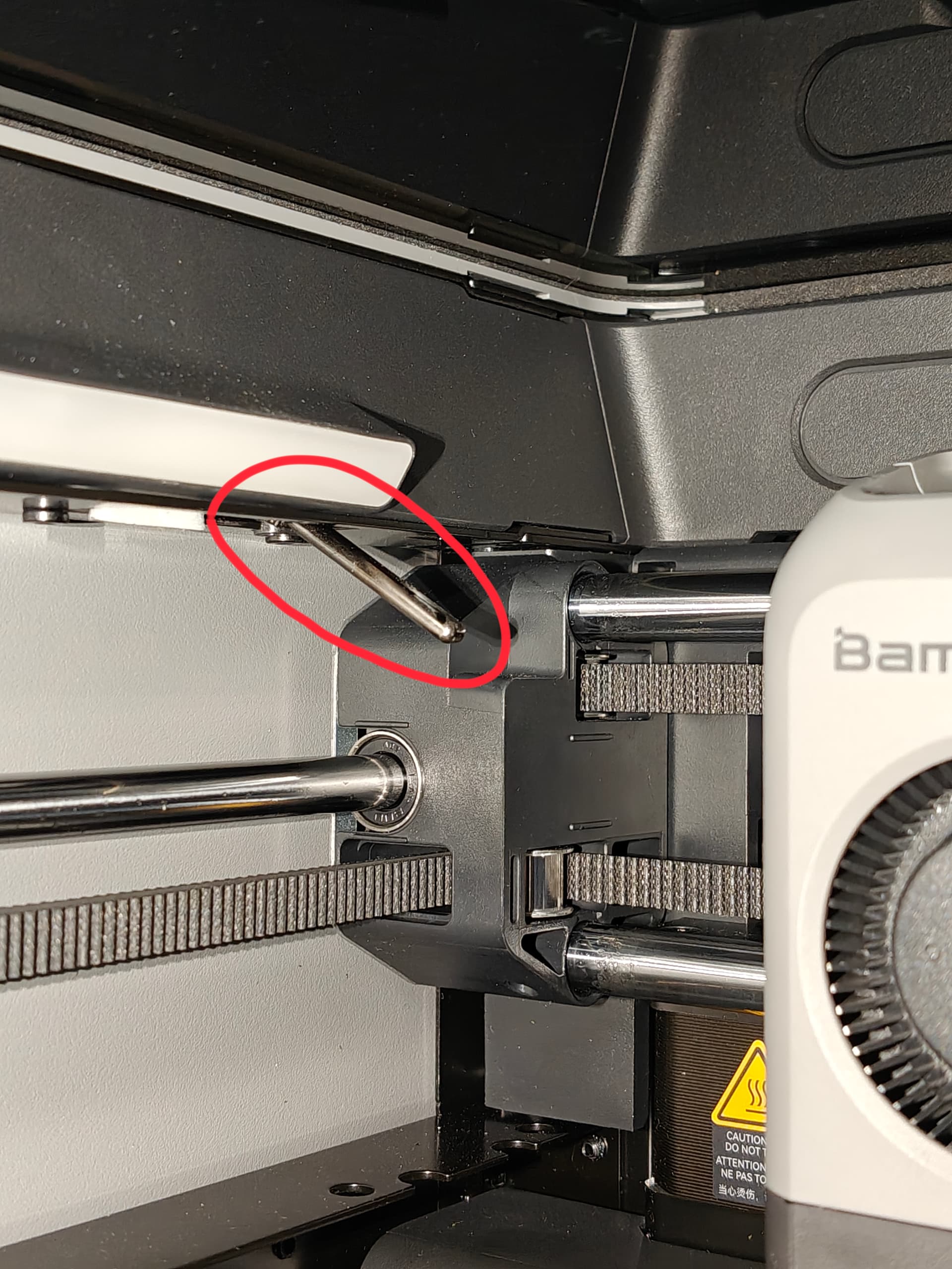

What does the lever under the left side light do, other then just click?
Bought a P2S a shorte while ago and wondered the same, but ended up realizing that it seems to be some mechanical device/safeguard that the printhead triggers when it leaves the print bed towards the realms in the back, since the clicking only happens when filament is purging and/or the nozzle is being cleaned, during calibration etc etc.

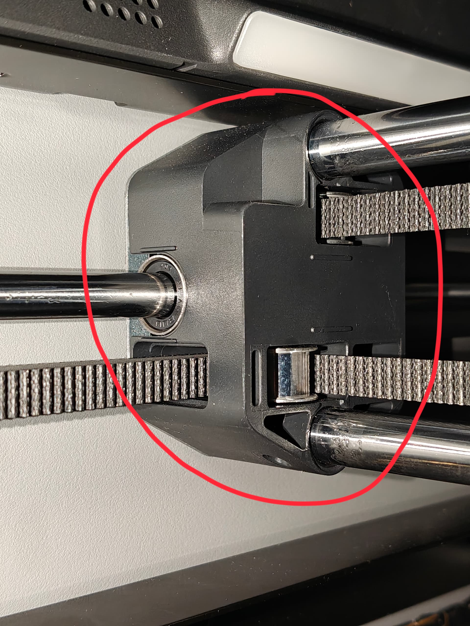

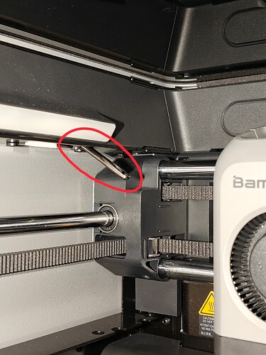

Behind the actual cutter is the mechanism that deploys it. The Grantry (the part where the printhead sits on) activates that mechanism when it moves to the back on the printer.
so every time the printers homes which it does multiple times before pritning, and while moving to the purge shoot etc. activates that mechanism that deploys the cutter (the clack sound you hear).
This part moves back

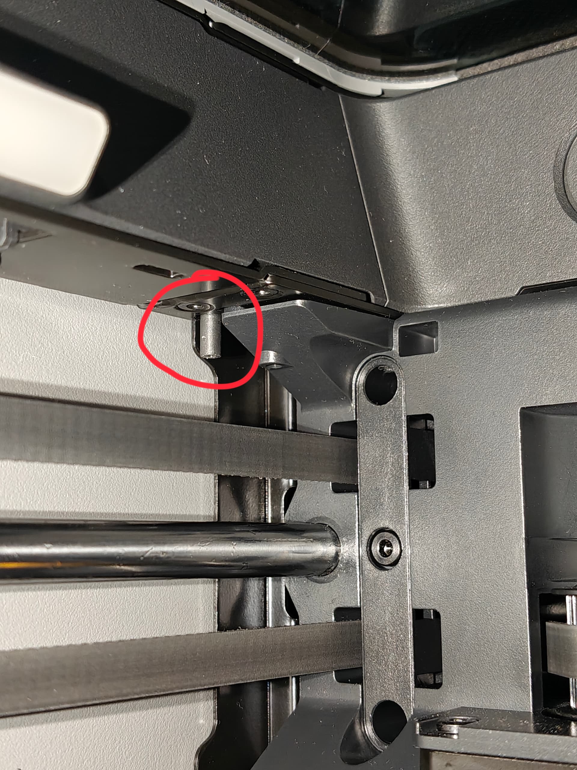

Hits this lever
Which is connected to the filament cutter and deploys it
I really wish bambu had put that lever somewhere else so it doesn’t get deployed all the time. It’s loud and annoying, especially when in the same room.
