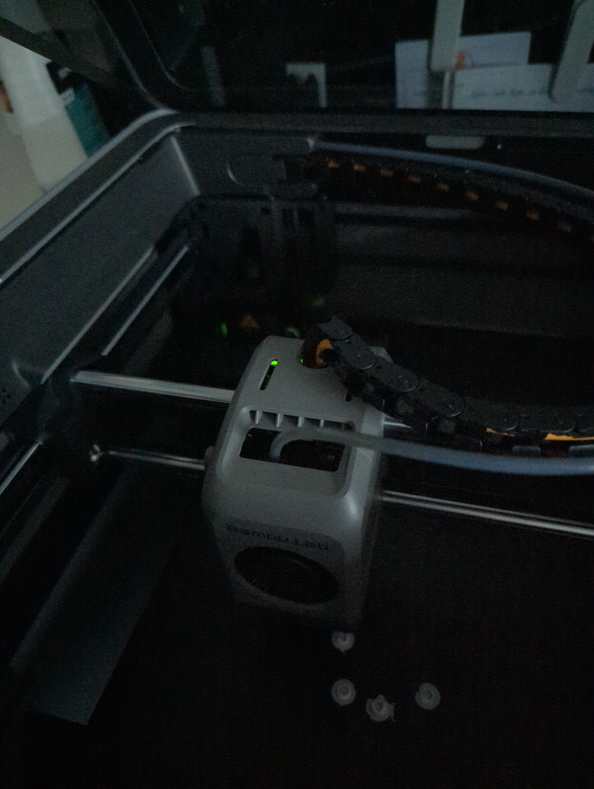

Hello, my P2S froze last week during a print. I already contacted support and they advised me to check all the LEDs. All the LEDs were green. My question is, where could the problem be? Can anyone help me?

Midway through printing, the screen went black and the printer light went out. There was no power outage in the room; I was working at the same time. Now I’ve turned it on, but the screen and light remain off. The AMS starts up and just makes a crackling sound.
Unplug the AMS and try again. To be precise:
  • Unplug everything, including the printer and the AMS. No longer plugged into the power outlet.
  • Wait 5 minutes.
  • Plug in only the printer and try again. Do not plug in the AMS.
Then please give feedback again. :+1:
I’ll try it as soon as I get home. Thank you so much for your advice.
So I turned it on without AMS. Display and light remains black.

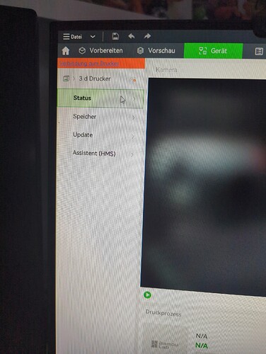

He has no connection via PC either.There is no connection there. He shows that. how gone.

Thanks for your tips. I’ve already read Wiki. and made all the tips Thanks for your tips. I’ve already read Wiki. And all the tips made on wiki. I suspect the display is broken. The motherboards according to the wiki they are all fine.
